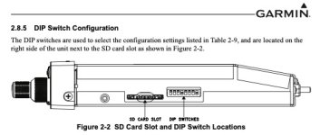

I discovered that my intercom was not working at all. Blissfully unaware of my issue during phase 1 testing of my -6A because I had no passengers.
Tried to trouble shoot, and adjust knobs of my Garmin 345 intercom and my Garmin 255A, as well as my secondary Dynon radio.
Removed my panel (thanks to the clever design -Carl Froelick), examined the pin connectors and all connections.
It was then that I noticed the side of the intercom had dinky switches (DIP) and labeled 1-5 on the top.
From the install manual:
Note that two buttons (AUX1 and AUX 2) are used to select/deselect the 3 AUX inputs. Pressing the AUX 1 button selects/deselects the AUX 1 and AUX 3 receivers. Pressing the AUX2 button selects/deselects the AUX 2 receiver.
**Note that one button (AUX) is used to select/deselect all 3 AUX inputs. When AUX is selected, audio from all three AUX inputs is merged and heard together.
2.8.5 DIP Switch Configuration
The DIP switches are used to select the configuration settings listed in Table 2-9, and are located on the right side of the unit
Confession:
I had no idea that I was to properly set these during install.
Duh.
Once set properly, all well.
In summary, don't do what I do, do what I re-do.
Confession:
Duh.
Daddyman
