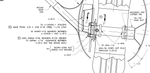

I have experienced an annoying loud groaning when I applied my left brake. The brake functions normally, and stops straight. But the noise was bothering me (and perhaps others).
I examined it closely, and could not see anything that would cause the mystery noise.
Yesterday, I couldn't stand it any longer, so I jacked up the plane and lo and behold- I was what was the likely culprit.
The spacers I created out of soft aluminum tubing had become deformed under excessive torque to the 3- backing plate bolts.
The lowers of the backing bolts had cracked the backing plate bolt hole off (P/N 810-L) around the bolt. It was not visible until I removed it because the bolt still captured the broken ear.
With only 2 bolts to hold the wheel support flange was able to vibrate and hence the noise.
I make a temporary repair and ordered a replacement part from Van's which is on the way.
Test taxi and flight confirmed the noise-maker cause.
