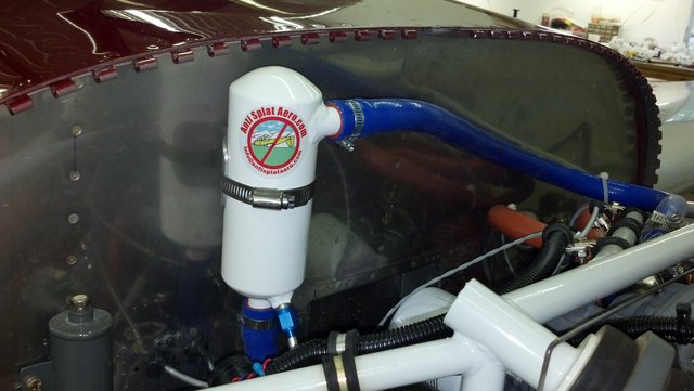

Hey - plugging away on the FWF and I am shifting gears to mounting and connecting the Anti-Splat Air/Oil Separator. Anti-Splat recommends mounting the unit high on the firewall on the co-pilot side. This looks like it will fit well, as there isn't a lot of equipment to interfere with in this area.
Does anyone have pictures of what tubing / hoses you used to get from the engine breather fitting over to the Anti-Splat separator?

Breather hose routing is the same for any separator can. From breather port to can, always run uphill the whole way. Insulating the breather line by running it inside ordinary fuzzy-lined firesleeve is a good thing, as you want the breather gas to remain as hot as possible.

Here is how I mounted it for an RV-10. The breather hose came from Anti-Spat as well. It makes a soft 180 degree bend to the engine breather connection. On this install I made an adapter to transition from the engine breather fitting to the hose (the hose was just a little smaller).
Note - I recommend never returning the oil from the separator back to the engine. I collect this oil in an old Brasso can attached to the engine mount. I empty the can every oil change - never had more than 2 or 3 ounces in the can.
