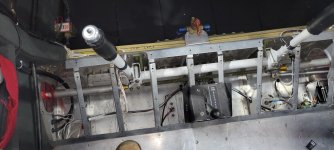

I've got things opened up for annual and am looking at what is limiting the elevator travel. Will inspect ailerons next.
I don't know why this additional bar is bolted on here -- see picture from the top and bottom. From the bottom you can see the original aluminum angle which doesn't look like it was cut away or anything. Any ideas why this additional piece is bolted on other than to limit elevator travel?
That part is clearly not part of the design... it is likely to compensate for something else that is not right.

As Alex already mentioned, this bolted (cut-off washers?) flat piece is not "original". It was maybe added by someone feeling the need to reduce elevator travel... the builder would be a good source of knowledge, if not, I'd proceed as others have said.
I seem to recall a case where the horizontal stabilizer was attached somewhat forward of its intended position.
Paul, is there a down elevator stop installed? Can't quite tell from the photos.
I do not see a down stop for the elevator. I'll have to pull the floor panels again and look for the bind point you have shown.
