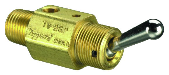

Next on the list is alternate static. There's now a switch above the right Garmin display.
I assume this may not be the final configuration as right now the labelling doesn't even indicate which position is on or off.

When I decided to make my Kitfox IV IFR I added an alternate static source. Used the same "switch". It looks like an electrical switch but is actually a valve that opens to the cabin when turned "on". I get a change in airspeed and altitude at cruise but at pattern/approach speeds, the change is just a knot or two and less than 10 feet in altitude. Would be easy to add to an existing RV12 although the static line would have to be routed to the switch location from the AHARS.
