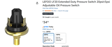

I've been having a problem with a carbureted Rotax engine with a drop in fuel pressure on takeoff. I've spoken to everybody I could think of but no answer. Instead, I have wired in a pressure switch to the electric fuel pump so it automatically goes on when the pressure drops (carbs =1.8 psi, FI= 22psi). the switch is plumbed into the fuel line to the pressure sensor and electrically after the fuel pump switch. The fuel pressure switch is easily calibrated to the pressure I want. I liked it so much, I installed it on my IO-360 on my RV-8.
Like others, I turn on the pump to prime and then off for starting. Back on before takeoff and off when I leave the runway and lean for taxi. I used to also turn the pump on when I changed tanks but now I just keep my hand on the valve until I'm comfortable the fuel is flowing. It is very cheap, eliminates me needing to recognize there is a problem in a critical phase of flight at low altitudes and high angle of attack and I have a warning light that comes on when the boost pump is on.
