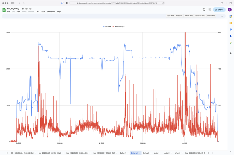

I recently "derailed" this thread with my report of extreme vibration issues with the Garmin GSU 25 mounted remotely, aft of the baggage compartment. My device was attached via four bolts/nutplates to Van's AHRS mount, which consists of a pretty thin sheet of aluminum riveted to the exterior skin and the center brace between the bulkheads.
The symptom: AHRS display malfunction (incorrect ~20 degree roll depicted) at high RPM, with CAS messages indicating ATT MISCOMP and AHRS REVERT. Upon analysis, AHRS Dev (%) as logged by the G3X was spiking up to 700% during these episodes. Analysis across multiple flights indicated AHRS Dev (%) correlated most strongly with Eng. Pwr and RPM. Pretty likely vibration related.

Well, three flights later results are so far so good! After 6 full-power takeoffs and 7 full-power climbs from 2500MSL to 5500 (tested every 5kt between between 65 and 95), I did not record any AHRS failures or CAS messages. Great. So let's analyze the logs.
Here, you can see plots of RPM (blue) vs AHRS Dev (red) before the new mount:
Observe the large spikes > 400 whenever full power was applied. These corresponded to the AHRS failures and CAS messages.
