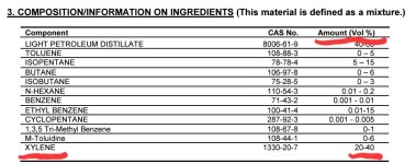

there are xylenes and toluene in 100LLIs Xylene likely to cause damage to O-rings and/or Proseal?
What's enough to cause staining? By significantly increasing the concentrations of these chemicals over whats in 100LL, what will the effect be on paint?there are xylenes and toluene in 100LL
Look at the Phillips 66 MSDS for 100LL, section 3

I'm less concerned about its effect on paint than I am on the fuel system, but your concerns are valid. Xylene is used as adhesive remover and I'm not sure what else. A jump from 15% to 40% Xylene from 100LL to G100UL is concerning to me, although I do trust that GAMI has tested extensively. Are some varieties of ProSeal susceptible to damage by higher Xylene concentration? Viton? Buna-N? Silicones?What's enough to cause staining? By significantly increasing the concentrations of these chemicals over whats in 100LL, what will the effect be on paint?
I believe that the staining is caused by the aromatic amine in the formula. Amines are not typically found in fuels. They are reactive and likely more aggressive than typical fuel components.What's enough to cause staining? By significantly increasing the concentrations of these chemicals over whats in 100LL, what will the effect be on paint?
GAMI's explanation on the staining cause, and how to prevent it:I believe that the staining is caused by the aromatic amine in the formula. Amines are not typically found in fuels. They are reactive and likely more aggressive than typical fuel components.
I just read the explanation. They didn’t specify what component is the cause but I suspect that it is the meta toluidine (aromatic amine). Amines are generally not found in fuels.GAMI's explanation on the staining cause, and how to prevent it:

Weird to the eye sort on the MSDS, NOT ranked by %. 20-40% Xylene.
