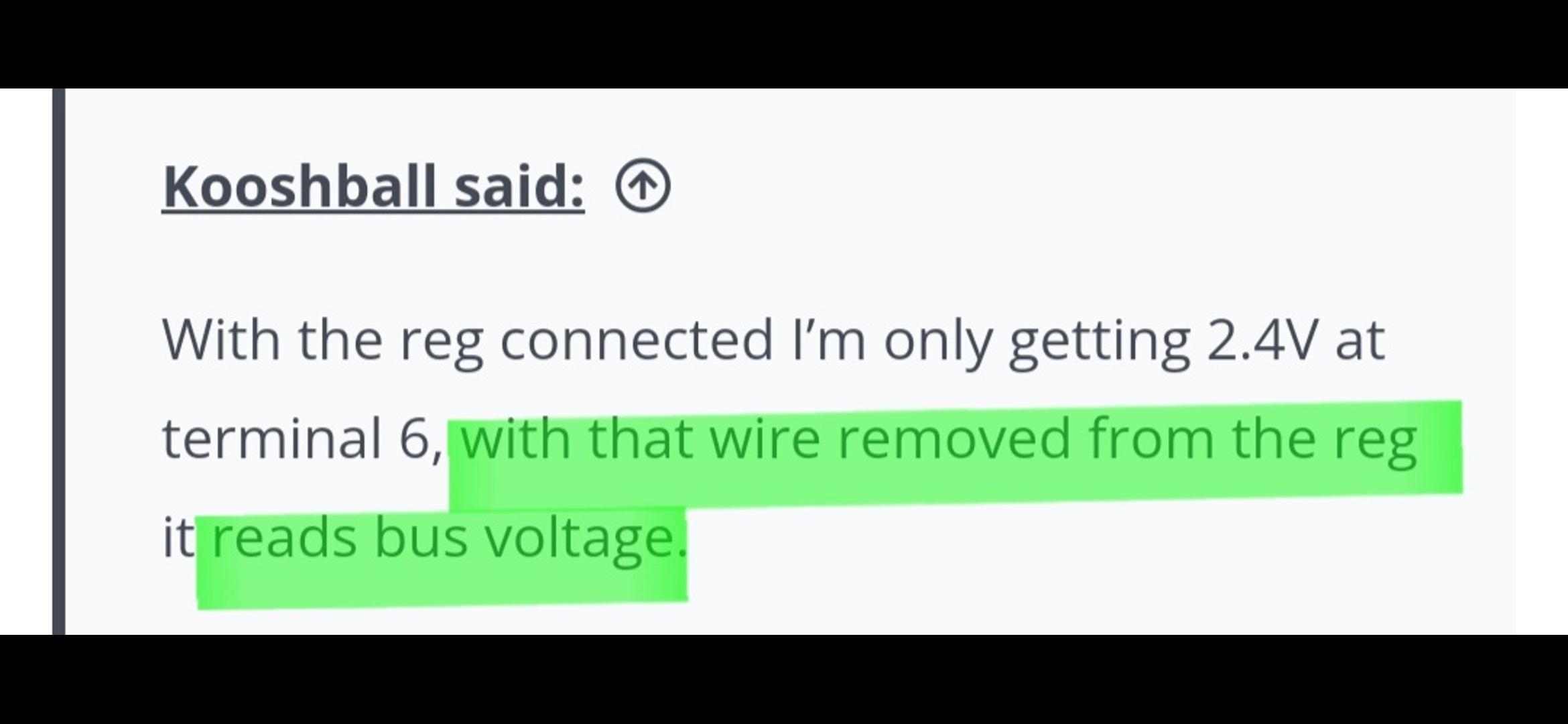

Thanks folks! With the reg connected I’m only getting 2.4V at terminal 6, with that wire removed from the reg it reads bus voltage. This is something new that showed up after I installed the new regulator and also manifests itself with the loaner regulator that B&C sent me so two regulators are behaving the same way.
That tells me that either the master switch is bad or the circuit breaker is bad.
A bad circuit breaker is more likely. Why not just do the voltage test that I suggested in post #6
above and then you will know for sure. Whichever closed switch that has voltage across it is the bad one.

Right, and the OP does not have 12 volts, only 2.4 volts. Now all he has to do is figure out where 10 volts is being dropped, either across the circuit breaker or master switch or some other bad connection. Thanks for drawing a picture of how to connect the voltmeter. Pictures are worth a thousand words. I suspect the meter will show 10 volts, thus indicating that the problem is one of those switches or terminals.

He has found the bad voltage signal at the input to the VR at terminal 6, the voltage is 12 volts right where it needs to be at the wire providing power to 6… but for some reason when the wire is connected to the terminal 6 the voltage is 2 volts on that terminal…. so either the signal is weak like Joe says it is maybe bad connection in switch and as soon as it connects it says WHOOOAA and quits, or something forward of terminal 6 is being greedy and draining it. Unless 2 volts is correct at that point… because I dont know that voltage regulator or how it works and what it does to that 12 volt input signal once it gets to term 6. But what I do know is how that Denso alternator that B and C uses works, bypassing the regulator by providing a known good 12 volts to wire 4 by disconnecting wires 6 and 4 from the regulator and connecting them together and full fielding the alternator will tell you if the regulator is the problem…. so this is just too easy of a problem to solve without even using a multimeter..

Alright folks, here is what I have:
Both the master and alternator switches check out good per the instructions here, when closed there is essentially zero V showing on my DMM.
Bus voltage is: 12.13
Voltage on terminal 3 of the VR is: 12.05V which is less than 0.2v difference so according to B&C is good
Voltage on terminal 6 is: 2.1V
I have a new field switch that I temporarily wired (with completely different wires) from the bus to terminal 6 and I get the same 2V.
When I remove the wire from terminal 4 which is the output to the alternator, I still only see 2.1V on terminal 6. So even with the alternator out of the circuit I only get 2.1V.
All of this points to the voltage regulator, but the strange thing is that I still have the loaner voltage regulator from B&C that they send out as a “known good regulator” and it also shows 2.1V at terminal 6. What are the chances that both of these voltage regulators are bad in the exact same way?
Update. It was Bad wiring between the master and the VR. I ran a fresh one and everything checks out good so now I’m making it permanent clean and safe.
