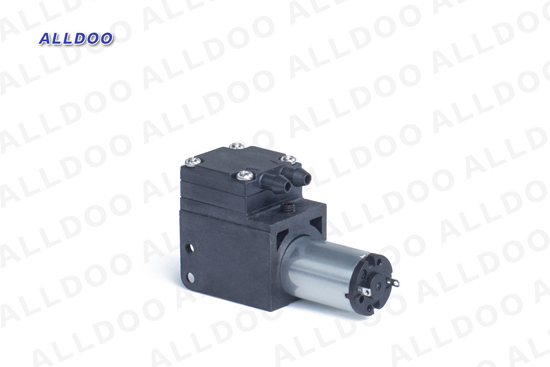

maybe something like this
small 2x2 inch (ok, maybe 2x3 inch, but no more than .25 lb) air pump box with RH sensors and connections. it could monitor the case RH and ambient air RH and decide if it's wise to purge. the lower connections could also attach to an external drying agent source if desired. call it a "smart engine dryer". out of sight and out of mind... but always working to keep your engine healthy. could a device such as this eventually become standard equipment, maybe.
perhaps it could be used for turbine engines as well. hey, water in your engine is bad.
maybe a cheap pump or something better. probably there is something better than this but you get the idea. size is 1 x 2 inch.
it could easily get this stuff out and probably achieve 80% of the benefit of water entrapment elimination without any silicone media if it was smart.
need an electronics wiz to design and build it. I'll fund it and test it. let me know.

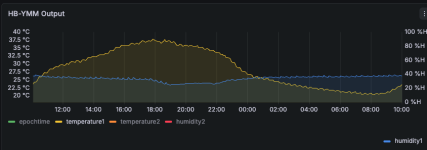

The question not answered yet is whether there is any liquid in the crankcase that might evaporate and recharge the crankcase air. In spite of a handful of tests, the humidity meter readings are not consistent - - meaning I can not make sense of them.
