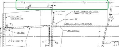

I made a wood tool to go between the F-303 front and back bulkheads. Unfortunately I picked a windy day and more unfortunately, left the garage door open. I ran the table saw and planer in the driveway and a lot of wood shavings went into the shop. I spent the rest of the afternoon vacuuming the shop.
The F-303H shear blocks get bolted and riveted to the spar web. The bolts go in after the wings are on the fuselage but are needed to locate the rivet holes, which for some reason aren't pre-drilled at the factory. These bolts go through the F-303 bulkhead, the spar web and the F-303H blocks. They fit nicely in the blocks but not at all in the spar web. The holes are slightly too small.
I checked the same holes in the F-303 side pieces and some of the holes let the bolts in but most of them didn't. The manual emphasizes that we shouldn't drill out any of the spar mounting bolts and these clearly don't fit. I looked at them with a 10 power glass and these holes, in the side pieces, are punched, not drilled like the main spar bolt holes - and yet these too need good alignment.
Back to the plans. On drawing 6, the plans just describe the hardware. But on page 11, there's a note to match drill the side pieces to the spar. Imagine that.

The plans, on Drawing 22, are just a bit vague as to where to bend the F-305 seat bulkhead. Here's one side of the bulkhead after I bent it.
You can see where I made the bend; some other builders placed the bend where I did. The red dashed line shows where yet other builders have made that bend.
The plans show that the bend is to be 4 inches above the bottom of the bulkhead. In the picture, there are two clear points that the distance can be measured from, shown by the black line and the blue one on the right. I believe that the black one is what is intended but I'm not certain. 4 inches from either places the bend in between where I bent it and the dashed red line. If I used the black line as the measuring point, the bend would be immediately below the recess for the longeron. If I placed it 4 inches from the blue line, it would be in that recess.
Here is an excerpt of the drawing. If the position of the bulkhead at the upper longer is held fixed, then top of the turtledeck would be slightly forward of the design position unless it, too, were bent. I've shown the bulkhead position using my bend, with the green line.
If the bulkhead were bent in the higher position shown by the dashed line in the first photo, the bulkhead would lie on the red line shown below.
These are small potatoes, all in all, and perhaps they're mere quibbles. I'll check the differences and see if I need to adjust the position of the bulkhead on the upper longeron - that's where I am today:
The longeron-bending tool I borrowed is shown to the right of the bulkhead where I"m using it to adjust the shim at its clamp (you can barely see it - it's the aluminum part with the #40 pilot hole in it at the jig) so that the longeron sets at the correct angle. The bending tool makes this trivial.
Note one of the "Left" labels on the jig; I really don't want to get confused.
Incidentally, the F-305 seat bulkhead bottom halves get riveted together. Haven't done that yet, and the clecos were in my way, so I connected them together with a structural bond.
