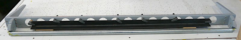

I've been making ailerons. And here's a couple of tips:
1. Drill and rivet the counterbalance to the nose ribs BEFORE riveting the nose ribs to the spar.
2. Drill and dimple and rivet the stiffeners to the skin BEFORE tightening up the trailing edge bend.

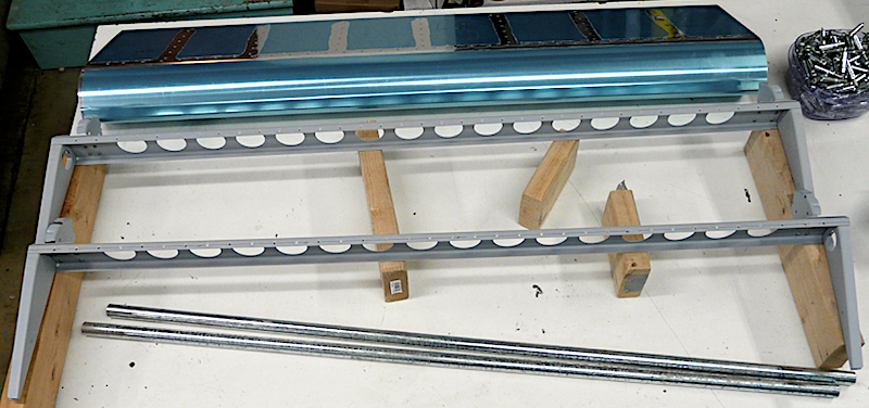

Here are the frames - the spar and ribs riveted, with the counterbalances trimmed but not drilled, not riveted or for that matter, not even primed.

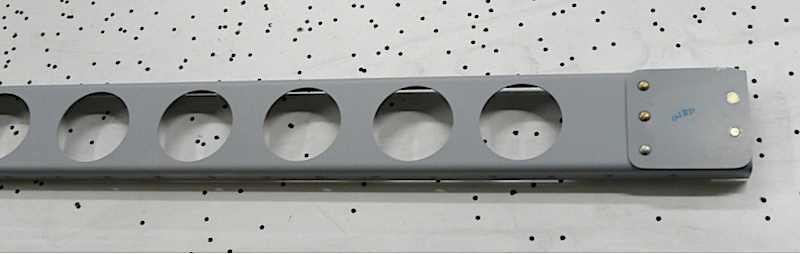

The observant reader will notice that I haven't drilled the holes on the bottom of the spar yet.
The lightening holes in the spar were drilled using a hole saw from which I'd removed the pilot drill, replacing it with a round bar. This went into pilot holes previously drilled in the spar web and into a backup wood block that had a lubricated pilot hole and was clamped to the table. That gave me nice clean holes.
Dave

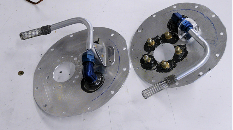

I've ordered shorter screws than the AN509-8R8 that Van's supplied for the tanks. The AN509-8R8 are too long and that
a) Wears out the nutplates faster than necessary,
b) Sticks into the wing too far, snagging cables and things,
c) Weighs more than necessary.
I ordered MS24694S3.

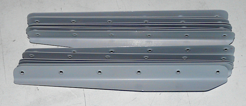

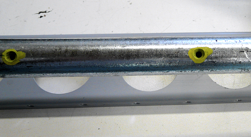

The aileron counterbalance pipes are primed. I sprayed a bunch of zinc chromate into them and verified that I got full coverage. I riveted them to the nose ribs using AN470AD4-6 solid rivets. The photo will show how I obtained clearance. There simply wasn't room to get a blind rivet tool in there. Refer to point #1 in the post above. I was able to use my squeezer with a 3/8" diameter set. This set is too small diameter for routine work but was perfect for this.
As you can see, I've got to touch up the ends of the pipe a bit with a drop more zinc chromate.
I primed the stiffeners and have cleaned the aileron skin but not primed them yet.
Dave

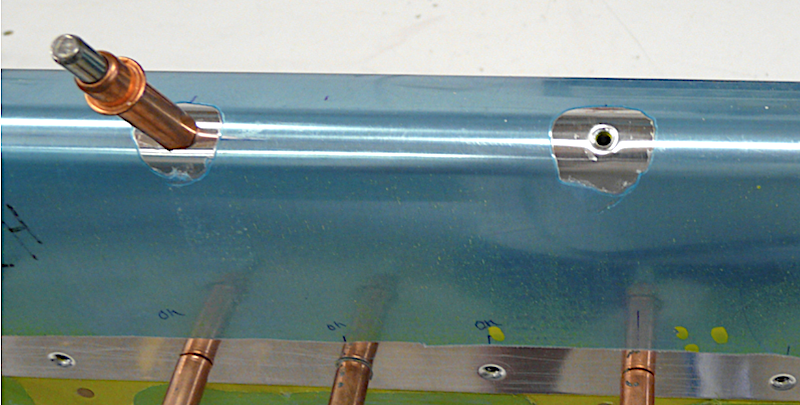

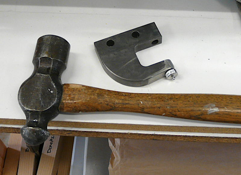

Aileron Leading Edges Dimpled
This wasn't hard. First I countersunk and primed the holes in the leading edge pipes.
Then I put a male dimple die on one of my yokes and got my trusty 2 lb. ball peen hammer out. Sure looks like I'm prepared to bash the heck out of it doesn't it? But actually using a heavy hammer makes the job easy, since the speed of the impact can be low and still generate sufficient kinetic energy to develop the required strain energy to form the dimple.
And here's a sample of the final dimples. All done with that now.
The ailerons are all dimpled but I still need to trim the leading edges at the inboard and outboard ends.
Dave

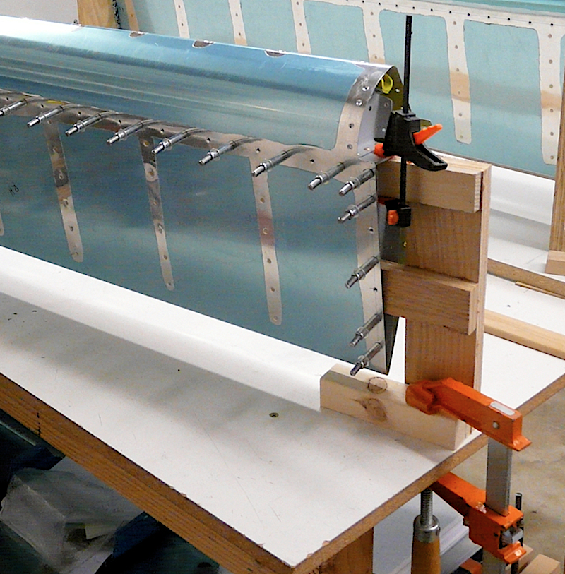

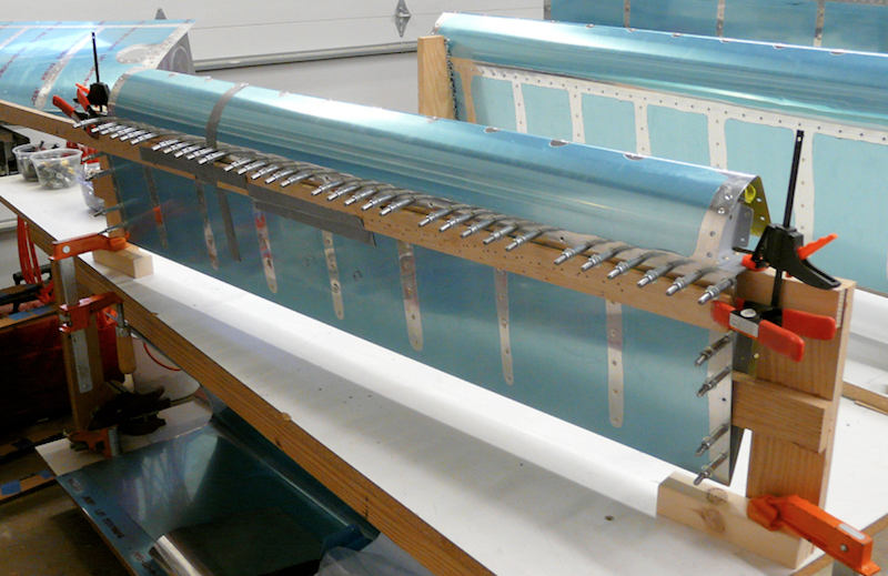

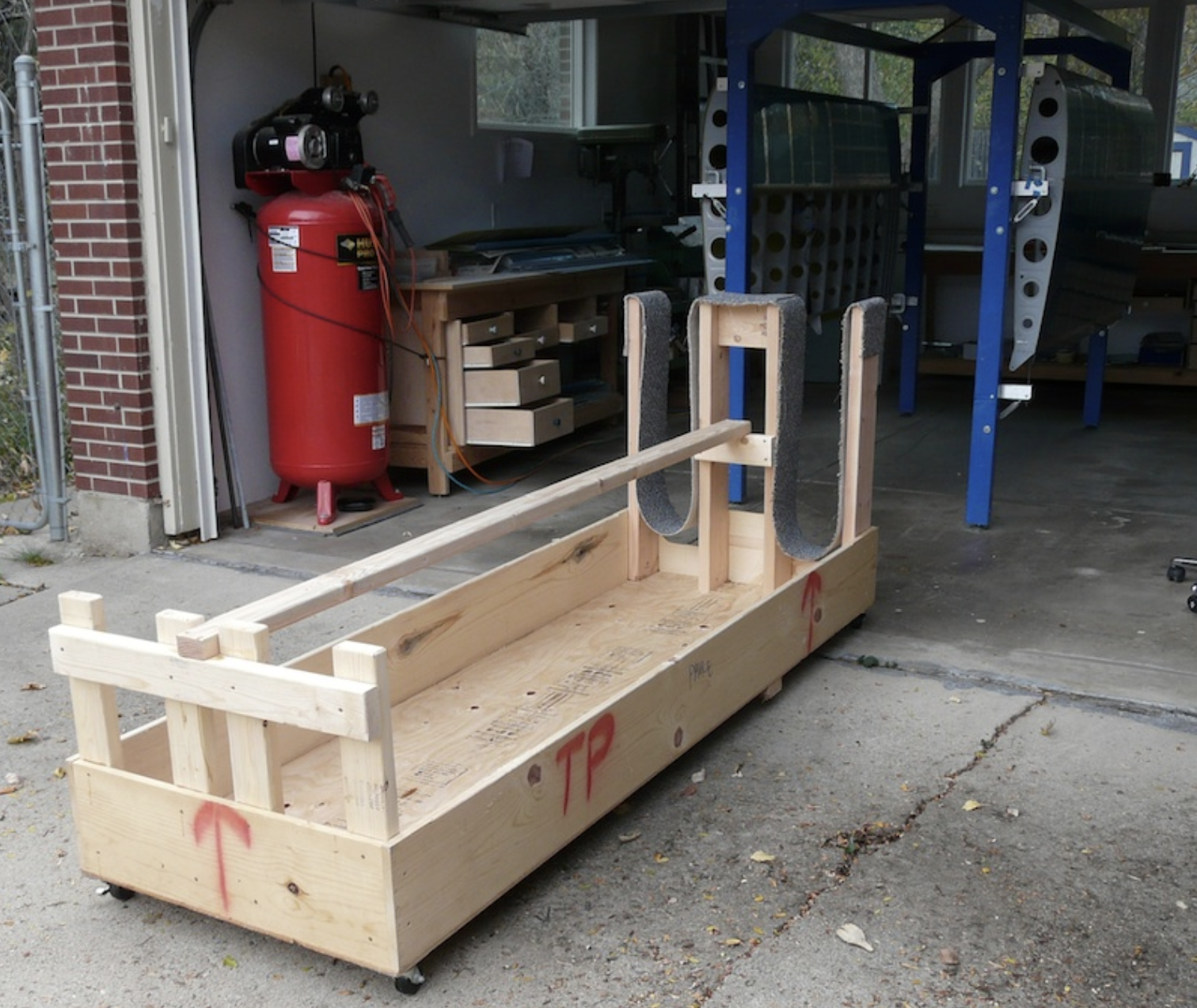

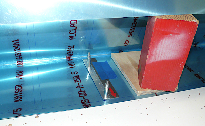

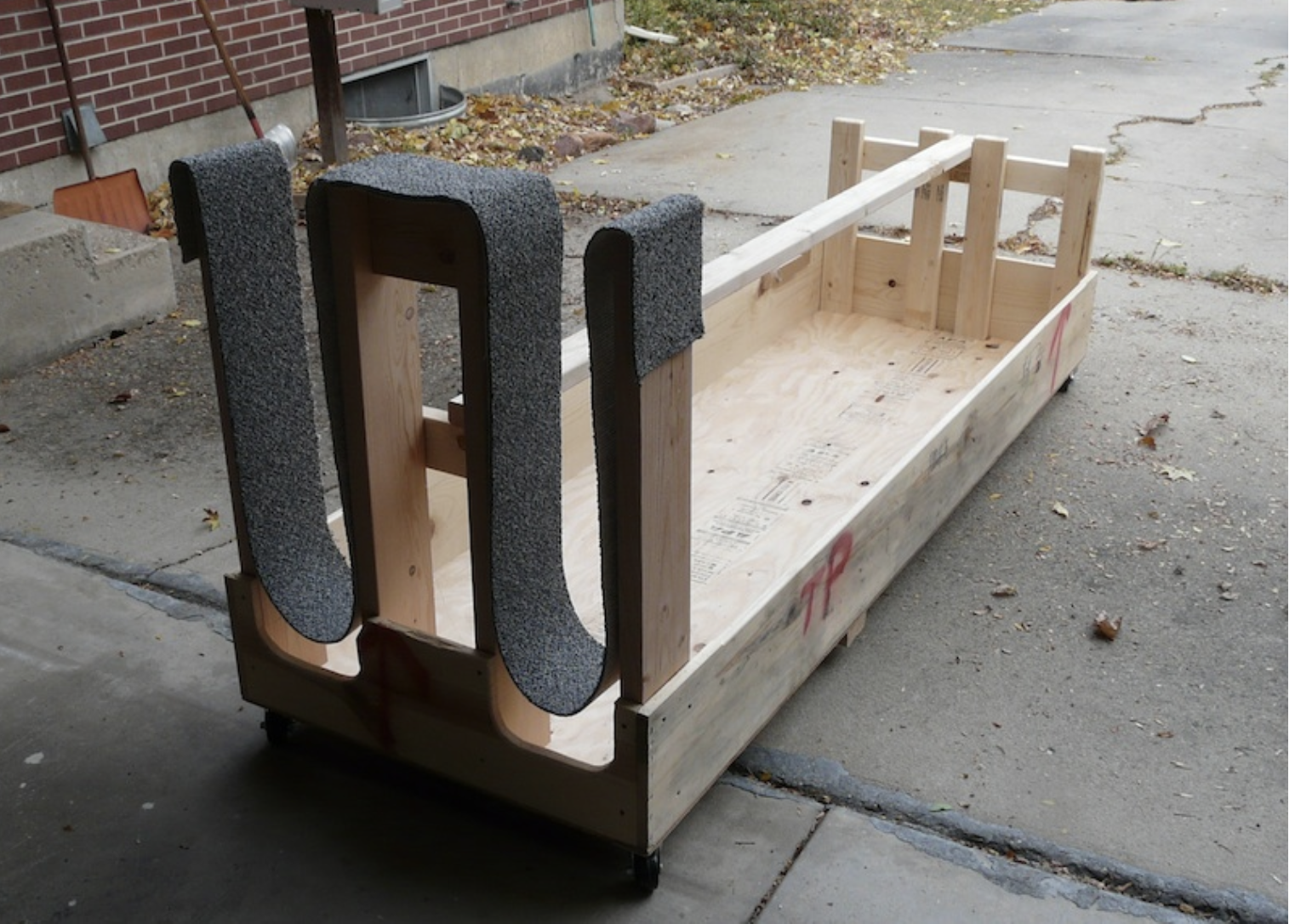

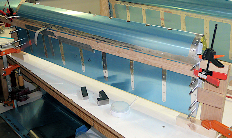

Top Aileron Spar Flanges Riveted
I made a pair of stands to support the aileron. The bottom block prevents the aileron from flopping over, since it's top-heavy. I tried to use the bending brake as a stand as Larry had described in Kitplanes but was unsuccessful with mine, hence these stands.
I added the horizontal wooden batten for a rivet set rest and that helped a lot.
An "L" shaped bucking bar proved the most practical, but in a few places near the flanges the tungsten bar could be made to work.
These rivets on the top flange of the spars, are now complete.
I'm using an under-cabinet light as a shop light. It fit into the aileron and made it easy to see the rivets with an inspection mirror. I checked nearly every one.
Dave

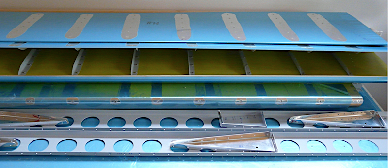

Ailerons Riveted
I had to add some shims to the forward ribs on the top flanges, which was annoying, but still finished riveting the ailerons.
The flap stiffeners are trimmed but not finished.

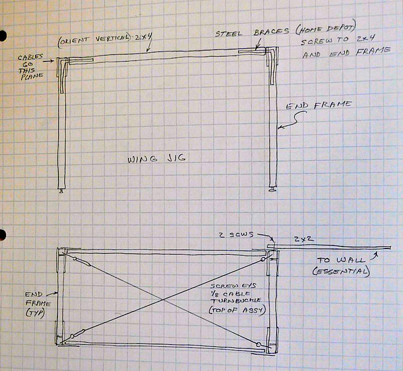

I've started the airfoil jig to locate the aileron hinge parts to the wing. Since this airplane is not pre-punched, everything needs to be located in space. The jig fits over the wing and has location features associated with it. Hinge location dimensions are with the aileron drawing, the jig is shown in SK-30.
If you're building one of the more advanced kits, the SK drawings are more sketch-like, more informal, than the bigger ones. They're in the manual, not the plans set. They usually describe things like skin dimensions or jig arrangements and given the paucity of information in the plans, are essential parts of the process.
Sorry, no photos at this time.

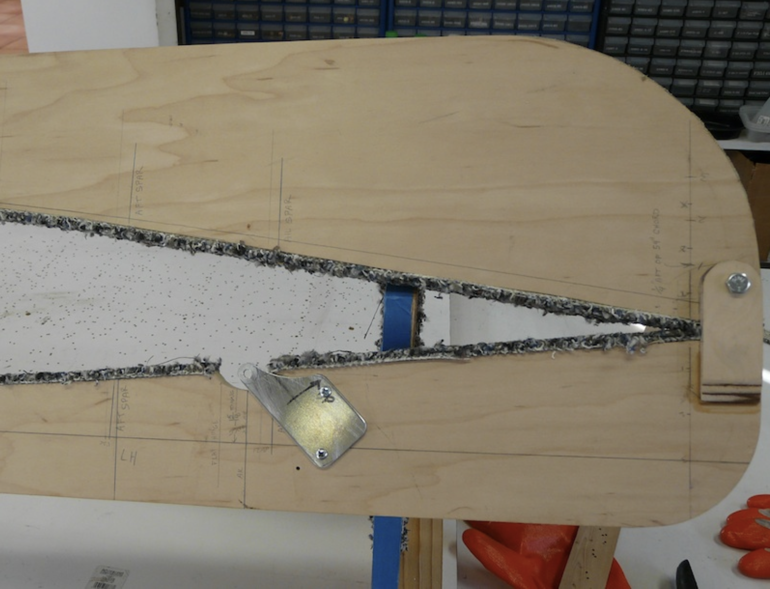

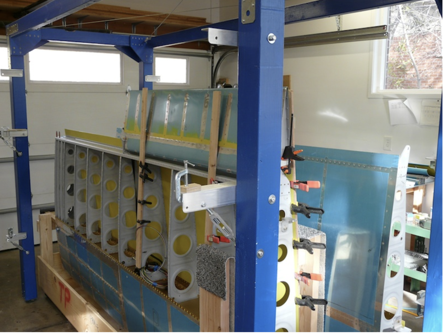

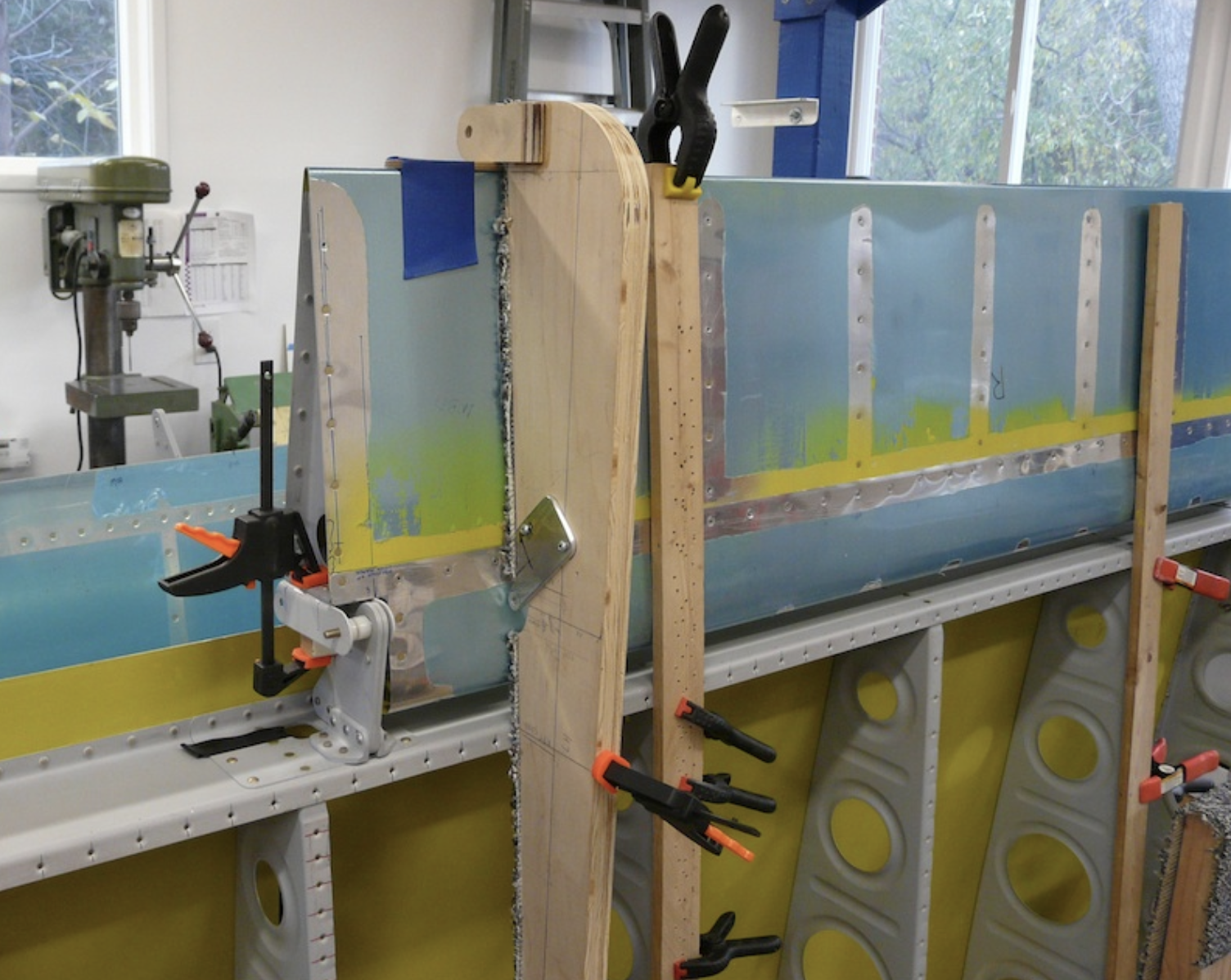

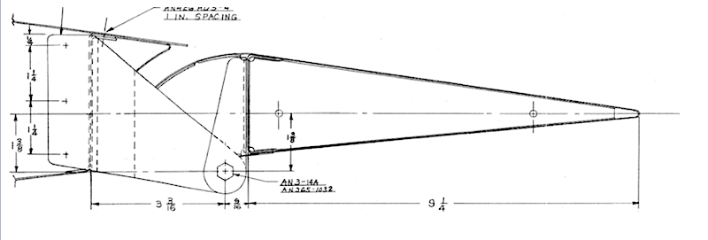

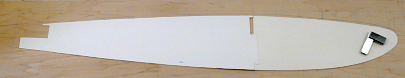

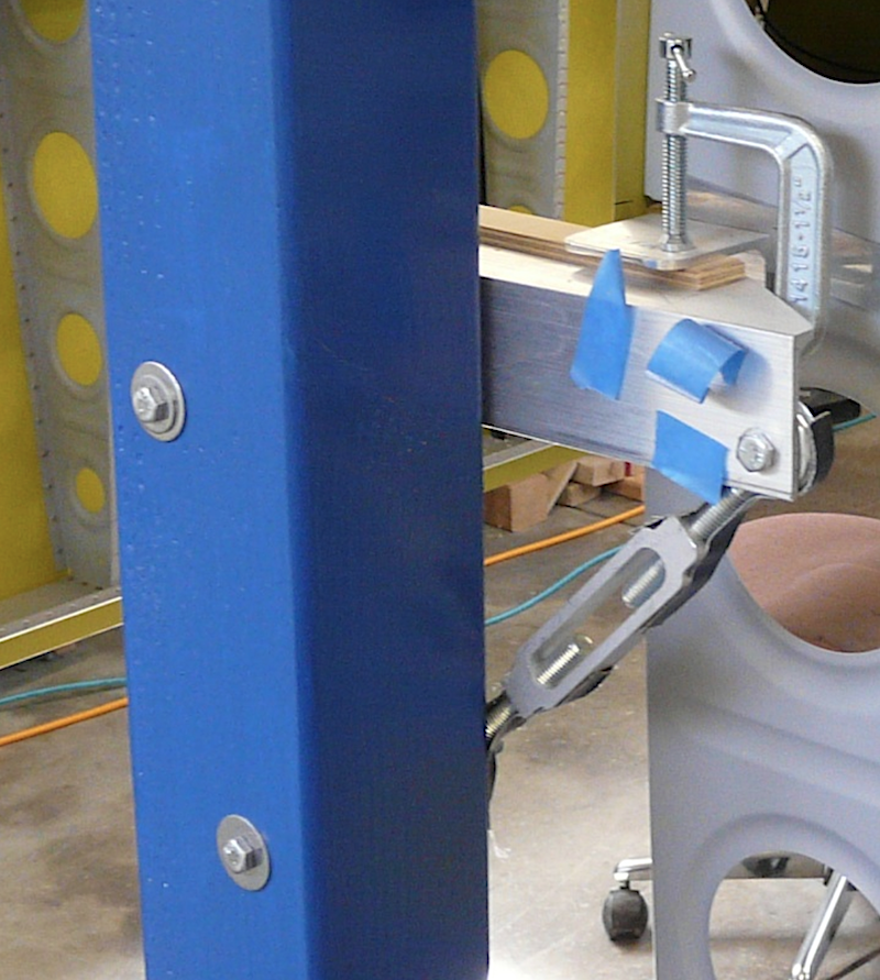

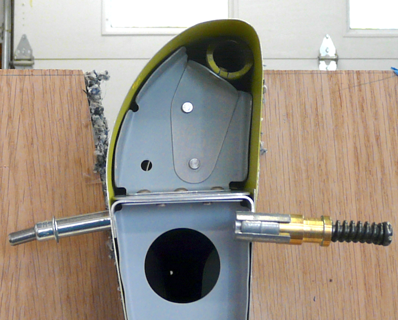

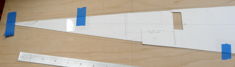

Figured that this would be a good time to see how well the ailerons fit the wing. It's a good time because I haven't started the flaps yet, except for roughing out the stiffeners, and some builders have reported that the flap trailing edge extends aft of where the aileron trailing edge would like to be, without some massaging to make them line up.
I plotted out the dimensions from Dwg 4 on a slab of nice plywood to make the wing template cut-out. The manual says that a paper template is provided, and if it's not, then the outline is drawn on the lid of the wing kit. Of course, neither were supplied with the kit. I got to use a spline and ducks, or I would have if I'd had any ducks. But I didn't. Ducks, in case you didn't know, are real tools. Well, yeah, they're also birds. Here's an article about making your own. Me, I just spotted some weights around and they did the trick. I drew the actual airfoil curve and an outline 1/4 inch fatter than that all around, to allow for carpet.
Since this is an RV-3B and the builder MUST be suspicious, I went and bought a piece of posterboard and made an outline of the actual wing. I used the left tip and cross-checked it to the right tip. Here are the nose and main sections of the posterboard template. If you look closely you can see that they don't match the drawn lines at all.
Also they don't have centerlines.
I used the tooling holes in the wing ribs to determine the centerline positions. Should have done this before I assembled the wing!
Once I got things lined up and checked it didn't look all that bad.
Here's a picture from the plans showing how the fit is supposed to be. The aileron spar should be 3.75 inches aft of the wing's rear spar, and the aileron, trailing edge to spar, should be 9.25 inches - and that's okay.
I drew out a template on the posterboard for the aileron and it matches the actual ailerons nicely. Unfortunately there's an issue: The wing skins are too far apart for the aileron to fair properly. Look closely at this picture:
The aileron spar is located the proper distance aft of the wing's rear spar. The aileron and wing centerlines are lined up. The aileron trailing edge is .40 inches aft of where it should be, but that's not a serious issue. Look at the top skin (The wing section is shown upside down so it's on the bottom) and the bottom skin (shown on top). They sure don't line up with the aileron, do they?
There's the problem.
Dave
Dave,
I'm not sure if this might help you, recently I read something in the "27 vears of the rv-ator" regarding a similar problem with ailerons which do not line up perfectly with the trailing edge of the main wing skin; see page 122 of the PDF version in the wing section.
WING SKINNING
Check Those Flange Angles [2/93]
by Van
Several reports of .....
Peter
Peter, that was a very good comment, thanks! When I got home tonight, I checked this, and my wings have this issue to some extent. It looks like it might get me part-way there.
At any rate, it's something I'd better do. It'll help.
Thanks!
Dave

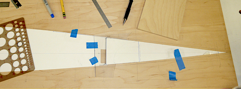

Peter, that really was a very helpful comment. I'm now making a wing cut-out shape, shown in SK-30, that I wouldn't have started without that help. The glue is drying on the carpet padding right at the moment.
Thanks very much.
Incidentally, for anyone planning on building an RV-3B, find about a square yard of industrial carpet, something relatively thin and stiff. It makes great edging for the various jigs that you'll be building. I just use ordinary white glue to hold the carpet to the plywood, and blue tape to secure it while it cures.
I keep a cost log for this project, and one of the major headings is "Infrastructure." That includes things like blue tape, glue, pencils, vacuum cleaner bags and so on. Things like plywood for the forms go into a separate heading called "Jigs and Tooling," not to be confused with "Tools," another one. The "Jigs and Tooling" is used sufficiently often to justify a heading of its own. It's surprising how much wood is used to build this all metal airplane.
Here's the current contour shape for the aileron-wing area. I've asked Van's Support if this is okay. The hinge is in the correct position, the aileron's chord line is on the wing's chord line, the top skin (now adjusted thanks to Peter's tip) fairs to the aileron, but the bottom wing edge is below fair by about .11 inches (2.8 mm). This time, the photo is right-side up. If you look close, you can see that I've drawn the rear spar and doubler on a bit of Mylar drafing film, and placed it on the posterboard.
Dave

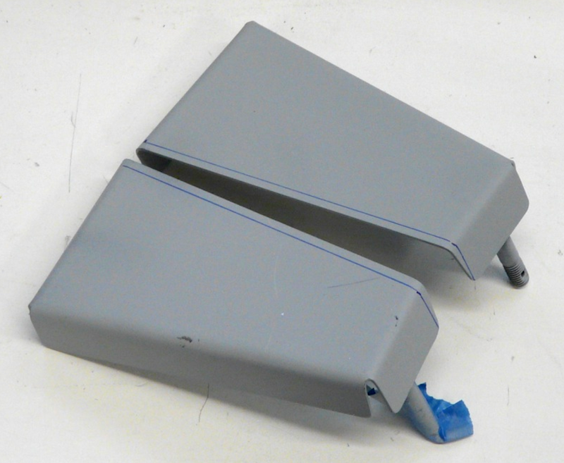

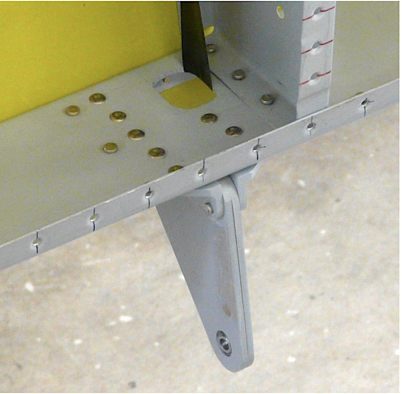

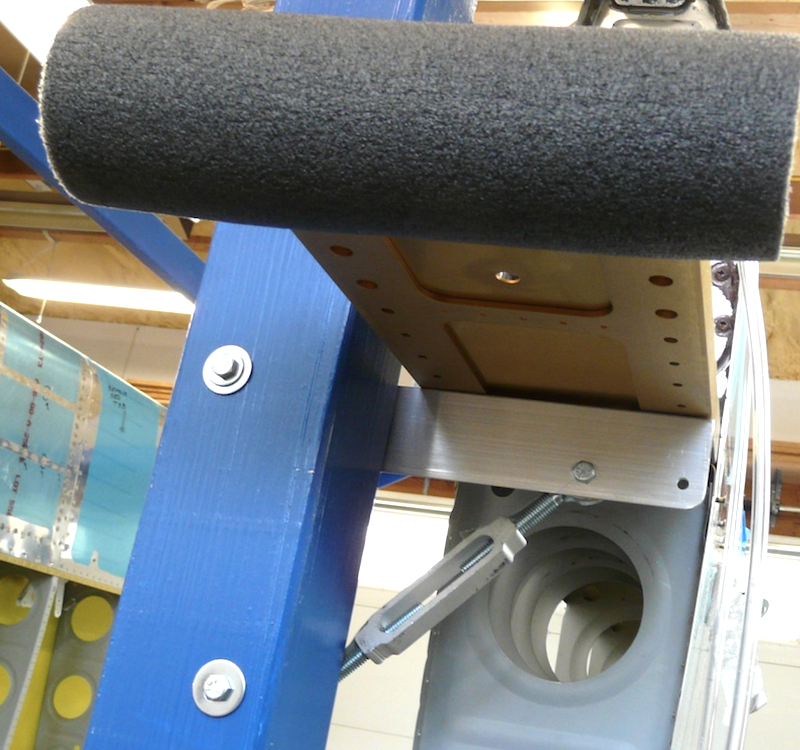

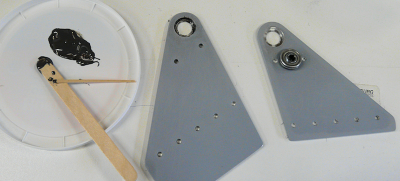

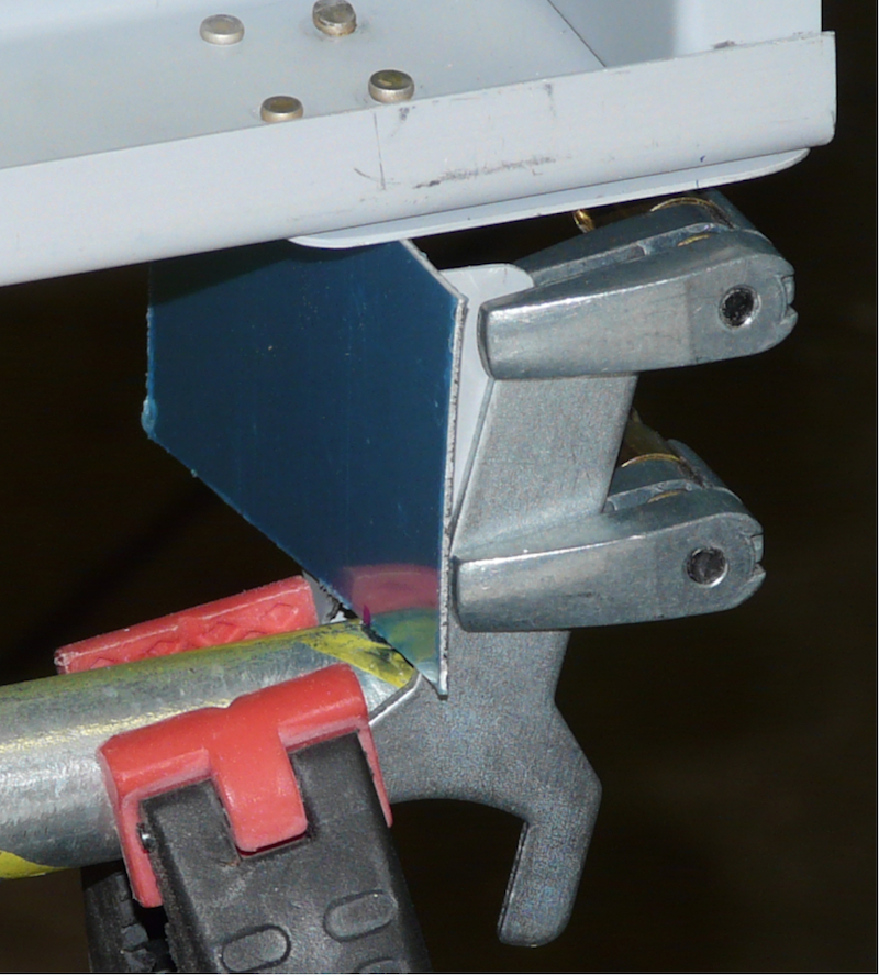

I'm working on the aileron hinges. Some of the very few pre-punched parts in the RV-3B kit include these hinge pieces. While having the small holes drilled is nice, the important thing is that the big ones are, too. And the really important thing is that they are bored for the bearings.
Unfortunately not all bores are equal. I had four bearings and eight aluminum pieces and a little more than half the bores had a slightly oversize diameter. The bearings (all of them) could shift radially slightly, perhaps .010 inches. I didn't bother measuring it.
What I did do, was clean the bores well and using a toothpick, smear just a little JB Weld on the circumference of the bores for the loose ones.
I used JB Weld simply because I didn't have any 3M 2216, which would have been the preferred adhesive. Another suitable adhesive would have been some Lord 320/322 adhesive, but I didn't have any of that, either. Still, this being only a shim, it's not critical.
After assembly and curing, I verified that all the spherical inserts in the bearings were free.
Dave

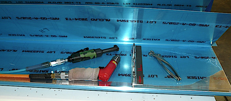

I decided that the left aileron really wasn't very well built, and am building a replacement. The original will go into the Attic of Embarrassment along with the other parts that I've replaced.

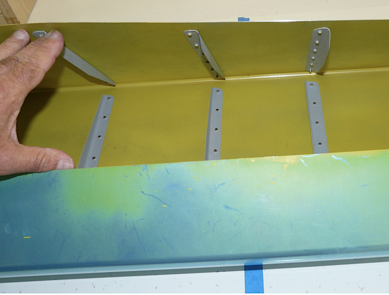

This time, I'm installing the stiffeners before bending the trailing edge. Although the factory bend is tighter than I'd remembered, it's going smoothly so far.
Here, I've got the matched-hole tool inside the skin drilling the holes for the stiffener rivets. I used the same tool to drill the holes in the stiffener, and gotta say, thanks, gasman (see post #144) for the suggestion. The stiffeners fit better this time around.
Note that I added an arrow to the tool, to help me ensure that the forward end really was forward. Colored tape works great for that sort of thing.
At the moment, I've removed the vinyl and am ready for deburring and dimpling the skin. The top flange of the spar has its rivet holes drilled to the skin. The spar reinforcement plates are on and the lightening holes made, and the spar and stiffeners are primed.
Interestingly, the spar was straight right out of the box. Drilling the lightening holes let it relax and now it's got a bend to it. Fortunately it's flexible enough that this is of no consequence, just that it was fun to watch develop as I put in the lightening holes.

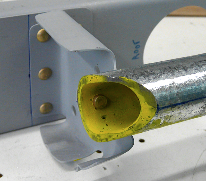

1/2" Galvanized Pipe - Poor Finish
I bought one from Van's with the rest of the parts that I ordered for my third aileron. The pipe came from Van's with a terrible finish. It looks more like a coating of ash than galvanized. Support said to scrub it with Scotchbrite and then prime it.
I went to Home Depot and their pipe is metal-stamped with the country of origin and some other information. The stamping is sharp-edged indentation.
So I went to Lowe's and there I found a good pipe, nothing unusable at all about it. Good galvanized finish, no damage from stamping it. All three pipes have the same specs.
I weighed all three pipes and, adjusted for length (Van's was longer; they all need trimming) and allowing for the threads on the HD and Lowe's pipes, all three weigh within just a few grams of each other.
I'm going to use the Lowe's pipe.

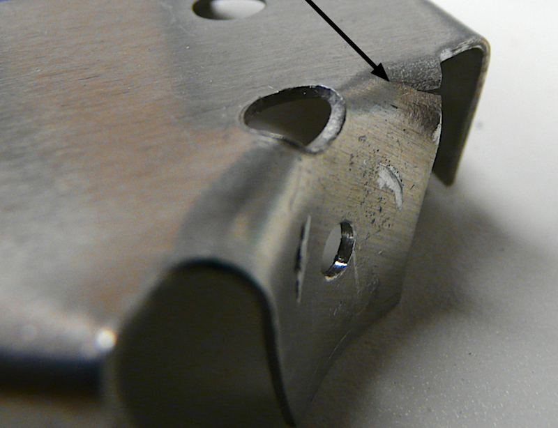

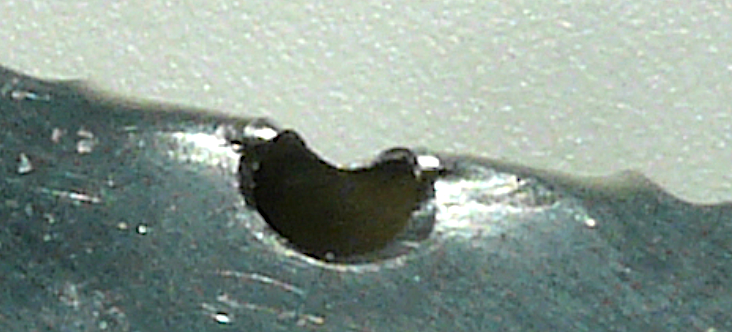

Cracked Nose Rib
I'd drilled the nose ribs and while deburring them, discovered that one of them, A-303-R, was cracked. I've contacted Van's for a replacement.
The crack is on the flange that attaches to the pipe (and yes, I didn't stop the drill in time....):
It extends roughly halfway from the edge to the tooling hole.
So in the meantime, I'm working on the flaps.

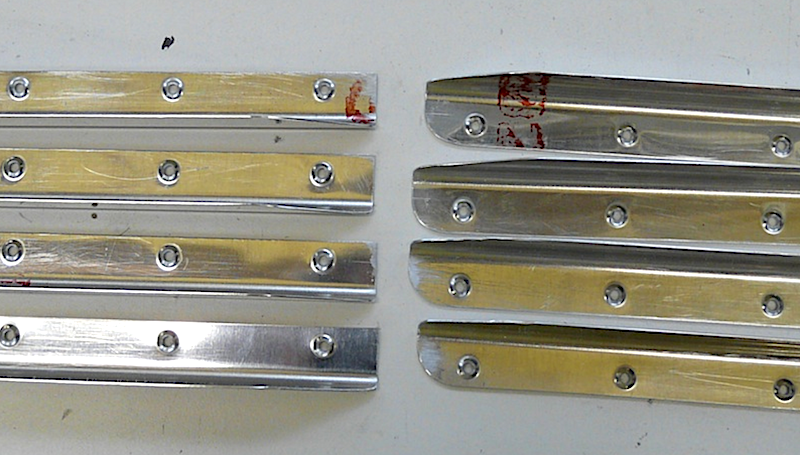

Saving Weight
The deal is, every gram counts. Seek it out wherever you can find it.
In this case, it was only 3 grams, achieved by rounding the corners of the flap's stiffeners, but I've been doing this all through the construction so far.
The photo shows the before and the after case.
I didn't draw or trace the curves. All I did was snip the corners off and rounded the ends with a coarse mill file, following up with a fine mill file.
The flap skins are mostly dimpled now and when that's complete I'll prime them. Ran out of those nails used for dimpling holes where I can't get a regular tool to.

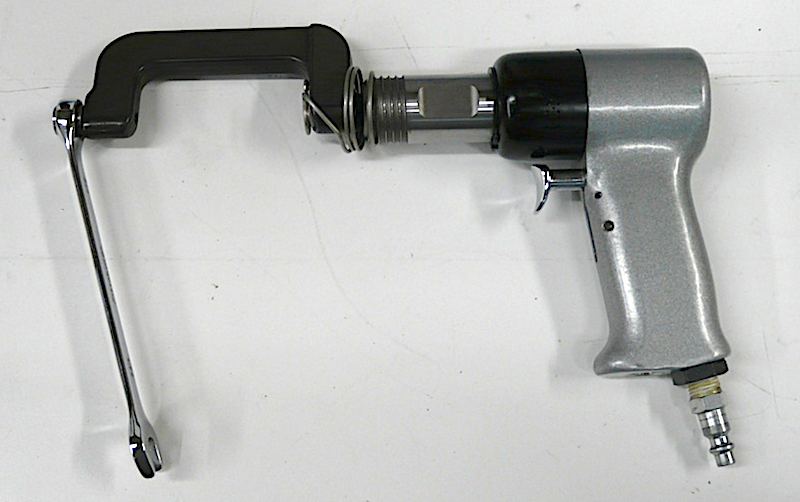

Working on the flaps now. The stiffeners are riveted on. I had a moment of considerable dismay when the retaining spring on the rivet gun unscrewed, the back-rivet set dropped on the floor and the spring propelled the plastic pusher to some mysterious place where it has not been found. You can read about it in this thread, which discusses the effect and its ramifications.
I found that a 7/16" box end wrench, pressed down around the rivet, makes a satisfactory substitute if you should find yourself in that position one day. Just put the end of the back-rivet set in the center of the box end and press the box end down on the parts, holding them and the set securely. It takes both hands but works okay.

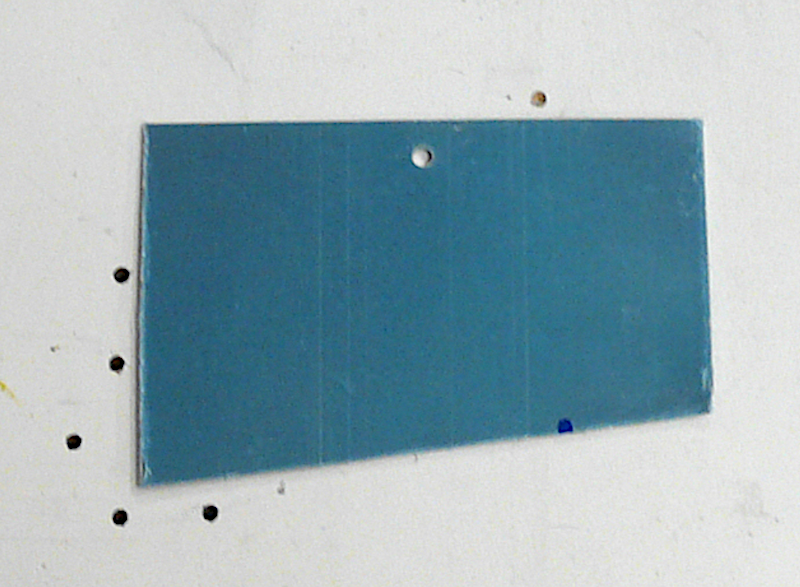

WD-306
Van's made my WD-306 Flap Brackets to the plans. I checked. They are fabricated on Drawing 30 and installed on Drawing 9. If you're scratch-building, don't make them to the plans - make them to fit. They fit inside the FL-303 Flap Ribs.
