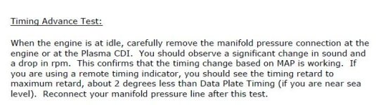

1) pull out a timing light and check the lightspeed as per that manual
2) disconnect the lightspeed manifold pressure line (plug the engine side) and do a mag check. You should see drops on both left and right.

The “zero drop” behavior is likely caused by advance. This CAN be normal, but understand that the Lightspeed uses a GM based MAP sensor, and the failure mode of that device is to default to full advance regardless of MAP. A timing light to verify operation is a good idea. Also, rather than look at RPM at the runup, look for an EGT change between dual and single ignitions. You may not see or hear the RPM change, but you will certainly see the EGT rise on a single ignition.

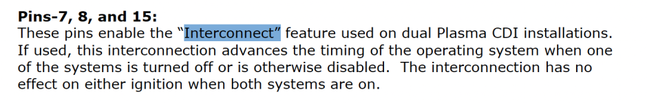

The dual lightspeed units will advance the timing ~5° when interconnected and one is disabled ("mag" check - the spike @ 09:05 and 09:08)
Note, the RPM drop was negligible during this "mag" check due to sample rate/display rate; it was detectable audibly, and a slight rise in EGT's. (the RPM glitch at 09:09" is a bug in the Plasma III unit, not real).

As expected, mag off, drops the rpms about 10 to 20 RPMs and the same is true for turning the LSE off. With the LSE on and mag off, the engine sounds a bit smoother but the difference is almost imperceptible. EGTs rise about 50 F for both events.
From what I can see, the OP has a perfectly normal and functioning ignition set up and no cause for concern.
