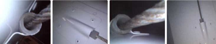

RE Check Your Tubes
…RV-9erA
These are what my polyethene rudder cable tubes look like after 21-years and 1800 hours of operation on my RV-9A. The left tube shows some inside wear but at the end only. And, the right side shows virtually no wear. I will probably rotate them 180 degrees at my next condition inspection. The cables came from Vans with a light coating of grease on them and still have some residual grease (always been hangared). More residual grease appears to be on the right side cable. So, I will probably reapply a light coating of Aeroshell grease on both cables to reduce frictional wear. The brown residue you see on the cables is the residual grease.
