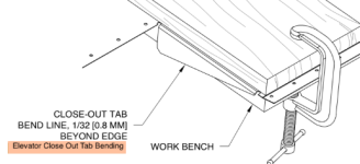

RV 14 Elevator close out tab
9-04 Step one calls for the top skin to be bent 1/64" from the bend line. Then step two calls for the lower skin to be bent 1/32" from the bend line. This seems backwards as when assembled the top skin goes over the top of the bottom skin tab.
