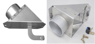

Heat Box Van's vs Spruce Aluminum vs Aluminum?
Van's Cabin Heat Valve/"Box" is out of stock. Spruce has one, but they are different. The Van's air valve looks aluminum and riveted together. The Spruce one is SS and spot welded. Frankly the SS one looks good. Any comments?
