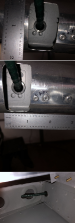

…Elevator trim tab cable cutout photos for DrWalker

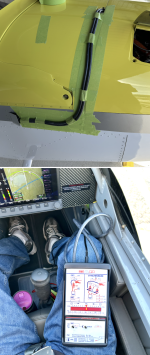

…UPDATE 912ULS Gearbox Rebuild
“I’m still trying to diagnose vibration roughness when throttling down from cruise RPM. See my post #1 above for full description of the problem. I spoke with Roger Lee (Rotax Owner’s Forum for 912/914 Technical Questions) and he thought problem is most likely carb synchronization. Advanced Power Solutions was also consulted and they offered carb synch as more plausible cause Vs. gearbox.
I’m wondering if anyone has ever hooked up a carb synchronizer in-flight to verify differential manifold vacuum L-R? I brought vacuum hoses from the intake manifolds into the airplane cabin via the side vent. Attached photo shows vacuum hose routing before hoses were completely covered with overlay tape.
Carbs were synched nicely at idle and off-idle before first test flight. The SynchroMate showed a large (4.5 cmHg) difference at full and mid-throttle flight settings. It took two ground adjustments of the left carb throttle cable housing to get a nearly dead-on synch in flight for mid-throttle and above. See photo of SynchroMate in-flight at 5500 RPM. The vibration roughness when reducing throttle from cruise RPM is significantly reduced and not really noticeable now. EGT’s track nicely in the upper RPM range. So, I think carb synch is the root cause of the vibration / roughness problem. To verify accuracy of SynchroMate, I reverse manifold vacuum lines and reading show same but on opposite side of scale.
The problem now is carb sync at lower engine speeds. With carbs now synched for mid-high RPM, the low speeds show manifold pressure differential at 7 cmHg and engine roughness. So, it seems I can’t make engine run happily at slow and fast speeds with same throttle cable adjustment.
Next step is probably to rebuild the carbs and then synchronize from bare bones up.
Has anyone tried a carb synchronizer in-flight to verify differential manifold vacuum L-R? I’m interested to know if synchronization of both carbs can be attained over full RPM range with a single cable setting…”

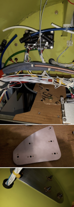

…Subpanel Goodies - Nuts or Nutplates? PIREP
The position of my AHARS had some issues with vibrations so I used a thick doubler with nut plates. Easy removal/replacement but too heavy to be used on every component.
Does anyone have a picture of the cutout on the forward edge of the left elevator which accommodates the trim cable. Plans show a single hole, adjacent to a matching hole on the horizontal stabilizer rear spar. Given 60 degrees of travel (30 up/30 down) it seems like a single hole would create a...
912ULS Gearbox Rebuild...
My friend has 500TT on his RV-12 and is experiencing engine vibration when he throttles back from cruise power setting of 5500 RPM. The engine runs smoothly during climb and at 5500 RPM in level cruise. Ignition check at 4000 is always good. Ignition check in the air is also good. When power is...

supik
What's your method of choice for attaching devices to the subpanel? Did you take the time to install nutplates for everything or just go with nuts? Lessons learned?
