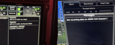

Garmin GTX "TRAFFIC ADS-B In traffic has failed."
Hi all, Anyone getting this "TRAFFIC ADS-B In traffic has failed." message on GTN connected to GTX 35R, 45R, 335.... transponders? Traffic information is inexistent most of the time, sometimes intermittent on the G3X and G3X shows CAS message "TRAFFIC FAIL" and "Not receiving data on ARINC 429...
