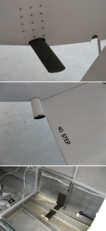

…step for taildragger

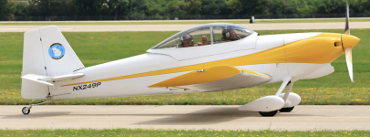

RV-4 Tailwheel Striking Rudder Fiberglass Fairing
…Jvon811 Data Point
I wouldn't call it common to see damage on the bottom of the rudder. Either the landing wasn't as smooth as you might have thought, or the field was pretty dang rough. In my local network of ~15 or so RV-4 friends, none have that damage. I have had damage from steering chains dragging on the rudder before, but that isn't the same. I've got just over 1000 hours in my airplane doing everything from STOL contests (landing tailwheel first) to Hurricane Relief missions hauling right up to the MGTOW of the airplane. I've never once had to think about the tailwheel hitting the bottom of the rudder. I apologize that I don't have a great answer for you, I don't think your tailwheel spring can "go bad" and need to be replaced unless it's been previously bent by some rough landings. Just food for thought.
Attached is a pic of 2xxlbs in my backseat. My father plus a full 3.5 gallon smoke tank in the baggage area. You can tell, it's already flexing a measurable amount, but still plenty of tailwheel spring clearance.
