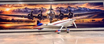

I am fortunate to own one of the best examples of a Harmon Rocket II ever constructed. It won a Silver Lindy at Oshkosh in 2002 and I'm convinced it would've won Grand Champion if there was a way to show all the hidden innovation and features. The builder, David Howe, is an absolute genius. He sees innovation and opportunities for improvement us mere mortals will never imagine. Jack Cox described this plane thusly "David Howe’s Harmon Rocket II is indeed one of the closest reaches toward perfection in the art and science of aircraft homebuilding any of us have had the privilege of seeing and admiring." in a December, 2003 article in Sport Aviation.
I'm very proud of the plane and see myself almost as a museum curator. My job is to preserve the plane in the condition I received it except that mine is a flying museum. I don't have the net worth to justify owning something that just sits in the corner of a hangar for viewing purposes only. My situation requires that I make regular use of the gem AND keep it as perfect as the day I took possession.
I'll use this thread to document any modifications and make note of any maintenance findings that may help other Rocket or RV owners. So it's not a "build" project, it's a "maintain and modify" process. More and more RV and Rocket owners fit this description, so I'm hoping this thread is relevant and helpful. I'm a bit more technically capable and really consider myself more of a builder than a buyer, but here we are. Comments and critique welcomed. That's how I learn.

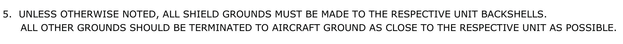

From the G3x Installation Manual:
I’m not too worried about ground loops interference from a 200mah load.
My only criticism would be that I prefer the ring terminal to directly contact the structure, in your current installation it's relying on the screw for the ground path. There is also the possibility that the nylon clamp cracks and breaks away from the screw, leaving the ring terminal loose. Should be fine for now, but might be worth just drilling another hole for a dedicated fastener for the ground attachment at the next CI.
OK. That’s a great observation. I’ll correct it ASAP.
Other than that it looks great to me! I just installed a nearly identical suite of avionics in my -6 (GNX375, GTR205x, Dual G5s, GFC500) so I'm very familiar with what you just went through lol. I am curious how well your G5 bracket works without the receptacle for the pin at the top of the G5. I always assumed it was just for alignment, so it should be fine without it.
Dang, this is looking great! You should bring that puppy a couple minutes north to 18V when you get it finished. I'd love to see if I can borrow any of those amazing HFS details on my 4 fastback rebuild.
Fixed it this afternoon… (Yes, the primer has been removed under the ring terminal for a good connection to the airframe.)

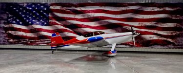

Well, like many men, I missed an important anniversary date yesterday.
As of July 2, I have accumulated 80 hours of flight time and one year of ownership of the best Harmon Rocket in existence. It has required zero maintenance other than routine oil changes and lubrication. I am very grateful to David for such a great airplane.
Everyone needs one!
This picture was taken on the ramp at Richfield Municipal Airport (KRIF) on my way home from California one year ago yesterday.
