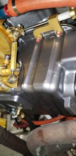

For today's session, I ignored my perceived induction leak/high idle MAP and worked injection system only.
I did Don's fuel flow test. I verified gap between throttle plate and bore at .006". I disconnected the hose from the flow divider and rigged a way to dump it into a bucket. Supposed to run the boost pump with throttle wide open and mixture full rich for a couple of minutes and then look at fuel flow. Target 3-5gph. Slowly moving mixture towards lean should reduce fuel flow and it does. Then, mixture full rich again and reduce throttle. Passing through ~1/2 throttle flow should start to decrease and it did. Fuel flow at idle stop should be 1.2gph. Mine read zero but I could see fuel coming out of the hose so I redid the whole test into graduated cups with stopwatch.
Full rich, WOT I got 5oz of fuel in 30 seconds. 5/128 oz/g x 120 seconds yields 4.6875 gph. That's within the 3-5 target.
Full rich, on the idle stop gave me 4oz of fuel in a minute. 4/128 x 60 yields 1.875 gph which is way over the 1.2 target. This jibes with my excessive ICO rpm rise.
I investigated whether I could change the relationship of the throttle shaft to the idle circuit shaft and it is one solid arm. I could not have possibly miss-clocked it during initial fitting. My troubles really seemed to have gotten intolerable when I attempted to adjust the idle mixture and at the same time changed the injector restrictors, so I lengthened the idle mixture adjustment arm to somewhere near where it had been previously and ran the same test getting about 3 1/4 oz in 30 seconds for 3.05 gph. That makes sense. Richer idle mixture adjustment = more fuel flow. Should aggravate the stumble. For giggles, I put the hoses back in place and ran the engine. It really didn't like fast idle at full rich so I pulled most of the way to ICO, reducing throttle to maintain 1k rpm for warm up, where it seemed a lot happier. This is what I always used to do - lean after start and for taxi just like I'd do with a carb. After she warmed up a bit, I moved the mixture fairly quickly to full rich and she almost choked. Went back to about halfway on the mixture and was able to accelerate through 1200rpm with only a little hesitation. I did it again after slowly advancing mixture to full rich and got similar results with or without boost pump, certainly no worse than it's been for 7 years. The only difference is that my airbox and filter are off it.
So...the fuel control servo is not in spec, but operationally viable. Setting the mixture closer to spec makes it a lot worse. What's a motorvated team associate to do? (anybody catch that reference?)
Ed

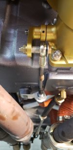

I'm looking at a FM-150 and it looks to me like the fuel control arm is not attached to the throttle arm with a solid arm. The fuel control arm has a bolt and nut that pinches on the fuel control shaft. It can be miss clocked. It you can't make the arm long enough the lean it out at idle, loosen the nut and bolt that pinch the arm on the fuel shaft and change the clocking to a leaner position. About 5 degrees should do it. Very sensitive adjustment.
The problem is that I can't make the adjustable linkage short enough to lean it properly. The rod end bearings are bottomed on the jam nuts.
I had to mount the servo with the controls on the bottom to talk to cables coming under the cold air sump. That meant that I had to remove the throttle lever and move it to the other side of the servo leaving the idle mixture linkage on the top. The one piece arm that I'm talking about is behind that throttle arm that you can see in the picture. It extends out to pick up the adjustable linkage and sticks out the other side to hit the throttle stop. It has a roll pin to secure it to the shaft so it can't be re-clocked. I had imagined that I could rotate is slightly and re-engage the serrated teeth as you can with the throttle lever itself, but no. Even if I could move it a few degrees, the other end would move a similar amount and the idle stop would leave the throttle plate with the wrong amount of opening.
Personally I would NOT touch that arm with the pinch bolt. That is not considered a field adjustment. It is used to manipulate the gross idle flow into the specified range (fine adj is the turnbuckle, which is a field adj) and requires volume and pressure measuring equipment. If Don gives you instructions to play with it, I am sure it is fine, but highly doubt he would. Pretty sure that servo flowed exactly what it should have when it left Don's shop. Now that it doesn't do that anymore, it really should go back to Don to find out why. Playing with adjustments you don't understand (no documentation for adjusting), to paper over another unknown flaw, is just asking for a serious problem down the road. It seems highly unlikely that arm just slipped. That means something inside has changed that shouldn't have. That thing needs to be found and fixed. The thing that changed may be stable for the next 1000 hours or it may get radically worse in the next hour; you just can't predict untill you know what is. with most servos, you set the idle mixture at install and it is rock solid all the way to TBO. I havn't touched mine in 1300 hours. This is a warning that should not be ignored.
This. Time to call Don.
Late. I'll get back to Larry in the morning.
Ed

I was under the impression that the arm to the idle circuit could have been miss-clocked by myself when I moved the throttle arm from one side of the shaft to the other. I was going to re-clock it slightly and test run to see if that would make a proper idle mixture adjustment possible and if it might cure the stumble. As soon as I determined that my assumption was incorrect and that a re-clock wasn't possible, that went out the window.
Yup, no intention of making ad hoc mods to the servo. Moving an arm across the servo to get a cable on it is one thing and was actually covered in the install manual. I may be crazy but I'm not stupid. Wait. Maybe it was the other way around. ;-) Agreed, a call to Don is in order. He's going to tell me to send it in. He already told me to if it failed the flow test. So that's probably next.
I agree with you about the manifold pressure which is a red herring in this mystery. Suction is suction and it has to be going somewhere or the indication isn't real. The leak is probably in the line to the sensor. It wouldn't take a huge leak to change the reading and the ignitions not advancing kind of backs up that the indication might be for real. The restrictor in the fitting at the intake port would tend to minimize the effect of a leak on the way the engine runs.

I think mine is the old version. Mine is anodized black. I got it 8 or 9 years ago. Not sure I want to re-engineer my whole installation. Your pictures are interesting. I like the belcrank and torque tube setup. That was definitely not offered to me back then. I would have mounted mine like yours and had the idle mix adjustment a lot easier to get to. I have the Superior sump which also probably has a little different geometry.
Ed
I took a jam nut off and there was no change. My fuel servo and spider are on their way to South Carolina.
