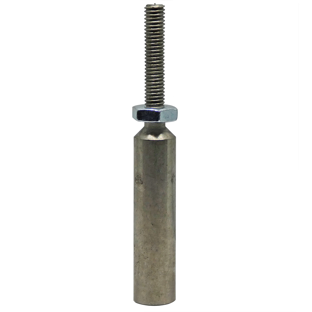

I need to shorten this throttle cable extension (not sure what it’s called) by about 1/8” of an inch.
I had to adjust the throttle arm on new carb due to some geometry issues ( cable hits oil pan at full throttle ) and it needs to be shortened by 1/8-1/4”.
Or can these be cut ?

Your throttle cable "extension" is nothing more than a piece of aluminum tubing that has been cut to length, and tapped on both ends to accept 10-32 threads (from the rod end and the actual end of the throttle cable). So yes, you can cut it to the length needed. You might have to re-tap the cut end deeper so the threaded in part will still fit. While doing that, make the extension short enough so that you have a few threads showing at each end.....to allow for future shortening adjustments. In the photo it looks like both ends are fully threaded in........and the cable is still too long.
Having said all that, my personal preference would be to determine the actual cable length required, and order a new cable to fit. That makes one fewer threaded connections in the system (ie: one less connection to fail.....also, a longer cable might help solve your "cable touching the oil sump at full throttle" problem).
Maybe one of the A&Ps here will chime in as to whether such a cable extension is acceptable/not acceptable as a general practice.
Not an AP, but I wouldn’t accept this in my airplane. Get a proper cable.
You may need to modify or replace your bracket if geometry is the issue.

You may need a proper extension to replace the aluminum tubing in the picture. Aircraft Spruce has this:
Or follow the suggestion and replace the current control cable with the new control cable with the appropriate length.
