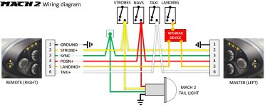

The Flyleds The Essentials and The Works kit are operated using a central controller board, in much the same way as the old xenon strobe systems has a central power supply. Instead the Mach 2 lights are fully self contained, just needing power and ground to operate. Like other LED strobe products on the market, there is a sync wire that runs between the wings and tail light that will allow the Master unit on the pilot's wing to sync the strobes on the right wing as well as the matching tail strobe.

We supply short wiring harness tails with a 6 pin plug that clicks into the light modules. You then make connections to Ground, Strobe+, Position/Navs+, Landing lights+, Taxi lights+, Sync. Easy!
