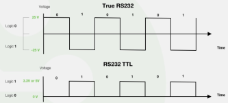

In short, the problem was the lack of magnetic variation. My solution is to inject a magnetic variation into the GPS output. Basically I put a microcontroller in the middle of the data flow. It takes the GPS output, adds a magnetic variation to it, then sends the modified GPS data to the autopilot.
This method needs these items:
  • An NMEA GPS receiver using RS232 with 4800 baud. They are usually around $20. Example.
  • An RS232 to TTL converter like this.
  • A microcontroller. I use ESP32 for a quick start. But any microcontroller with the ability to process UART should work.
I published the source code here. Right now it's a hard coded with a variation of 4 degrees west, because it's just where I live. Later I'll update the code to calculate it based on latitude and longitude.
I programmed the ESP32 dev board with the source code and wired it like this diagram. Then it just works! It's able to keep flying in a perfect straight line. Finally I don't have to keep holding the stick for once! I'm so happy with it!

Nicely done! Does the RS232 to TTL converter just lower the voltage of the signal, or does it also alter the format?
