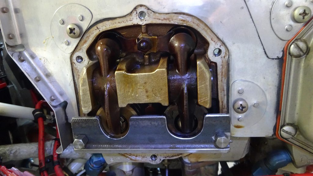

I think you can buy one of these, but I often make my own tools. I am a cheap SOB.
A piece of aluminum plate, two 1/4" hardware bolts, a few other bits, and some welding.
Park the cylinder on TDC, vales closed. Spin the threads into the valve cover screw holes until snug, then one extra turn. Pushes the valve in just a smidge, so no strain on the rocker arm shafts, and they can be pushed out.

That said, I just crafted one of the...what would this be called....a valve spring unloading tool?... I started with Dan's drawing and redrew it on my drafting board. Then went out to the airplane to confirm dimensions. I found the measurements in the drawing did not quite line up with my O-320 head. I had to tinker with the drawing a bit to determine where things went before I finally set it to the scrap 3/8 inch aluminum pieces (overkill!) I had lying around. Even then, after drawing the pattern on the aluminum, went out and compared what I was about to make with what the cylinder head needed. My final drawing appeared to be correct. It was a mild PITA in that my band saw needed some new parts, so it was all done with the use of my handy-dandy hack saw. Good exercise. And some step drills, Dremel, files . Finished with the Scotchbrite wheel.
SO: put your own drawings to the test. Go out to your engine and MEASURE to make sure everything lines up. Correct your drawing as needed before you start cutting; you don't want to make this twice! Then you will have a pretty cool tool that will be passed down for generations! 😊 That sucker ain't going ANYwhere! 1000 years from now they will dig that up and think.....huh.....must have been a piece of jewelry something from some kind of a cult.......:ROFLMAO::LOL:

The gauge used on the angle valve engines is angled; the gauge used on parallel valve engines pushes against the valve extension at a 90 degree angle. So: no, this is not good for measuring the wobble. See below.
Not sure if you guys know this but the rockers and the fulcrum can be removed relatively easily without tools. This tool cannot push the springs in far enough to remove the keepers.
No: this tool is just to decrease the tension on the valve springs to let the rocker shaft be more easily removed. Yes, you can do it without this but this tool makes it MUCH easier. Very easy to fabricate; just a minor PITA. This is NOT a wobble test tool. That is a completely different tool. It is NOT a valve spring compression tool for removing the keepers and, ultimately, the springs. That is another tool altogether. Your Valve Wizard or other tool would be the one for that. THEN you bolt on the wobble tool to measure movement of the valve stem. See Lycoming SB 388C. ACS sells that tool for $259 with the dial indicator. OR you can make your own. There are multiple designs out there. Look at the one from ACS; surely you can make that on your own....... I'm in to being tool-independent.... :LOL:

Had some 6061-T6 in my "trash" box, and used that to manufacture said plate... I'm happy to report that despite being only 15/64" (6 mm) thick aluminum, it held pretty good and did not bend any when I did my 400H wobble inspection today.

All good, but for cylinder #2 having barely any play, so the valve was dropped into the cylinder, its stem cleaned from the black gum, and some miraculous fishing performed to reinstall the valve. Ah yeah, and also having fun chasing the wandering keepers...
