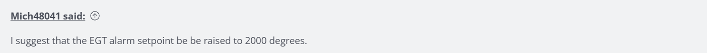

I suggested 2000 degrees F arbitrarily to eliminate nuisance alarms at 1500 degrees.
According to post 12 above, evidently Van's arbitrarily specified 1742F as the maximum.
Who knows why they picked such a precise number?
What happens if the EGT reaches 1743 F ? :)
