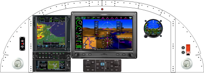

I'm in the process of upgrading the panel in my RV-8 and am trying to decide what to use for backup AI. In terms of Garmin products, what advantage would the G5 have over the GI275 with ADAHRS? It seems most people today go with the G5. I'm just not sure why?
I regularly fly the aircraft in light IFR (min 1,000' & 2SM) so I'm designing the panel to have some redundancy for GPS and COM. I'm planning on installing a G3X touch along with GTN750, GNC255, and GMC307 autopilot control. Here's what I had in mind?

Any opinions/recommendations on backup AI and panel layout would be appreciated.

Some thoughts:
- The G5 is a backup. The GI275 is a very expensive enhanced backup. In other words the cost to value ratio is not there.
- A full functional 7” display second EFIS to go with your 10” display is, in my opinion, a better way to go. This however will require you rethinking the GTN-750 to free up the needed panel space. The 750 is a good backup moving map but not a PDF. A 7” EFIS is both.
- The GTN-650 and 750 both provide the certified IFR capabilities you want. Both feed your EFIS displays so the larger 750 screen is redundant - and considering the panel space restrictions it is more problem than solution.
- Remote XPDR and remote COMM #2 are recommended. I assume Garmin offers these.
- Having the autopilot control low bucks the trend - but I consider this location superior to the standard of high on the panel. Keep the stuff you look at high. The autopilot control box should where you hand falls on it.
- Continue to keep the EFIS displays as high as possible. If you use the GTN-650 keep it high as well to fat finger in the ATC reroutes.
- At some point you will want to make changes. Plan on this. For example move the air vents off the panel. Easy enough to hang them below the panel, one on each side.

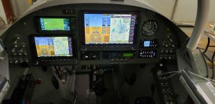

The photo is the SkyView version of all this. Note at some point I may change out the analog airspeed instrument for a G5. The center potion of the panel is fully removable in ~15 minutes - addressing the aspects of maintenance and future panel changes.

This was an older 2 screen install that I did in an RV8, (the touch and G5 wasn't out yet).
I think the 2 screen layout looks nice and adds redundancy.
I think I had to extend the panel for this setup but that's what he wanted.
I would arrange things a little differently normally.
