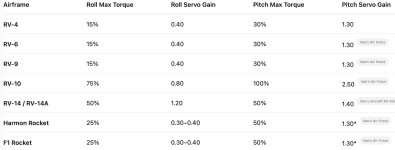

I'll turn off the auto trim for now and see if that helps. When I asked ChatGPT for a table for each of the Vans Aircraft it put together the following using this site as the source.

@dmattmul Mind sharing screen shots of your pitch & roll settings? I disabled trim speed, tried a various of things with pitch trim, emailed @g3xpert and just can't get this tuned. I've gone through the bump test / calibration. Emailed logs. All the other planes I have had no problem dialing in the G3X / GFC 500 (Savage Norde, RV-12, RV-7), but this plane is struggling.
If I have aircraft in heading mode with altitude hold at 200 KTAS, and I command more than a quick turn (i.e. 45 degrees) it'll drop the nose -300 feet, eventually it'll catch it and then go +300 and take a few times to settle back to the altitude. -300 on an approach is a big problem.
I'm currently at the following on pitch. I now have pitch trim disabled and I adjust it manually until I get this sorted and remove that as a factor.
Pitch Servo Max Torque: 50%
Pitch Servo Gain: 0.6
Min Airspeed: 70 kt
Max Airspeed: 200 kt
Vertical Speed Gain: 1.25
Vertical Accel Gain: 1.5
Airspeed Gain: 1.5
