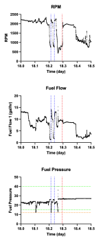

Hi all, on Canada day I had my first engine failure (suspected fuel starvation) in flight in my RV9A. I am a PPL with limited experience and looking for troubleshooting tips. I have an IO-320-B1A, IFR-rated and IMC permitted (and has been used as such for a very long time). 1700 Air time on airframe and engine, construction 2011.
Pre-flight included checking the breather hoses externally and fuel sump as usual. Taxi and run-up we had some difficulty with the magnetos check and CHT#3 temps since it was such a hot day (31C, 90% RH), we couldn’t get to high RPM and peak mixture to clean the plugs Finally we accepted a drop of 80rpm on each mag. Everything was done on the R tank. During takeoff, we noticed lower fuel pressure at 21 PSI. Historically we are at 26-27 PSI and the pump manufacturer (Tempest #AF15473) recommends 25-30. We turned on the electric fuel pump when we noticed this and the pressure went back up to 25 for the rest of the climb to 1500. Disengaged electric pump as of this altitude.
No indications during cruise, everything was going well. We did some steep turns and stalls. At some point a few minutes before the engine failure, I switched to the L fuel tank (for the first time since engine start). I did two stalls and on the second stall recovery, the engine failure occurred. No CHT/EGT/Oil pressure/Oil temperature indications, but the fuel pressure dropped. My instructor turned on the electric fuel pump and switched the tank back to R. This restarted the engine and we were able to make it down to an airport safely. On the ground, we re-checked the sumps and didn’t find any water or contaminants. A ground run on the next day with the mechanical fuel pump on L tank revealed no issues.
Speaking to a few people and looking at my engine data, we have a few main hypotheses:
1. Left-side breather hose partial blockage
2. Left-side fuel line partial blockage
3. Mechanical fuel pump in the process of failing
4. Possibility that I didn’t push the L fuel valve in completely resulting in partial fuel flow
5. Two people mentioned the possibility of vapour lock in flight? We were at 7500 density altitude, 90-95% humidity, during high nose-up attitude prior to stalls
6. Two people also mentioned the possibility of induction icing in the throttle body?
The mechanic on the ground put a thin metal wire inside the left breather hose and thinks he felt some blockage but wasn’t confident if it was a kink in the line or a real obstruction - diagnosis unclear.
Things I’d consider changing in all cases
1. Mechanical fuel pump is past service life (10 years), should we change this?
2. Engine oil and checking filters just to confirm we didn’t have an actual engine failure
I've pulled the engine data from the EFIS and posted here. The vertical line represents approximately 1 minute post-emergency. Any ideas other than what we're thinking? Where should we start?
**Edit** Fuel quantity 13L/14R

1: vent line blockage would take a good bit longer than a couple minutes to cause immediatye starvation. it would sloiwly get worse over time and should take a lot longer than 2 minutes. i suspect you would have seen weeping rivets by now if it were blocked. very easy to test that.
2&3 is where i would start as most probable, with 2 a bit more likely imo. vapor lock doesn't seem likely with the scenario you layed out - immediate resolution with tank swap. icing is possible, but not really that common. it usually happens when you pull back power on hot humid days. Again, doesn't fit very well with the scenario you layed out - it wouldn't immediately restart on the other tank.
1: vent line blockage would take a good bit longer than a couple minutes to cause immediatye starvation. it would sloiwly get worse over time and should take a lot longer than 2 minutes, unless it was already under vacuum from the climb. i suspect you would have seen weeping rivets by now if it were blocked. very easy to test that.
2&3 is where i would start as most probable, with 2 a bit more likely imo. vapor lock doesn't seem likely with the scenario you layed out. icing is possible, but not really that common. it usually happens when you pull back power on hot humid days. Again, doesn't fit very well with the scenario you layed out.
We did pull back power twice for the stalls, is your assessment the same? They lasted maybe 30 seconds at a time so very short duration.
You have a servo, not a carb. difficult to get carb ice if you don't have a carb. What causes the ice is the rapid cooloing, in part, from latent heat of evaporation from the fuel mixed in the low pressure part of the venturi. No fuel mixed there in a servo.
Are you sure the fuel selector valve was 100% in the right spot?
I can't rule out the possibility that I mistakenly had it only halfway in position. I'd like to think that it was but no way to prove it which is why it's in the list of options. I hope it's as simple of an answer as that.

Since no one has commented on it - in the graphs on the original post, the fuel pressure drops intermittently at many points in the flight. Does anything think that's an indication that the mechanical pump is failing? Or could it just be a side effect of a blockage?
My first inclination is still something preventing/restricting flow from the left tank. The flow test outlined in Post #11 should be able to confirm or eliminate that. Since you're not caught up in Fourth of July activities today, maybe you and your mechanic will be able to take a look.
Looking back at your original post, you mentioned, "Possibility that I didn’t push the L fuel valve in completely resulting in partial fuel flow". With the Andair valves I've seen, you don't need to push the valve in. English may be a second language since you're from Montreal, so maybe that's just the phrasing that's got me there (I'm not trying to be condescending). But I'm just curious about the valve. The Andair valve should be clearly labeled, and they have a big red triangle pointer as the valve handle. You should be able to go all the way to the stops for left or right, lifting the button only to go to the OFF position. That's one of the advantages to this valve, as you can go all the way to the stops without looking.

With Injected engines, the engine will falter and pretty positively shut down if the fuel pressure at the servo inlet goes below about 15 psi. Your data shows that that happened, therefore the engine shutdown. Probably just bringing the electric pump online would have been all that was required for the engine to resume running, however the instructors training to switch the tank also is valid.
So the main question is why the fuel pressure dropped off. The mechanical fuel pump short comings are thoroughly discussed in these forums, but I will say from personal experience that the mechanical pump doesn’t tolerate any leakage before the pump. That is a leak under suction, that may not even show up under pressure (electric pump on).
This doesn’t mean that you should rule out other things that could restrict fuel flow.
I expect to go to the plane tomorrow with my mechanic - for now I'm digging into the data.
From the raw data, here's what I gather.
18:15:06 engine begins quitting, 2200 rpm steadily dropping
18:15:52 lowest RPM (engine dead), 419, fuel pressure lowest
18:15:53 Electric fuel pump ON, pressure comes back immediately, fuel flow stabilizes
estimated time R tank switch ~18:17:10
18:17:34 7700, engine RPM sharply rising
18:17:51 Engine back to normal RPM
The period of time between electric pump ON ~90 seconds seems to suggest to me fuel restriction rather than mechanical pump failure. What I don't seem to understand is why, despite fuel flow going back up as of 18:15:53, the engine doesn't come back until 90 seconds later.
The fuel pressure sensor to my understanding is on the mechanical fuel pump itself. Where is the fuel flow sensor?
Likely a language thing. It's 100% and Andair valve, and by 'push in' I meant valve switched towards the left (counterclockwise rotation). I normally do it until I feel a 'stop' in the valve. Your description is what I think I did.
Could be either. Yours are pretty significant. The intermittent nature of those spikes makes a failing pump likely, though vapor issues present the same way and must be considered. However, blockage can also be a chunk of FOD floatining around that only intermittently blocks flow. If my plane, the key here is a tank swap immediately solved the problem and that points me to an issue with that one tank. However, it could be just coincidental. FP was highly intermittent, yet the tank problem was not. Switch to X tank and engine stops. Switch to Y tank and engine starts. Pretty hard to put that on the fuel pump. Though it is also possible the pump does have issues of its own.
Here's my strategy to discuss with mechanic.
1. Plug a line to breather hose **EDIT: vent line** and blow in it with someone listening at the cap (posts #13 and #20)
2. Check fuel flow (#11)
3. Check gascolator to see if anything is stuck in there
