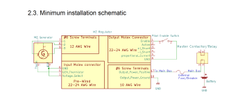

Soon integrating, a monkworkz back up alternator with my G3 X touch. Bill supplies a 0 to 2.7 V output signal which is linearly proportional to current load seen by the alternator. Question is how do I input that to my GEA-24 so I can display load just like my main alternator? Any feedback is appreciated.
See Garmin G3X Installation manual, revision AU, Section 30.4.32.15. Wire the MZ30L Shunt Hi/Lo output (Output Molex Pin 3 and 4) to the GEA 24 SHUNT 2 input - Pins 35 & 34. Configure the SHUNT 2 display/type/scale factor accordingly. I also used the MZ30L "Active" output to a spare GP input on the GEA 24 to tell me when/if the MZ30L was active, It will indicate on the CAS display as "Standby ALT" in white.

The MZ30L has two current outputs -- proportional and shunt. I used the shunt hi/lo output wired to the GEA 24 "SHUNT 2" inputs. Calibration was pretty straightforward, once you run the Garmin installation manual through the Garminspeak-to-Human Converter... (Must be Kansas/Oregon thing :) )

I will copy try your setup using the shunt which if the old manual that I have still valid it would be pin 3 & 4 of the MZ30. I guess your config that showed .27 for the multiplier threw me off thinking you are using the voltage (pin 5)
Thanks again.
Pinouts for the MZ30L. And exercise caution as the FemtoMolex(TM) and 26ga (ok, 24ga) wire is PITA to work with.
