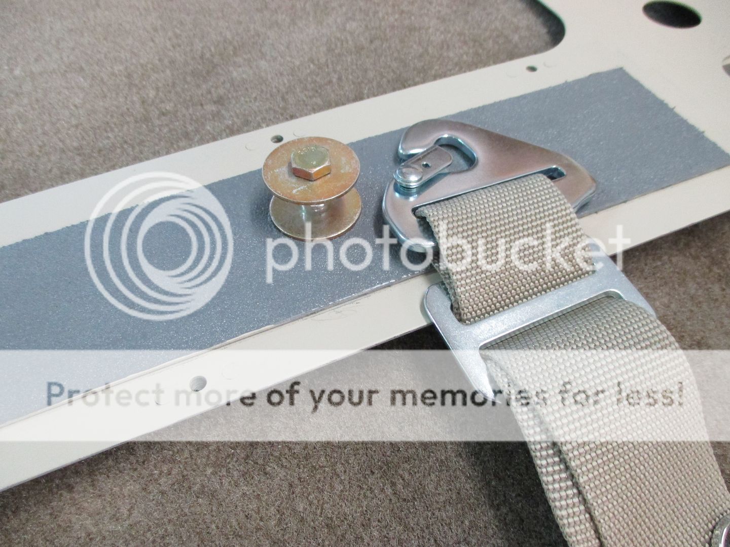

Crotch strap attachment idea
library

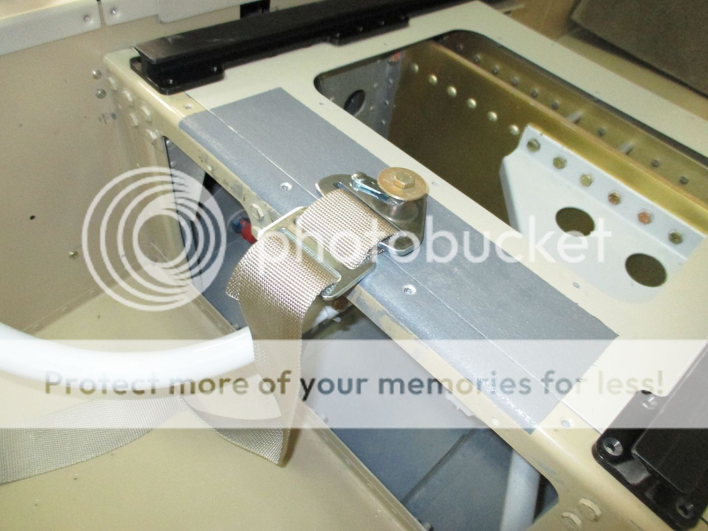

I used a bolt through the panel, under the seat. It is high enough to accept the removable Crow attachment, but does not interfere with the seat bottom. I'm sure it is not strong enough to meet all the G load requirements for certified aircraft, but I figured the load is in shear and should be much better than not having a crotch strap. The strap wraps around the front of the seat and must be pulled tight to avoid interference with the control stick. If it doesn't work as well as hoped, I can always remove it. I see no other way to install this?? I'd appreciate comments and suggestions. (Not sure about the attached pictures?? I'll see if they made it??)
Bill,
This is what I looked to do as well. Unfortunate I had the seats done already before I figured out that for this to work the front seats need a crotch strap slot like the rear seats.
Hooker sent me the crotch strap so perhaps one day I'll send the front seats back to DJ at Cleaveland tool and have her put in the slots.
