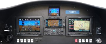

I'll add that I've never been a fan of rocker switches with automotive-grade spade terminals being used for aircraft (long story short: vibration is not your friend). One time my Avionics Master switch (second from right in photo) became intermittent — and of course I couldn't just whip out the needle-nose pliers in flight and re-pinch the quick connect lug(s) behind the panel.
Enter the VP-X, where I simply went to the appropriate screen and forced the avionics on, bypassing the maverick switch until I got to the ground. One of the fringe benefits of the VP-X system.
