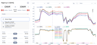

On my IO-360 with SDS, I have my #3 cylinder behaving a bit "out of family" with the other 3. This is not a new occurrence, it's been this way for over a thousand hours now, and it's not changing - quite stable - but I've run out of easy answers on what the story is. The engineer in me says there's a reason and I can't quit picking at it, like a kid with a scab on his knee.
Symptoms are that the #3 runs about 40-50 degrees cooler on CHT, and about 150 degrees warmer on EGT. I don't claim to be an engine expert but I do know my way around them pretty well - I know that it's NOT a spark plug, wire, or coil issue (having swapped them around back and forth), it's NOT a temp sensor issue (swapped those around too), and it's NOT a mixture issue as I have a GAMI spread between all the cylinders of either 0.0 or 0.1, depending on which day of the week I run the test and how carefully I do it. The SDS system allows me to individually trim the fuel flow to each cylinder, so dialing in the GAMI spread is easy. I see this temp spread on both 100LL and 93E10, both ROP and LOP, cruise and climb. The exhaust valve is not leaking as far as I can tell - 78/80 on that cylinder during my recent condition inspection and the borescope pictures of the exhaust valve look great. I burn one quart of oil in about 20 hours - so the rings are all good. I even lapped the exhaust valve in-situ a couple hundred hours ago, with no change.
The obvious answers have already been covered, which means it has to be something odd - which is where I turn to the brain trust here.
It's apparent that less combustion is occurring IN the cylinder, and more OUTSIDE the cylinder in the exhaust valve and pipe as compared to the others - which points to either an exhaust valve leak (none found) or perhaps the exhaust valve is opening too soon - which would only be possible if my exhaust valve pushrod is too long by some small amount and opening before the others. I have not pulled the rods and measured them but that's getting up pretty high on my "to-do" list now. Equally possible, and just as unlikely, is the the cam lobes for the other 3 cylinders are all worn down almost identically, but the engine makes no metal at 1640 hours so that's not supported by evidence.
Some of you gray-headed guys (like me) got any good ideas?

Looking at your EFIS screenshot, I'd say 1&3 are acting similarly and 2&4 are acting similarly. It's not just cyl 3.
CHT could be explained by better cooling on the RH side, but not EGT, unless probe placement is different left cylinders to right cylinders.
So, what else could be causing the RH cylinders to behave differently than the LH side?
Edit: I'm going to go out on a limb here, but it seems the compression ratio is different L to R sides. You could test for this by doing a cranking compression test. Not a differential test.
I noticed this also but kind of figured he may have picked a less representative screenshot and the trends he is noticing are specific to #3. Certainly worth clarification...
What in interesting condition. It indeed looks like 1 and 3 are doing the same. Since the CHT and EGT and both acting consistently, it is worthwhile to believe it is real. Although the "flame" is not going out the exhaust the heat energy sure is. Consult the PV diagram. Assuming perfect instrumentation, then this means the expansion work on the piston is less . More work removed would put the energy into the crankshaft not into the head and exhaust. Possibilities are real ignition timing (not the same peak pressure point) lower compression ratio (slower burning) . . . ok kinda the same but different. And something funny with the valve timing. Something mechanical . . . . . affecting the events, al low probability I think. It is almost like the cylinders on that side are farther from the crank - Cr would absolutely do this primarily affecting heat release rate. If the timing could individually be adjusted, it could be tested.

It is a Superior cold air sump, so it's possible this is an artifact of the intake runners I suppose. You are correct that the data indicates #1 and #3 are behaving together, #3 seems to be more affected but they are together. I have my oil cooler pulling air off the back of #4 so in theory there may be more pressure available on #1/#3 side for cooling which would explain the lower CHT - but that would have no effect on EGT. I have looked at all my induction lines and they are good - but this condition is present at wide-open throttle (my normal run configuration) so there would be negligible pressure drop across any leak in the first place - and the GAMI spread test would highlight a leak if it were present.
Dans question about how long it has been going on is a good one - the lower CHT was present at least a thousand hours ago, but my early Phase I data doesn't show it. At that time I was operating on Bendix injection and one mag, one Plasma EI. That got me thinking and I started digging back into my records - I converted the engine to SDS in January of 2020, at 547 Hobbs time. The pic below is just after that point, and is the first saved screenshot I have that clearly shows the discrepancy in CHT, but the EGT's are all still pretty close. A changing EGT over time could be a probe or a wearing valve, but the CHT changing with the installation of the SDS does point to something involved with the SDS install, anecdotally at least. Now I'm going to have to carefully comb through the few hundred screenshots I've saved over the last thousand hours and try to find where the EGT started moving, and correlate that with maintenance going on. Gee, thanks a lot for that Dan :cool:
The symptoms are there for both ROP and LOP, high and low altitude, so that points in the direction of a real hardware issue unrelated to mixture. My timing does vary between sea level and about 7000' for detonation margin running 93E10 via the SDS map, but I spend so little time at low altitude (and stabilized, where a screenshot would make sense) that I don't know if I'll have any data for that - I'll have to comb through the screenshots. The SDS coil packs have 4 wire outputs driven by 2 coils on each pack. The #3 top plug is fired by the left pack and the bottom plug is fired by the right pack - my next task along those lines would be to swap the packs left for right and see if that makes a difference. In theory I suppose a weak coil on the left would result in a weak spark on top, which might make a difference in the flame front and resulting burn pattern, but I have replaced that left coil pack once in the last 500 hours due to a cracked case, I've replaced all the wires once, and the plugs never survive an annual.
Lower Cr is unlikely - but not impossible - I did buy the engine used with 105 SMOH, rebuilt by an individual, not a certified shop - so a hardware discrepancy there is marginally more likely than a new or "conforming" engine. Lower Cr would have shown up in the CHT in the first 500 hours though when I was running Bendix and mags - it would not correlate with the SDS install and my screenshots do seem to indicate that correlation is real.
