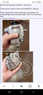

Holysmokes that 60 amp is not cheap. In my 12th year with the $140. Denso
