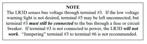

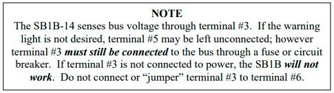

So, opening the Bus-Field Supply via the alternator switch would have no effect if the field wire on the alternator came in contact with the battery lead?
Also, I THOUGHT I remembered B&C stating it was OK to jumper 3 (Since) & 6 (bus field supply) and now they say either don't do this or not recommended?

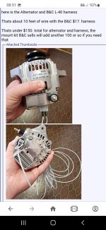

I have an internal regulated Denso on my plane it's been in it since 2015 still working fine and when I turn that switch off that you're saying is not the field it definitely turns the alternator off, you turn the switch off that controls that 12v to the little wire coming out of the back and that alternator shuts down. How do you have it wired so that it doesn't turn the alternator off mine is Wired from power directly from the battery bus and I turn that switch off and the alternator shuts down.
I've read that post that you linked to and that makes no sense to me shuts the master off and the voltage goes to 119 volts that's nuts, something's wrong he didn't have something wired right or had some other malfunction that sounds like full Fielding somehow the only only way to go that high voltage
When I get back home I'll fly it take a video of it shutting the switch off in flight and show you the voltage going back to battery voltage. Here's a link to my alternator it's a very simple 40 amp internally regulated Denso https://www.ase-supply.com/product_p/nd-021080-0760.htm
Ok reread your post, and see you said disconnecting the battery from the B lead is what caused the 119 volts... still sounds strange
Edit one more time thinking about my system again that double pole double throw toggle when I take it from the alternator throw it goes to off and that disconnects the battery from the system, and then I can throw it the other way to battery only, so I've already disconnected the battery and goes right back to 12 volts whatever the battery is at. My B lead is wired directly to the back of the ammeter from there it's wired to that toggle switch the double pole double throw toggle switch that's where I break the connection to the battery I never got no increase of 120 volts whatever that guy did he had something funky going on.
When I turn that DPDT master switch on, one pole connects the battery to the ammeter and bus and the ALT charging wire because its connected to the ammeter. The other pole has a jumper wire from the battery pole providing the 12v power to turn the Alt, throw left alt is on, throw right battery only. When I turn that toggle off at the exact same moment the field depowers the alternator the other pole takes the battery off the b-lead. works perfect
