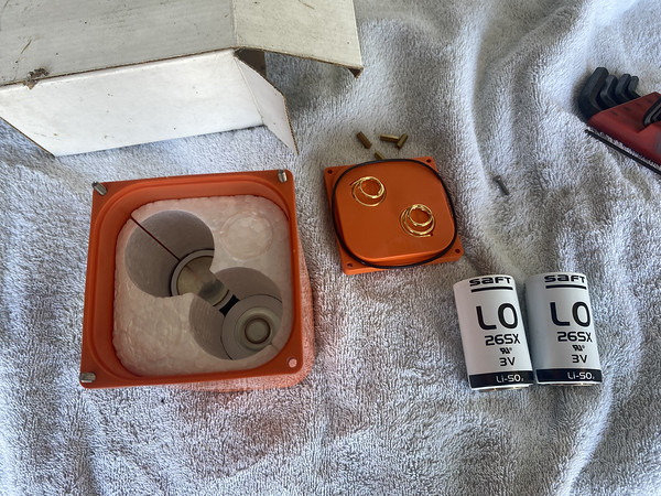

Many of us upgraded our ACK E-01 ELTs to E-04 models for the 406 MHz. While the E-01 ELT used inexpensive Duracell D-size batteries, the E-04 uses a full pack replacement that costs $273 :eek: at AS&S.
After replacing mine recently, I decided to disassemble the old pack to see what was inside, even though there is a clear warning on the pack not to do so. :rolleyes: Here is what I found: The E-04 battery pack contains 4 easily extractable, button-top (unsoldered) SAFT LO26SX 3V 7750 mAh Lithium-Sulfur Dioxide D-size cells, in a robust foam carrier.
These SAFT (the brand name) batteries are readily found on-line in the range of $16-$25. If you believe that as operator of an experimental aircraft you are not bound by the warning, when your pack is due you could save >$150 by doing the swap yourself.

This question has a half life of about six months. It keeps coming back time and time again.
The answer is always the same and will not change. Use the manufacturer's approved battery pack and ONLY that battery pack.
While we all love being thrifty homebuilders, using that approach when it comes to an ELT will result in your aircraft no longer complying with the FARs.
Spend a bit of time with the search function and you'll find multiple threads of this nature, all coming to the same conclusion. There is no grey area in the FARs with respect to ELT carriage.

Here's a photo of the batteries for reference. I took this old pack apart the last time I had to buy a new one just to see what is inside.
I put a voltmeter on the batteries and they are still showing 3V. This pack expired in 2016.

Li So primary batteries will maintain voltage but loose capacity over time.
anybody thinking of doing this had better have a repairmans certificate for the aircraft, because if you do it and bring the airplane to me for a CI its going out the door without a sign-off. thats a risk to my certificate that im not willing to take.

Agreed. 91.207 requires an approved ELT. In this case the approval of the ELT is TSO-C126a. The use of unapproved parts in an approved device negates the approval, therefore such a modified ELT can’t be used to meet 91.207.
I have been searching for some method of measuring and have not found any. The TDS for the battery has some charts but nothing that would indicate a short load test of any sort. I tried on my 2016 and 2022 expired with a .5 amp load test, but both groups tested the same. Both under load and open voltage. No real difference. The new pack had the same voltage as the old packs.
Maybe it takes a digital scope and variable frequency load vs time. ?????
