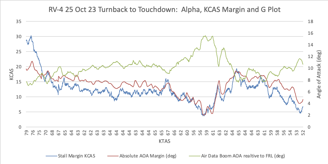

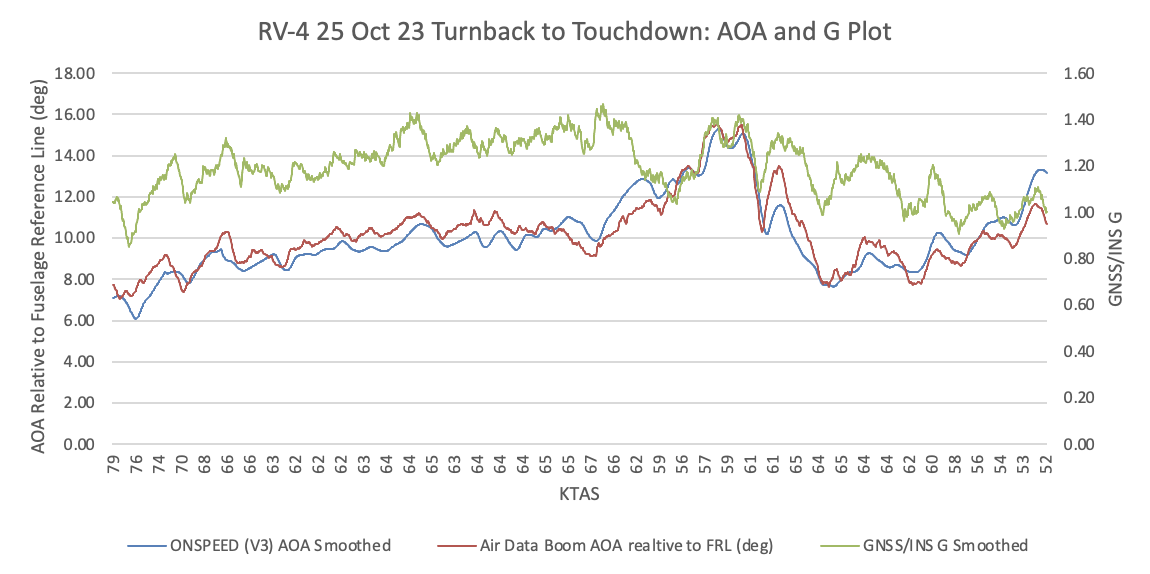

Here's a plot of AOA and stall speed margin from the turnback through touchdown:
In the video, you may have noted the stall warning tone as I “square the corner” (intentionally applying G to bleed some energy). That corresponds with the AOA peak in this figure. Note that my speed margin is reduced to about 4 knots and actual AOA is within 2 degrees of critical AOA.

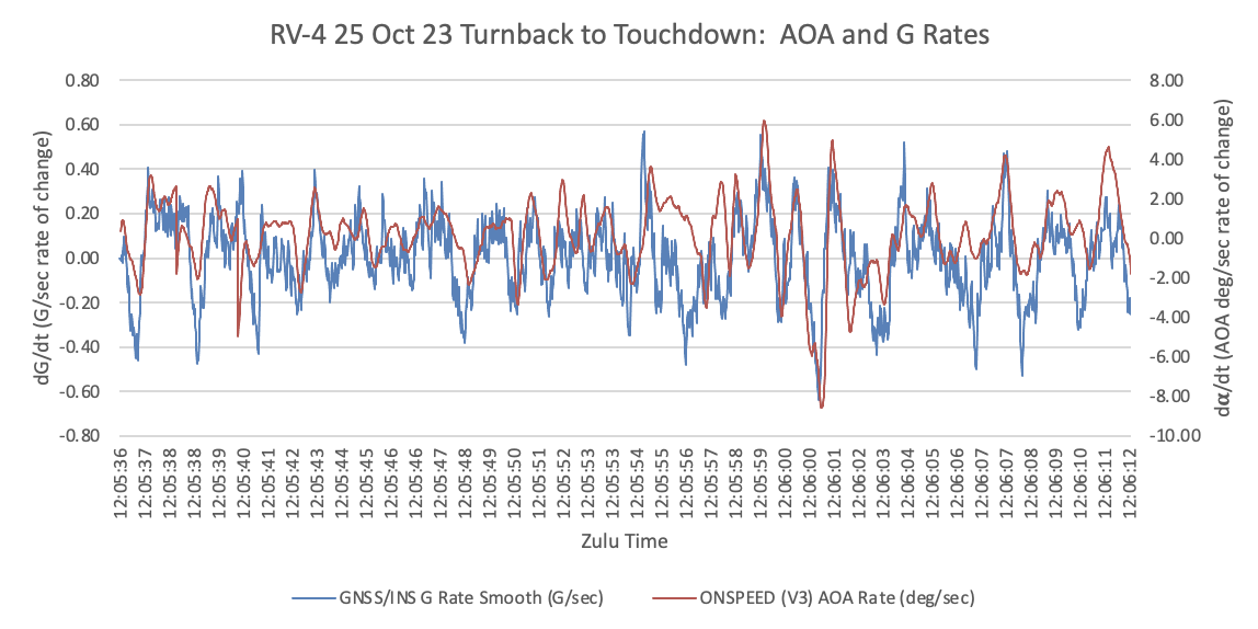

An important concept in aircraft handling is that AOA correlates directly with G. When we apply G, AOA increases. Optimum bank angle for maneuvering during a turnback is 45 degrees, and even in a glide, that’s about a 1.4 G maneuver. It’s this small increase in G that gets folks in to trouble and can lead to an accelerated stall. This figure plots both AOA and G for the maneuver. Note that every time there is a G peak, AOA peaks as well:
Another way to see that is to plot AOA and G rates. Note how the two marry up:

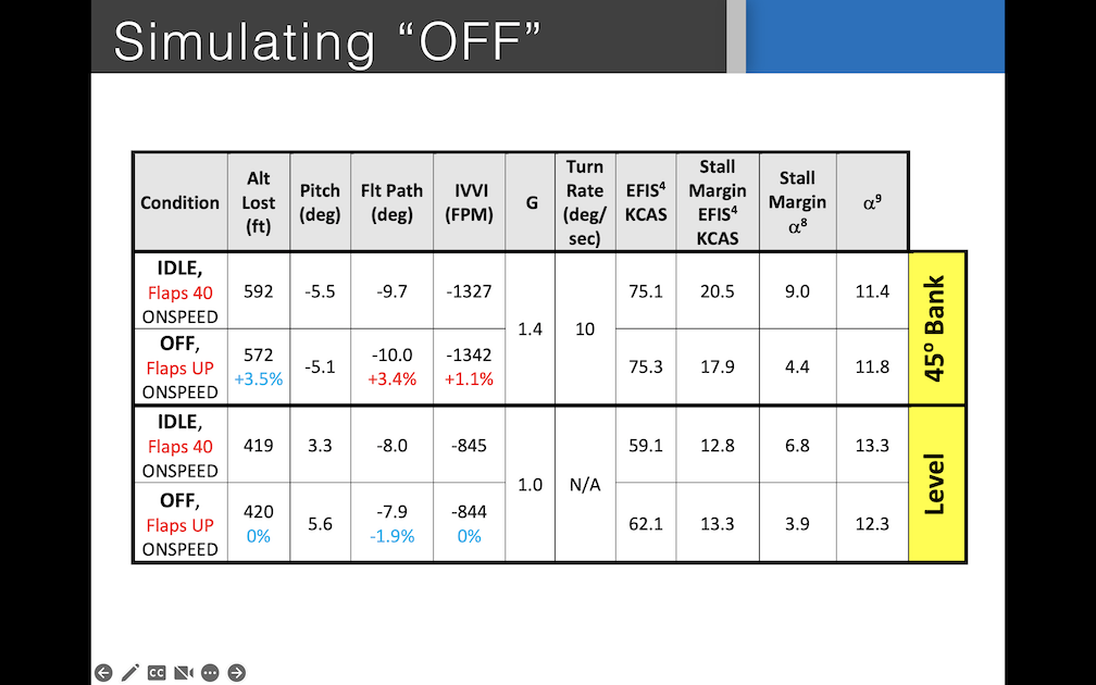

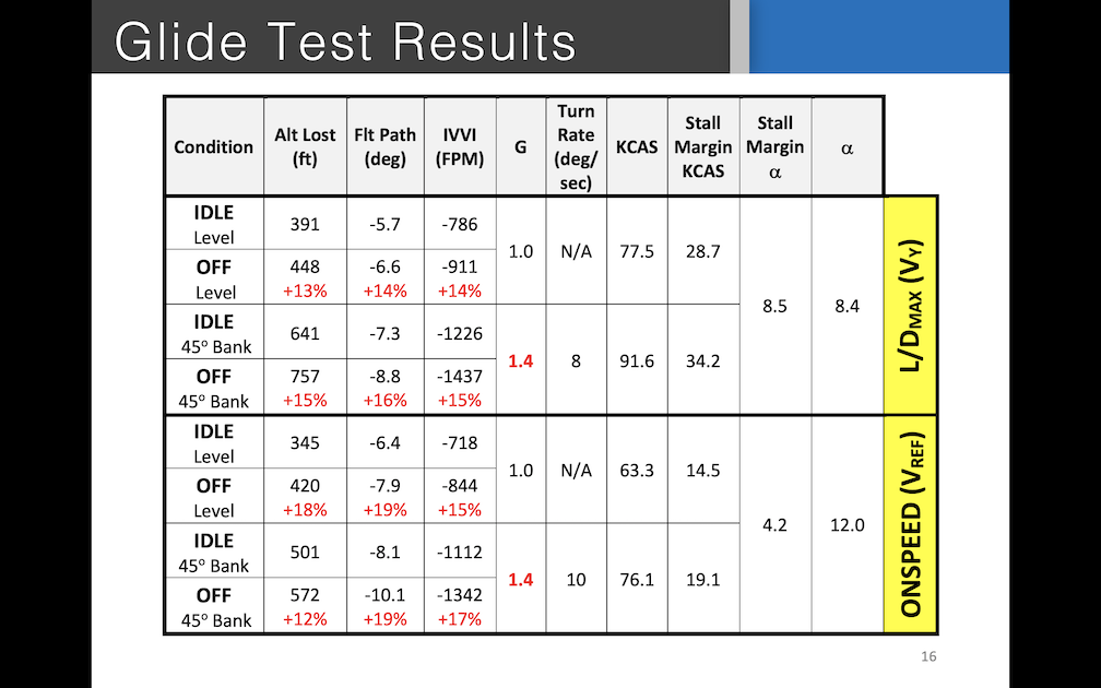

One thing to keep in mind is residual thrust. My -4 ain't a fire-breathing 180, just a milk toast 160 with a two-bladed Catto prop. I'm jealous! Turns out that at IDLE, I've got pretty significant residual thrust:
The takeaway is with the engine actually off, my glide angle is about 20% steeper than it is with the engine at IDLE. We did some additional testing to determine that in my RV-4, if I apply flaps 40 with IDLE power, I can replicate actual engine off glide performance (about 8 degrees, wing's level):

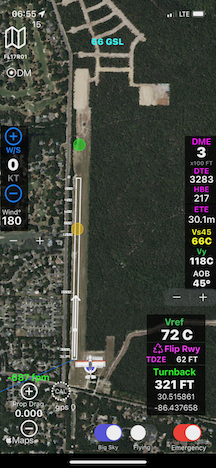

Great discussion!
Everyone brings up salient points! That's why we are studying this and trying to develop planning and training tools that help a pilot make an informed decision for the airplane they are flying under ambient conditions.
The app updates the math once per second. Not perfect, only "about right" but better than a Mark One Eyeball estimate, even if it's just a model. In 30% of the cases we studied, the pilot attempted a turn back below 200 feet AGL. None of them made it. Obviously we can't know what a pilot was thinking, but if someone attempted this, it's likely they hadn't considered the factors effecting performance prior to making that attempt.

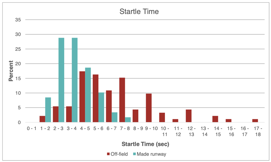

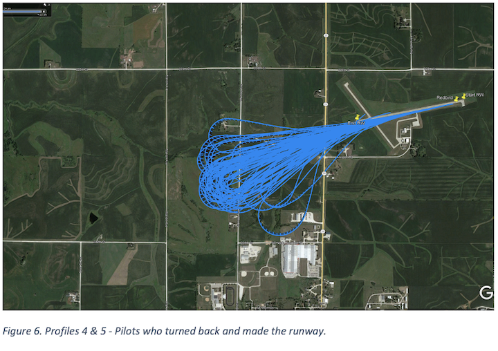

Hi Bob,

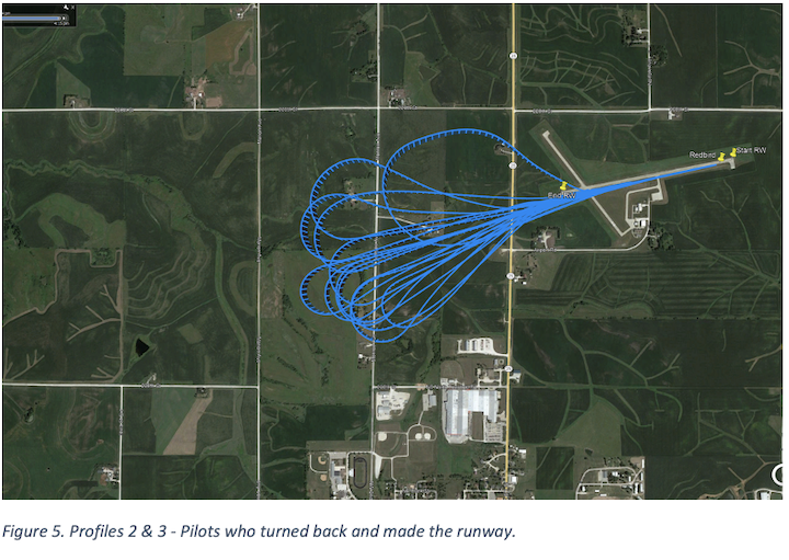

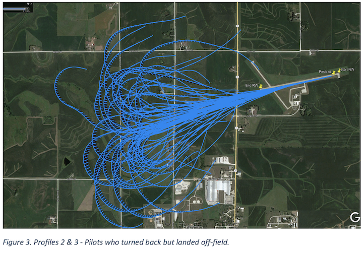

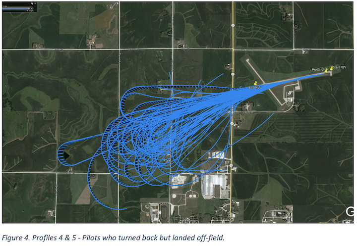

Great point! We conducted a simulator experiment with a cross-section of 90 pilots using a typical GA airplane in 2021. Here is a plot of the startle time vs. success of turn back:
Just like factors affecting V1, we had to decide on some time for flight test. You can see the highest probability of success occurred when the pilot reacted within about 3-4 seconds, but average overall reaction time was slower. We discovered with training, pilots reduced reaction time.
That's the basis for the three-second delay during test. Not perfect, obviously.

Hi Bob,

Interesting data.
Yes, you obviously have to make assumption; as we all know, though, the devil is in the details.
As you stated, the highest probability for success was those who reacted in 3-4 seconds; I would argue that, in reality, the reaction for most people would be longer, in the 4-6 second range. Making that assumption shows that while the turn may be possible, for most people, it will end in failure. Your graph illustrates the point.
Other things I would be interested in hearing is what the test subjects were told, prior to the sim. Were they briefed about test profile, ie "we want you to make the turn back to the runway" or were they left to their own decisions. Obviously, if they were pre briefed that they were to attempt a return, it shortened the reaction time because the decision was already made before the event. Any delay, whatsoever, will push the reaction time into the 4+ second range, with a successful outcome correspondingly lower.
Yes, practice can help reduce the reaction time and improve the skill set necessary to successfully complete the maneuver but I think a 3 second assumption is optimistic.
I also see this in every sim session we do at work. Maneuvers are pre briefed, yet they typically do not go as the briefing specifies. I believe the startle factor is quite a bit more involved than a simple three count. If that wasn't the case, every Upset recovery and V1 cut would end up perfect; in reality, they do not.
One of the best examples is a rejected takeoff. That gets briefed ad infinitum and we KNOW what is supposed to happen and what we supposed to do...and it still doesn't go well every single time.
Again, this is a GREAT discussion with awesome data. I will keep demonstrating "the impossible turn" to my students, however, I use the demonstration to show that in a lot of cases, it may not be the best option.

Hi Bob,
Whole-heartedly agree with you. I was probably one of your sim students :D. Sounds like my general level of performance....
It was a toss-up between probability of success and observed response. With training, we saw reduced response time. The good news is that as I said in the original post, actual parameters in the app are adjustable. All of my testing so far has been maximum performance to make sure we've got the physics right. We'll be doing future tests under varying ambient conditions (wind has a huge impact) and using different, non-optimum parameters to see what's in the art of the doable.
What I like best is the SA I have pre-takeoff. I can make an informed decision based on a real-time assessment of ambient conditions. Here's a screen shot of the pre-takeoff screen. Notice at the start of the takeoff roll, I have a yellow dot and a green dot. The yellow dot is the go forward, stop in remaining runway point (not strictly abort, I may be airborne at this point) and the green dot is predicted turn back point. Predicted turn back altitude for no-wind conditions is shown in the lower right:
Drop me a PM with an email address and I'll share the test report with you if you are interested.

So all of the test subjects had no idea they were being”tested”, and there was no foreknowledge of but they attempted to perform a simulated turn back?
If that was not the case, then my opinion is that the data is skewed.

That is correct. Study participants knew that they were participating in an experiment, and they would encounter an emergency but they had no foreknowledge of the nature of the emergency prior to the first data run (profile 2).
The experiment was designed to not only gather the "going in cold data," it was also designed to evaluate the ability to teach the turn back maneuver. The first profile was simply sim and visual environment orientation. The 2-5th profiles were test runs. The engine failed automatically at a designated altitude. The distance from the field was dependent on the climb profile flown by the test subject. While directed to use a specific takeoff and climb technique, performance varied. Plenty of off-airport landing sites were available, and some folks elected to simply go straight ahead, but a surprisingly large number of folks attempted turn back of their own accord. For the 3rd profile, subjects knew the nature of the emergency, but were given no further guidance. Again, some elected to turn back, others did not. On the 4th profile, subjects were directed to turn back and told what bank angle to use for the turn and what airspeed to fly. A short debrief was conducted after the 4th test run and a 5th run was flown. No instruction was given during any of the runs.
The sim flight model posed some challenges, so the engine failure altitude was selected based on simulator performance. If the subject followed takeoff and climb instructions, ambient conditions were sufficient to allow a successful turn back. The simulator had poor stall modeling (i.e., more forgiving than an actual airplane), and this was reflected in results. Only 15% of turn back attempts during the study resulted in stall, whereas more that 50% of documented mishap turn back attempts result in stall.
These four plots are a good 30K foot overview of results. These plots only show the pilots that turned back on run 2 and 3. All pilots were directed to turn back on runs 4 and 5:

At the beginning of this thread, Vac is doing a turnback using guidance from the TLAR app. Although I'm sure you heard the audio, with the FlyOnSpeed system talking away to indicate optimum AOA, perhaps you should notice two other things. First, his airspeed indicator (round dial to the left of the Dynon D10), and the Dynon D10 itself were both covered over. So he had no airspeed reference. If you view the video again, focus on the AOA display at the bottom of the screen, and watch how the tones change with AOA. Then take another look at the AOA display and look at the number above the indexer. That number indicates the energy state of the airplane, in terms of percent lift being used. There are two points where he uses all the lift, at one point during the turn, and right at touchdown. Here is the link again: https://youtu.be/F_RFKlUhdeE Also, you can click on CC at the bottom for all of Vac's narrative.
