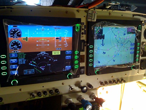

Fired up the panel
Here's my Avidyne PFD and MFD up and running and talking to the GNS430. Looks like we're flying in Kansas . . .
Sorry about poor lighting in this shot with camera phone . . .
