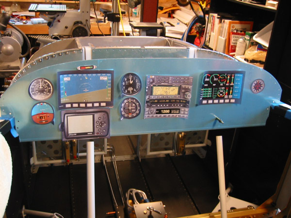

If the panel doesn't have to be finished (or even started), I'll post my preliminary thinking:
Switches will be along the bottom in the middle.
davepar nice cutouts
Davepar,
where did you get the exact size inst. cutouts? I will use almost same inst. in my 8. I need dynon 100 efis and engine monitor. air gizmo/196, dual icom200,audio panel,garmin 327
nice layout.
thanks,
jeff h
I put all of the images in http://www.dualrudder.com/instruments/.
I cut and pasted them from various sites and used IrfanView to set the dots per inch so that they'd print the correct size.
I'm not sure if IE will print them correctly. You might have to save to disk and use an imaging program to print.
Dave

I used this method to get printouts:
1) Go to the vendor website/other sources to find images of the instruments you're looking for. Right click on the image and save it to your hard drive.
2) Once you have all the images you need, use a word processing program (such as MS word) to create a new document. You can usually click and drag the image files into the document and you'll see the instrument there.
3) In MS Word, double-click in the image. Click on the size tab and you'll see that you can set real-world dimensions to your image file.
This works really well and I've found the measurements to be extremely accurate with what I've printed on my office laser printer.
Some things to consider:
Make sure that the image doesn't have some sort of invisible border around it. You can see the border on the image when you select it (single-click) in MS Word. If there is a border, you'll need to bring the image into an image editing program so you can crop out the border. Also try to get the largest (highest resolution) image you can find.
