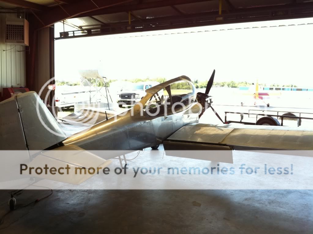

Transformation of my RV-4 to a fastback
For the 18th birthday of N44TK I gave her a little face lift.
I admired Dave Anders RV-4 fastback conversion, done many years ago, and liked the appearance. I know that the Bakersfield area has a number of -4 fastbacks and there have been a number of -4s built from the beginning as a fastback around the country. I never discussed with anyone the process that they had gone through in the conversion of a completed -4. At the end of 2009 I decided I would make some work for myself after completing an RV-12 (N124RN) that was sold and made its first flight Dec 2/09.
I did speak with Axel Alvarez about his -4 build this last fall and followed a few of his suggestions. I basically made the frame fit the Harmon Rocket bubble. I removed all the original 7/16 inch tubing from Van's canopy frame and removed all but about 6 inches of the 3/4 inch square tubing on each side at the rear of the canopy. The major tube bending at the rear of the plexi can be done without any special tubing bender. The sides required nothing special to make them fit the remainder of the frame.
The costs involved, amounting to about $1,800, excluding repaint are as follows:

The process turned out to not be too daunting, but it did keep my airplane down for about 90 days this winter.
The canopy is approximately 4 inches forward of a regular canopy. I chose to do the sides out of .025 aluminum and the front and rear out of epoxy. All of this was fairly simple.
My first flight after completion was March 5, 2010 and was uneventful. I noticed no difference in the handling as a result of the aerodynamics. There was a slightly different sound in flight.

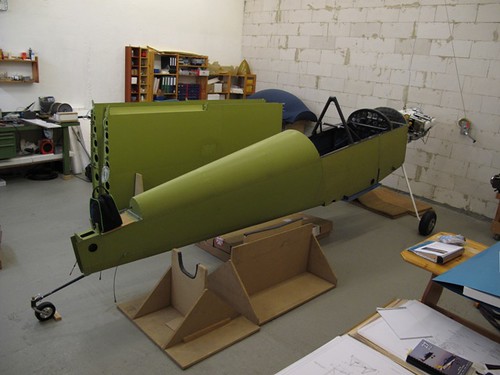

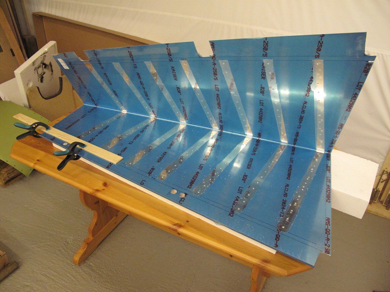

First pics of our RV-4 project
This is first time I try to upload a picture of our RV-4 project. So please be gentle if it does not work out right away.;)
Before Christmas we were working on the rudder parts. The pic shows the moment, when we did the cutouts in the rudder skin. In the meantime all parts were anodised and primed.
It's kind of funny. A friend and myself aquired a part built RV-4. It was scatch built (from plans only!) in Switzerland by a sheet metal specialist. Great work! (I'll post some pics later) Structurally, it's almost finished, except for the rudder. The former builder could not decide if he needed a rudder trim. So he didn't start with the rudder itself. So we could start with the rudder construction as if we started from zero.

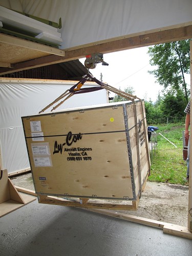

Engine has arrived!
A few days ago our engine has arrived by air freight. We had breight eyes like children in front of the Christmas tree.
Unloading of the crate from the trailer was a bit unconventional. Once the crate was hoisted, the trailer was removed.
http://www.flickr.com/photos/48566804@N00/5890476822/
Engine crate in our farm hangar.
http://www.flickr.com/photos/48566804@N00/5889908679/
Ly-Con built O-360 A1A with roller tappets. It is equipped by 1 MAG and one LSE PLASMA III with the new mini crack sensor. It will get a Rotec TBI for inverted fuel capability. ...yes, we did choose that color of the casing ;)

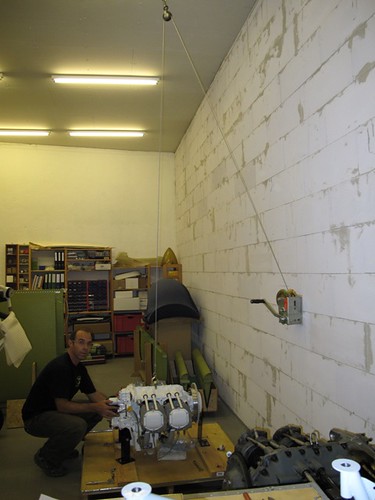

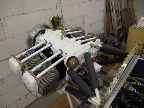

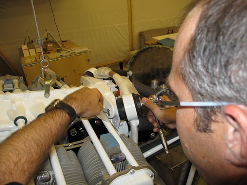

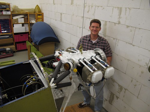

Trial engine hanging
We put on the O-360 on our RV-4 for a first trial fit yesterday night.
We do not have a workshop crane available as it is mostly common. So we hoisted our engine with the fixed installation you see on the pic above and moved the fuselage for alignement.
Markus with aligned engine ready to be installed.
Myself mounting the upper Lord mounts and bolts. We only installed the upper bolts, because the engine is only hanged to get the right positions for all the stuff on the firewall.
Engine is in place. Note the protections on the engine mount for installation.
It was midnight and we called it a day, with a grin on our faces. We placed a bag of lead shot on the tail for safety. Without it, the tail is very light to lift.
Wow!
The resourcefulness of amateur airplane builders never ceases to amaze me!
I've seen them use forklifts to tractor three-point hitches and block-and-tackles over tree limbs, to lift engines.
Nice work,
Nice work,

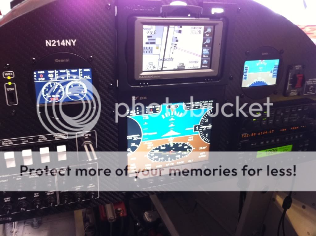

214NY has wings!!!
Got the wings installed yesterday and powered up the panel for the first time (first time IN the aircraft) on Thursday!!!
Andrew,
Where did you source the lettering and pinstripe surrounds for the various switches on your instrument panel? It's an exceptional looking panel!
