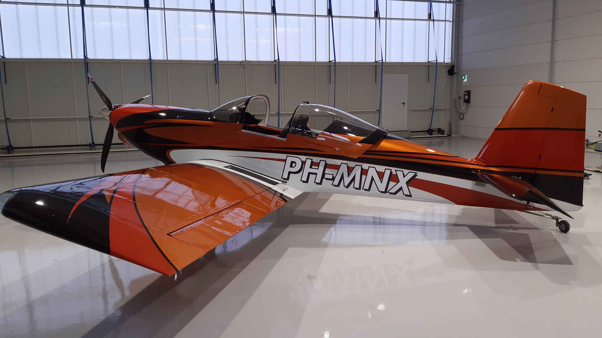

Back from the paint shop and everything assembled. Now the final inspection and Weight and Balance.

Yes it's an Airmaster AP533CTF-SNR67JE, which works very well with the ULPower 520iSA.
It has an electrical governor and can be set to feather. I think there is also one which allows reverse.
That's a really nice looking paint job. Where did you get it done?
The design was done together with Plane Schemer. The paint job was done here in the Netherlands close to Teuge airport (EHTE), by the Boonzaayer brothers. The normally do trucks and tractors, this was their first airplane.
just gorgeous! Beautiful scheme.

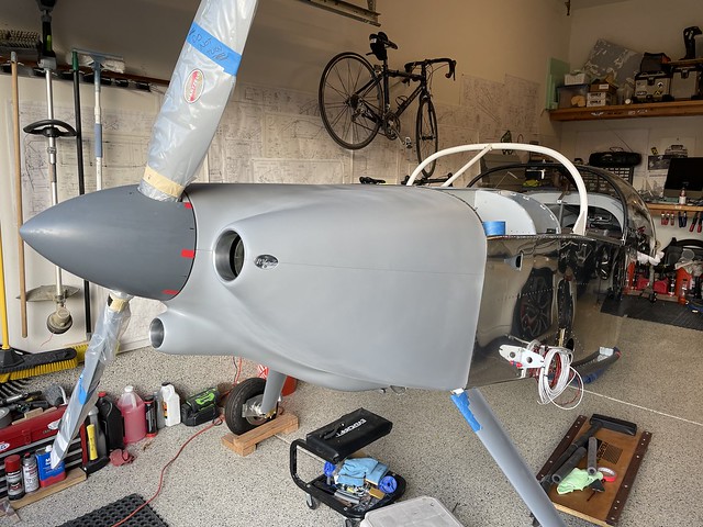

Prop on!
This is one of the more satisfying milestones!
December 1st will mark 4.5 years from the day I started this project.
Very Thankful!

Hartzell spinner question
Ryan,
Your cowl and spinner look great. I have a (possibly dumb) question about the spinner.
The cutouts in the spinner for the blades appear to be very tight to the contour of the blade. What is the range of motion for the twist of the blade and is there sufficient clearance in the cutout for that range? It doesn't look like there's a lot of room for movement.
-Ted
Hi Ted,
That's a really good question, actually. I followed the pattern that was already marked/provided on the spinner by Vans for the constant speed Hartzell. There are areas that have more clearance and I assume that is for the rotational twist of the blades. I've provided a couple more pictures here.
Ideally, if there's a way I can manually cycle the blades through their travel so that I can verify clearance, that's what I would like to do.
Here's my (possibly dumb) question. Do you or anyone else know if I can do this by hand?

Strap a length of 2x6 to one prop blade about half span on both sides of the blade at right angle to use as a lever ( strap both pieces of wood together with the prop blade in a sandwich) . Use about 3 ft of 2x6. Not much force is required on the 2x6 to move the prop blades through the pitch range. I found that taking it in small increments from the full fine position got a good fit with constant clearance for the spinner to the blade. Took about 6-7 iterations of on-off for trimming the spinner.
KT
Ryan.
You CAN rotate the prop blades to test fitting of the spinner.
I clamped two 1'x4'X4' boards sandwiched onto one of the blades about 1/3 way out from the hub. This gives you leverage to rotate the blade. (cant turn by hand otherwise) Go slowly.
Didnt do it a lot, but enough to fit the spinner.
An Hartzell expert can opine if this is a bad thing to do.

Ryan,
Interesting picture. When I looked at it, I thought, hmmm, that engine has the FI spider on the left side of the engine. Then I noticed that the governor line was also on the left side. Then I noticed that the writing on your T-shirt is written backwards. I’m too dumb to know how you did that, but it caught me.
You can manually move the prop through it’s range of control motion with your bare hands. It’s pretty tight, and you can take a couple pieces of wood and clamp them on the blade on one side to give you leverage to move it if you need to. Use some padding under the wood boards to protect the blade from scratches. This won’t hurt the prop. You could also get a buddy to grap one blade in his/her hands, you grab the other, and rotate those blades together - opposite direction of course - you on the left, him/her on the right. It should move, coarse pitch to fine pitch, limit to limit, and give you what you need to determine spinner cutout clearance. If your prop is new, it should be properly lubricated, if not, lubricate it first.

Thanks for the tips
KT, Bruce, Scott,
I just want to say thanks for the tips on how to manually twist the blades so that I can verify spinner clearance. I’ll do that this weekend.
