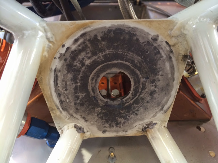

It was time for my 50 hour oil change, so I took this opportunity to inspect the Nose Gear on my RV-10. My RV-10 now has 1140 hours on the Hobbs, about 5% of my landings are on grass runways, some even have rolling mounds like in Port Elgin, Canada (CNL4). I always keep the nose off the ground until full aft elevator won't allow it.
I was glad to see and report that mine doesn't have any cracks in the mount where the donuts rest up against it. However I did see the bolt that goes between the donut shaft and the nose gear legs had signs of wearing. Also the two bolts that hold the gear leg to the mount in two places were also showing signs of wear. I'm going to go ahead and replace these bolts while I'm at it.

From what I see with Rays photos, it looks like a beginner did the welding on the mount. Mine looked similar with 300 hours and no cracks.
It would be great to know when those 4 finishing kits were ordered.
I have seen another engine mount that looks very much like Vic's, but that was after an accident where the nose wheel folded back up under the fuse. There's no way to know if the damage was there prior to the accident.
Our kit was shipped around September 2008. It arrived by sea December 2008 and was flying 28/6/2009.
Oddly enough the cracks visible from above in Vic's photos do not exist in ours.

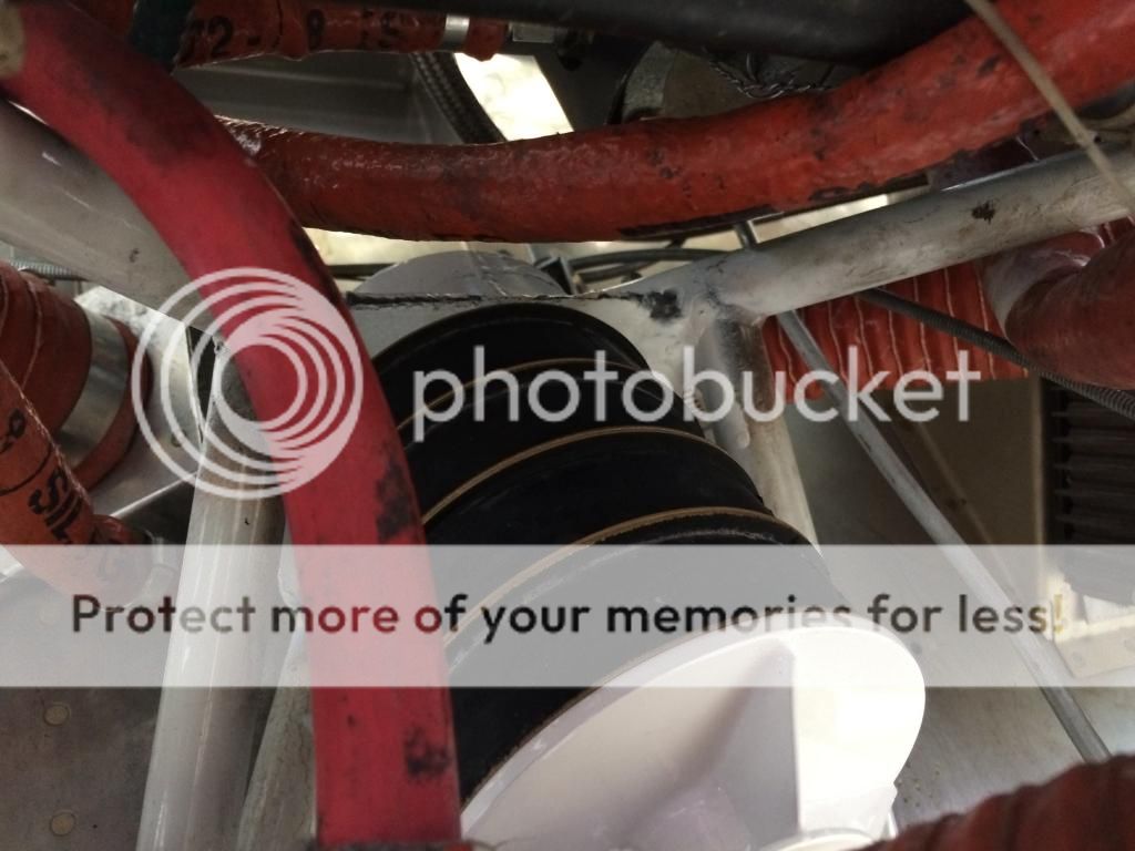

I found some mark on my wd-1016. It look a little bit more than the powder coating. Not much. Is it normal?. It look like it's the area were it rub against de-1001-e elastomer plate.
http://i1377.photobucket.com/albums/ah45/Lan_Vinh_Do/14-08-29/photo3_zpsd87de0e6.jpg
http://i1377.photobucket.com/albums/ah45/Lan_Vinh_Do/14-08-29/photo5_zps552e0e43.jpg
http://i1377.photobucket.com/albums/ah45/Lan_Vinh_Do/14-08-29/photo2_zps658dc6a7.jpg
I also trimmed the plate so it's ready to paint. What paint do you use. I may go to a powder coating shop but if not, what to use?
Thank You

My concern is as the elastomer donuts contract, space develops between the donuts and the weldment when it is unloaded in flight. I have had this happen twice in 300 hours, and had to insert shims to remedy. You can here it rattle during taxi. When this occurs, my concern is that the edges of the new plate insert will rub on the 4 tubes going into the current bracket. We can see this as currently evidenced by the elastomer metal washer today. I do agree that adhesive in between the new plate and the old one may not be the right answer, but using a thin enough layer might prevent this situation from occurring I don't have the answer other than to weld the new reinforcement plate even on the non-cracking mounts.

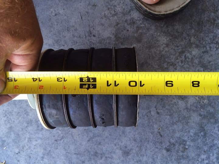

I think the recommendation is to replace if you need MORE than 3.

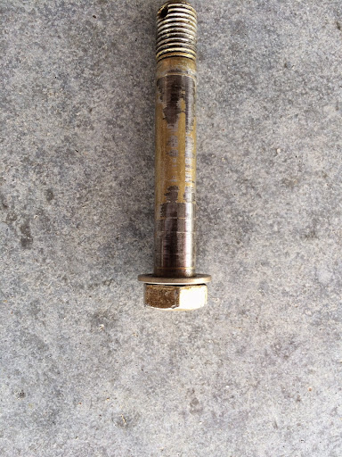

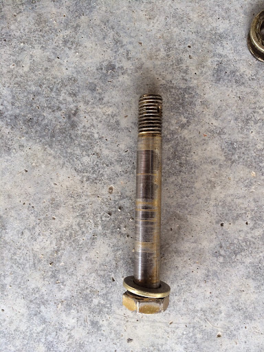

The shaft that the elastomers ride on, directly contacts the hole in the engine mount. The doubler is slightly larger, so there won't be an issue with that.
But, when you look at the shaft, right at the top of the topmost elastomer, one side of my shaft was chafing on the hole of the engine mount. This led to a slight thinning of the shaft in one area. One other thing I noticed is that the shaft had a bit of rust inside.
I believe that: 1) people should prime (NOT liquid plumber, but liquid PRIMER) the inside of that shaft before initial assembly.
2) That shaft won't last forever. At 1070 hours, it's showing wear. I'm sure it'll go 2000 hours. But, since this thing was designed with no replaceable wear surfaces, it won't last forever. I would love to see a sleeve over that part of the shaft, that can be replaced, but doing so would require that the elastomers were made with a larger hole, and the tophat shaped retainer would have to be wider too. So this isn't likely to be an easy thing to fix. So, I think people are going to have to pull that shaft and inspect it (I'd recommend maybe a 500hour inspection at least) and replace as necessary. On Van's end, I'd hope that they keep a dozen of these in stock, because it's going to be considered a wear part on higher time RV-10's. I don't know what that part costs, but it would be nice if there was some sort of bushing there to protect it...either on the hole side, or the shaft side, that could be replaced.

Tim, we had wear, and we bought a new shaft. $145 plus the freight (the expensive bit for us).

When I went to inspect my nose gear mount I noted that I did have play in the assembly and that I hadn't checked this in previous condition inspections even though I had removed the wheel each time. I just didn't have it in my checklist.
Yes, I think it's important.

I'm thinking about riveting the doubler to the top most elastomer to keep it centered and to make for easy inspections. I also believe the correct pre-load is very important to keep all the stack up parts free from slack. What ya think?
I felt the doubler needed to be fastened in some way. I really think it will move around and beat up the welds at least. I used Hysol when I put it back together. Just a thin coat on the plate and it oozed out nicely all around.
I had another drink, and decided that it would probably be better to put a couple roll pins in the doubler and two locating holes in the plate to keep the doubler centered; hopefully the per-load will keep everything tight.

Though mine was cracked, it looks like it takes awhile. First the plate slowly deforms, then hairline cracks form (I had 2 hairline) and then the cracks slowly open up. Of course I didn't see this actually happen but that's what it looks like.
Looking at pics of a very badly cracked plate, my guess is that the damage will progress until the plate starts to break into pieces.
Again, I think the critical issue is the presence of play between the plate and the elastomers. I set it up once and never checked it again in 3 years. At year 2, I discovered a cracked nose wheel. I can say with certainty that my plane has never landed nose wheel first or otherwise experienced any trauma to the landing gear beyond operations on my home strip.
