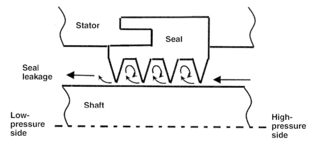

I decided to start sealing behind the spinner, pink foam cut out with a jig saw and epoxy/micro'ed onto the cowl. Im making the front hole behind the spinner smaller and adding a 90* flange with 1/2" clearance from the prop spacer. I'm thinking I can make the seal with 1/2 foam weatherstripping from the cowl flange to the prop spacer or some rubber baffle material from the cowl flange to the ring gear support.
True-ing up the front hole with a 7 inch circle routed from a 2x10.
I used a ring of baffle material with radial cuts to allow it to conform to the prop shaft. I wrapped stainless tape around the shaft for protection... Make sure you overlap the tape correctly by wrapping it in the same direction the prop turns.
Baffle material was attached with screws to the balsa/fiberglass closure on the cowl, similar to what you did.
Thanks for the advice Vern!

I'm attempting plan B with a foam seal around the prop spacer, any advice please do tell. Foam seal on the cowl....

I've never seen foam used on a cowl like this for sealing the propeller shaft. What about heat build up on the shaft from rubbing the foam? Seems like you would want to minimize that. What about shaping a really low density foam to have teeth like a labyrinth seal to minimize contact but still providing a seal? or just eliminating the foam, you have a low diameter gap which is good and will minimize leakage.
Good ideas Steve!
Honestly I won't be too surprised if the foam removes itself in one fashion or another, but on the other hand I think it has a chance at working. I'm anticipating the foam to "wear" into shape rather quickly, I should know after the first test run. If it does create too much friction I could modify the seal as you suggested.
My other thought would be to glass in a flange around the spinner to parallel the landoll ring and use baffling material from the flange to the outside of the landoll ring.
I'm not sure I've closed the gap at all, any air escaping still has to exit the 3/16th gap between the spinner and the front of the cowling. I'm not sure making the hole smaller upstream from the spinner gap changes the amount of leakage or not.
