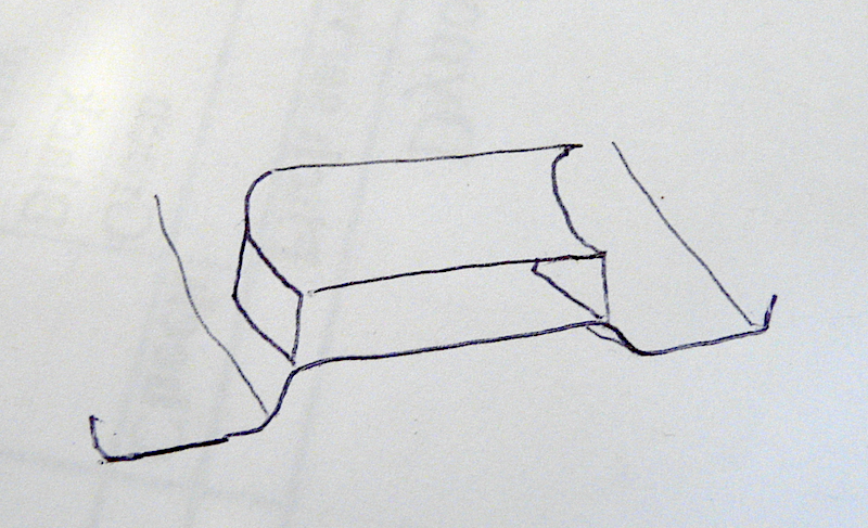

The lower contoured line is the aft edge of the lower cowl, forward to the upper left. The depressions at the outboard ends are for the exhaust pipes. The stuff in the center is the duct, raised on walls that form a tunnel. Hard to radius the forward edges of those because that would interfere with the exhaust. The radius is the front part. The aft edge would need to stick past the aft edge of the lower cowl and press against the titanium belly overlay, but any fasteners would protrude into the cabin floor, an ungood thing.
I seriously doubt that I'll build this as sketched, but it's one way of doing it.

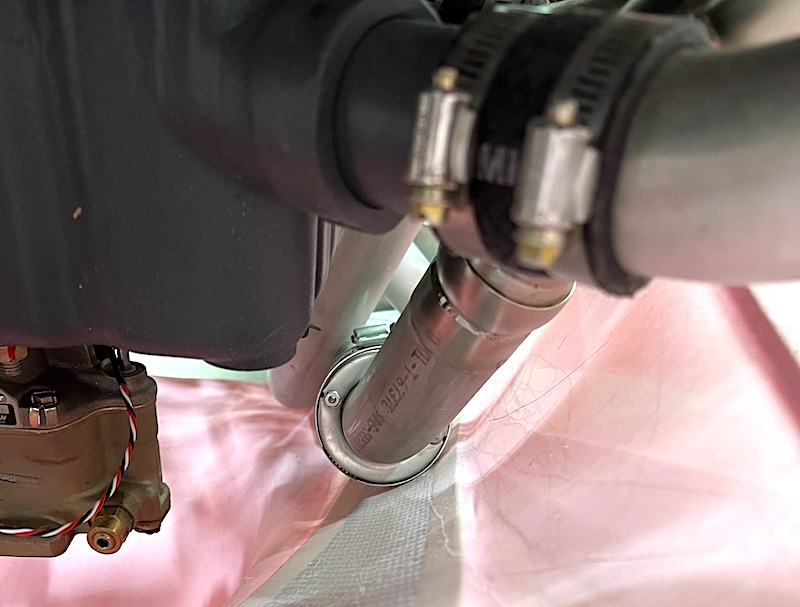

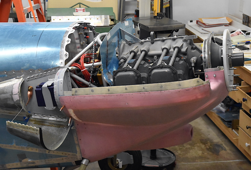

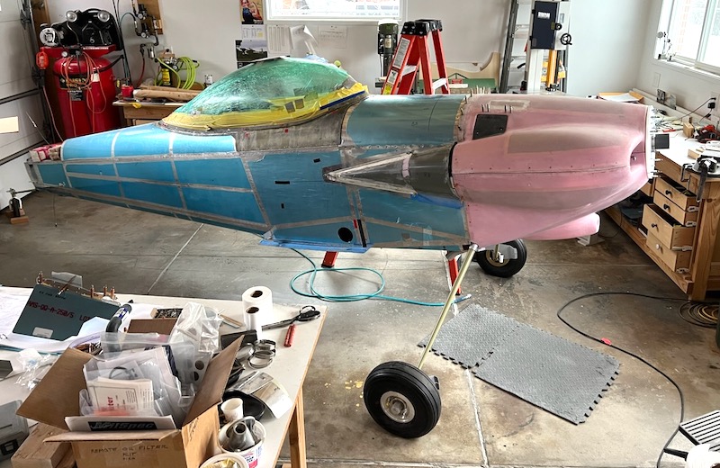

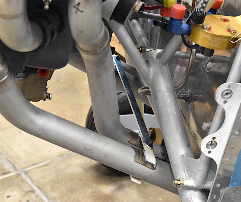

I fitted the turned-down tips to the exhaust. The hose clamps aren't on yet.
Here’s a side view.
The oil door wire pull bracket was too high and would contact the engine. I eliminated it and just clecoed on a bit of piano hinge.
And it’ll fit! Plus, bonus, it works!

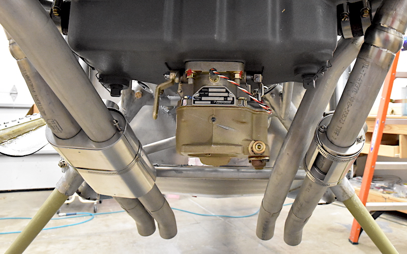

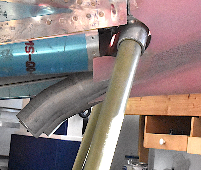

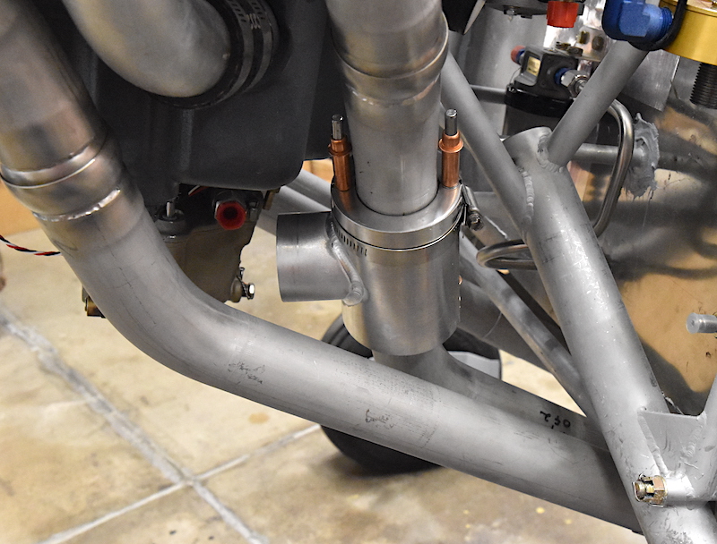

Next, the cabin heater muff and carb heater muff got a trial fit.
The cabin heat muff only fits on the right side (left in the photo) but the cabin heat valve aims off to the left (to the right in the photo, out of sight on the firewall). All the cabin heat hardware is 1.5” except the inlet, on the right aft baffle, which is 2”. This isn’t currently on the engine. I can change that diameter. There would be a very long SCAT hose to the valve, though, due to its orientation.
The carb heat muff fits best on the left side but touches the lower cowling. I think I can relocate it and avoid that interference. The muff’s inlet is that opening on the non-hose side and takes lower cowl air. The hose will have a fairly direct path to the FAB, eventually. This hardware is for 2” SCAT hose. This shows the misfit at the cowl, where it's touching.
And here’s a shot of the relocated muff, with the outlet opening aimed at where the FAB connection will eventually be, an altogether better location.
Haven’t attached the exhaust pipe hangers but I’ve looked at them. I’m still working on the cowl, after all.

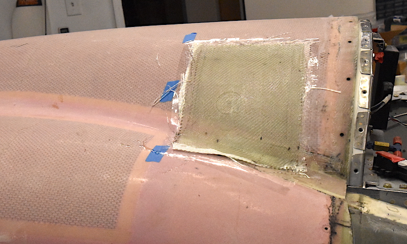

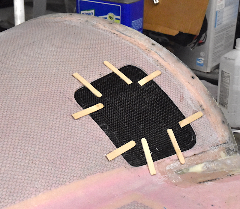

On the cowl, I added one layer of glass to the top cowl’s aft edge on both the inside and outside. Partly it was to toughen it and partly to cover some carbon.

Got it from Robbin's Wings, here in Colorado, a few years ago. I don't know if they are still in business but they no longer seem to have a web site.
Richard Robbins
Robbins Wings Inc
7087 W. 94th Ave
Broomfield, CO 80021-4818
303-423-7002 (?)
The aft-most tube of that muff isn't exactly aligned conveniently.
At the time, I had a concern that some of the smaller vendors would retire and close. Apparently he did. Where I knew what I wanted, I went ahead and bought the products. Good timing, as some of these things aren't available now.
Dave

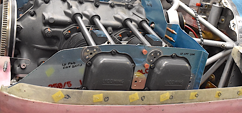

The seat cushions arrived, un-upholstered, from Oregon Aero for a test fitting. They need a fair bit of rework, so it was good to have them to assess what’s next. They are now back at Oregon Aero. If you’re considering custom seats, consider adding two or three iterations of shipping to the estimate.

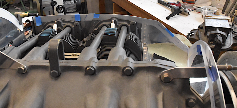

Continued tweaking the cowl, and like many of you, it’s a frustrating experience for me.
Then I had a bit of inspiration - since I was taking the cowl on and off so much anyway, why not use those cycles to trim the baffles? Turns out that although the baffles are a welcome change from the fiberglass, they are mutually incompatible. - if the baffles don’t fit the cowl won’t, and then there’s no cowl work to be done. I started by omitting the forward half of the baffles because they won’t go on without trimming. The back ones will since they only contact the upper cowl.
After some trimming (and over-trimming the RH aft piece, replacement part on order) I was ready to try the paperclip trick. Here are some paperclips after a couple of cycles of measuring and adjusting. I learned some things about this.

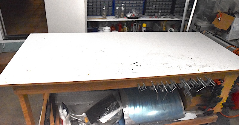

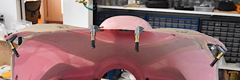

1. I didn’t know if a standard paperclip would work so I got large. This proved a reasonable idea.
2. As you can see, I am doing this with the blue vinyl on. This gives a somewhat slipper surface for the paperclips to grab, and I had to slightly bend each paperclip to increase the grabbing force. Paperclips might work better on bare aluminum.
3. The paperclips tend to bend over sideways. Measure from the apparent surface of the cowl to the baffle. Instead of measuring in a vertical direction, the measurement is perpendicular to the baffle contour line.
Since I was afraid of over-trimming other pieces, I took it slowly. Slowly, in this context means lots more reps of measuring, trimming, reinstalling paperclips, fitting the top cowl, repeat.
For me, trimming was either with snips or the bandsaw. For most cuts, the bandsaw was much easier. For short fairly straight cuts, and there weren’t many of those, snips worked perfectly fine. If your snips cut .032 aluminum like paper, hey, go for it. For mine, .032 is close to the limit.
So far, I haven't the slightest idea where I'm going to mount my non-standard oil cooler, except that I'm hoping to put it forward of the firewall.
Dave

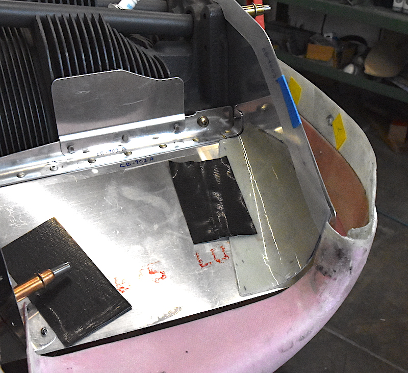

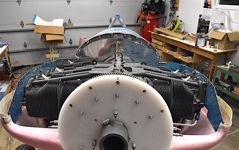

I somewhat over-trimmed the aft right baffle and had to order a new one. It came with none of the blue vinyl, just bare aluminum. I trimmed that one and finished trimming the sides. Still haven’t started the front pieces. Heres the bare naked replacement baffle in place.
In the middle of the trimming. Still using the paperclips.
Since this is an RV-3B and has the cowling cheeks, the side baffles get narrower than for the side by side models. The side baffles have a joggle at the top where the aft side nestles into the front side. In my case, I trimmed them off, and then used some magnets to hold the front and back sides together. The orange magnets are merely tooling here.

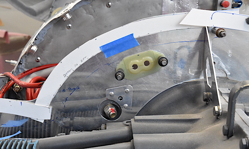

My Vetterman exhaust system uses a horizontal cross bar to stabilize the four pipes. I have it in place here, temporarily. The fixtures to something above that keep the assembly from falling down are not yet installed.
These are here to align the exhaust so that I can build the glass fairings on the bottom of the cowl for them.
While I was doing all that, I was thinking about how I’d actually make the fiberglass fairing where the exhaust protrudes through the back end of the cowl, one of the many things I needed to figure out for this airplane. I looked through my handy collection of photos and saw numerous shape variations, and my mentor recommended the absence of a fairing - which has it’s attractions. Ultimately I cut some pink foam into strips as a starting point. Here are the foam strips.
Dave

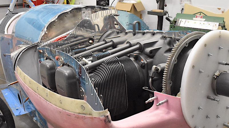

With the lower cowl off, it was time to play with the #1 cylinder forward baffle. This is the one with the oil line to the governor. The constant speed prop I intend to get for this airplane is causing a lot of hassle, sure would have been simpler to plan on fixed pitch. Wirejock sent me a photo of the slot in his to allow for the oil line and I decided to do something roughly similar. His slot was from the aft side to the access hole. Mine was from the inboard edge to the access hole. You can see the support bracket almost hidden underneath.
In place without that bracket. Eventually I'll use #6 screws there, same screws as for the seat pan.
Not shown, I need to make a removable cover to block the slot I just made after installation. Wirejock avoided that; his is a more straightforward approach. Mine is easier to install.

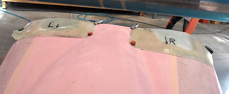

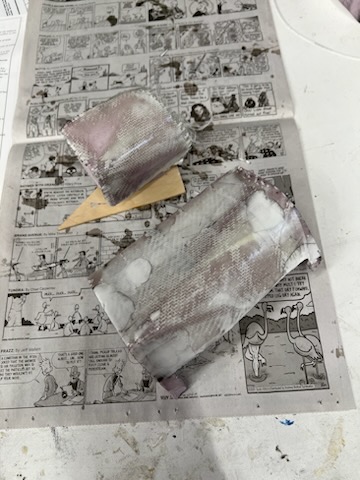

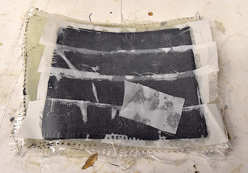

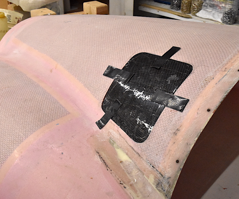

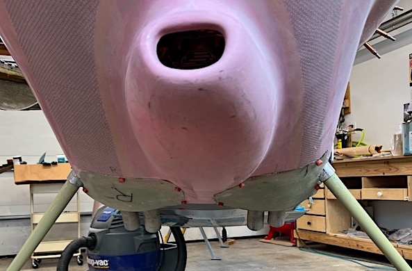

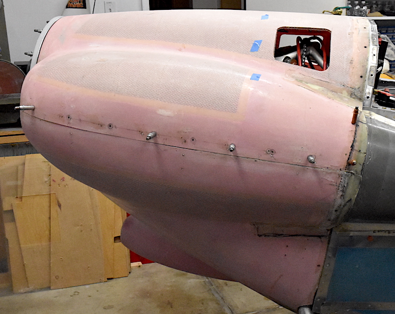

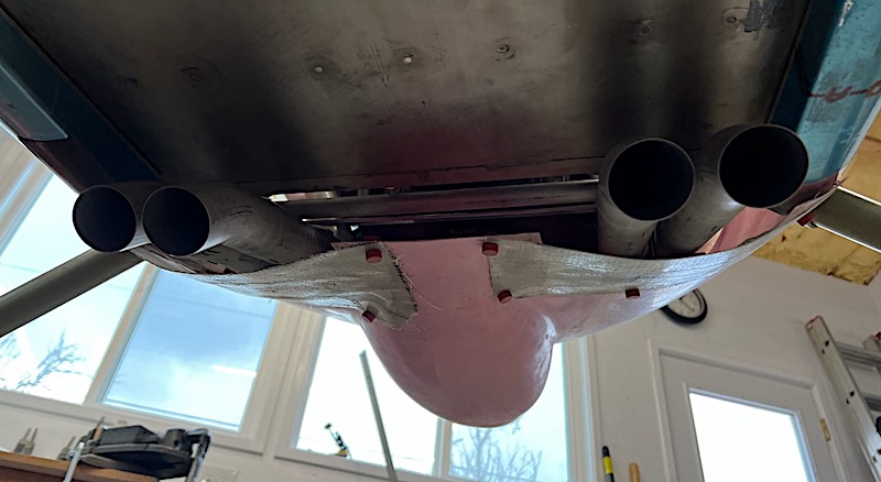

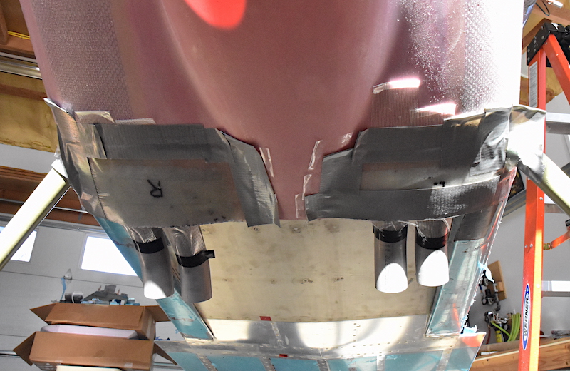

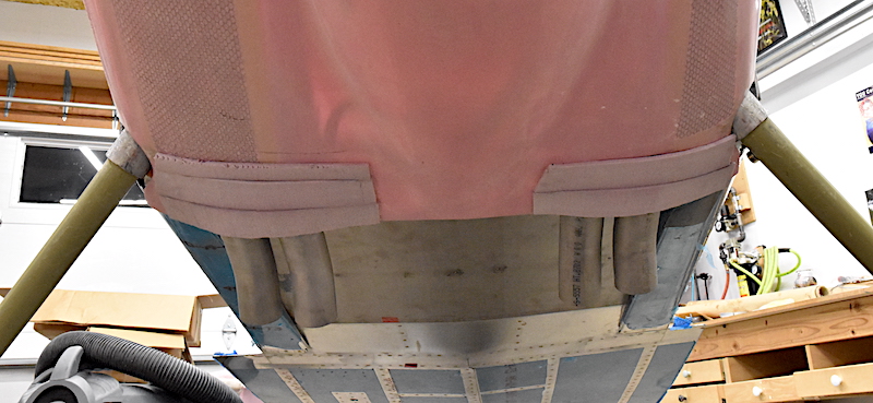

After sanding down the exhaust fairing foam, I taped it using packing tape so the fairing itself would release. The tape was placed in a way that bridged some of the poorly-sanded areas.
Then I laid up the three layers of glass and, just to make sure they wouldn’t fall off since I was working upside down, taped them in place. Duct tape releases too, on both sticky and smooth sides.
Here they are on the cowl, with the cowl on the bench, before trimming.
This shows the contour from the aft side. The cowl has not been trimmed yet.
I replaced the cowl on the plane and held the fairings in place. Turns out that there is insufficient gap between the fairings and the exhaust. Okay. That was all a good exercise and demonstrated a satisfactory approach to making the fairings. Now to go add some clearance and re-do them.
Dave

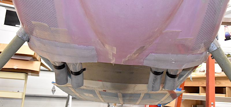

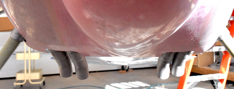

On the re-do, the third left exhaust fairing was fine. The third right one wasn’t quite the way I wanted it, so made a fourth one, which was fine. Here they are held in place with magnets.
And
More recently, they are now glued on, and I’ve trimmed to fit and added the glass over the joints.

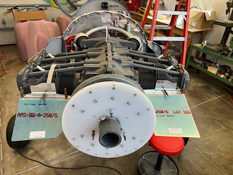

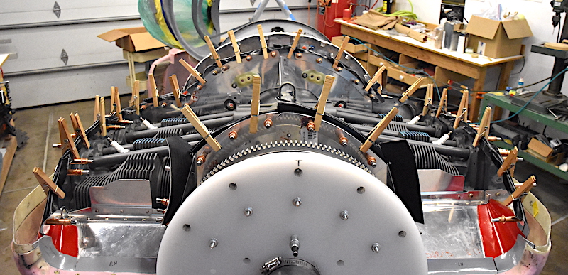

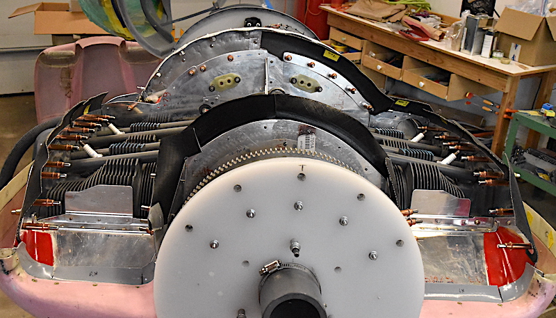

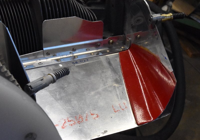

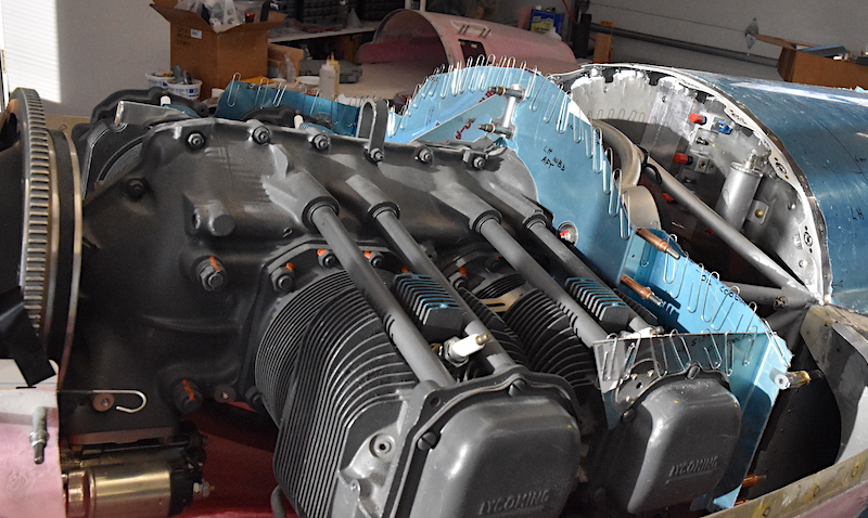

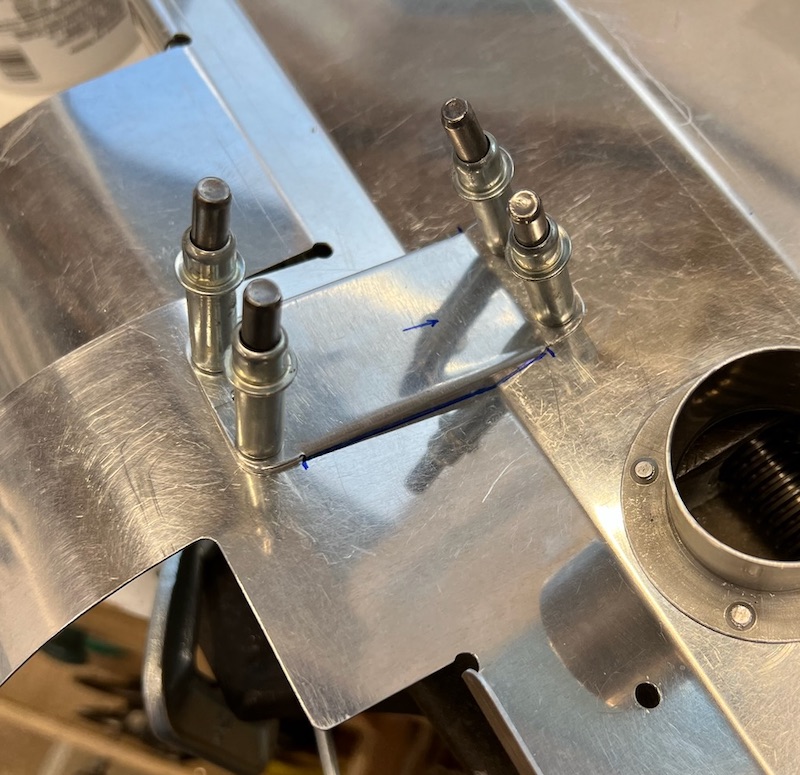

Now that the exhaust fairings are on, I decided to attempt to trim the front baffles. This is a bit of a conundrum, since I couldn’t put the lower cowl on with them in place untrimmed, and couldn’t mark them without the cowl in place. Russell Thomas was kind enough to offer some tips and ultimately it only took an afternoon. Here are the before and after photos.
And
https://i.imgur.com/KfE9pWR.jpg[/IMG

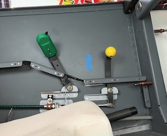

While I was checking the seat cushion fit, I took this photo. Clearly there’s some work ahead.

Lately I’ve been working on the baffling and the third seat cushion trial. The seat cushions are getting fairly close now but we anticipate a fourth fitting before the upholstery is applied. Oregon Aero sent me a generous sample of the sheepskin since that’ll affect the heat to canopy clearance and a few other smaller things. The sample they sent is about the nicest sheepskin I’ve ever seen. It’s very impressive.
I was able to lay one piece on the seat cushion and another on the seat back cushion and try that out. There were some differences compared to sitting on the same foam without the sheepskin, as you’d expect, but overall a rather significant improvement. Unfortunately the black samples they sent don’t photograph well. It’s too flat and unreflective. Imagine a black hole and that’s what the photo would show.

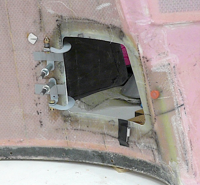

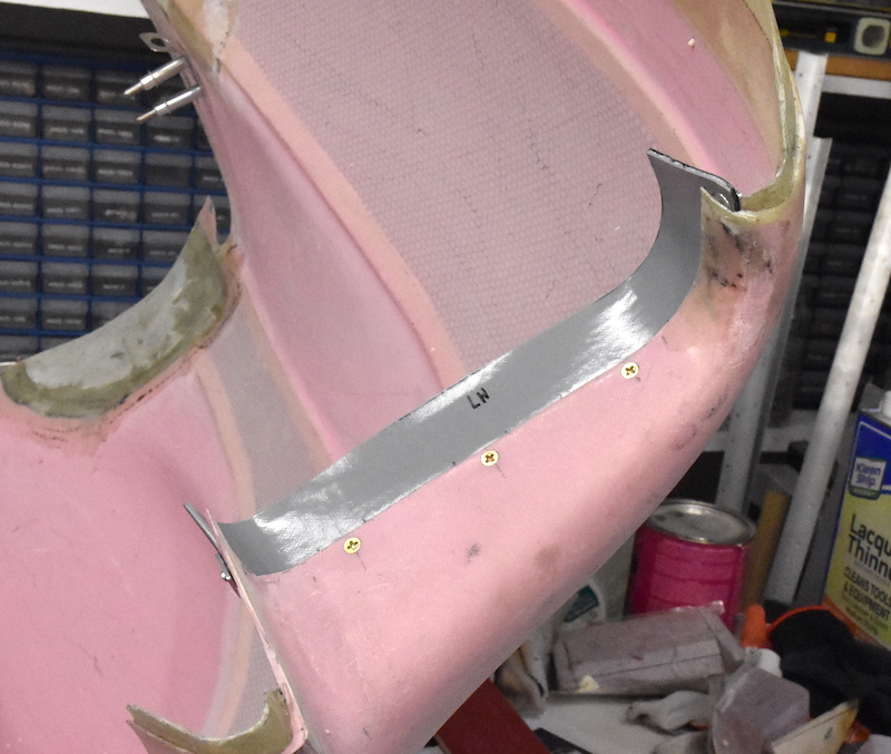

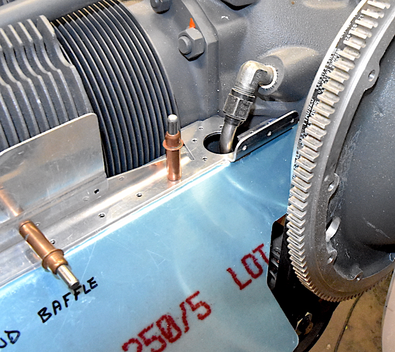

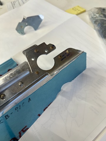

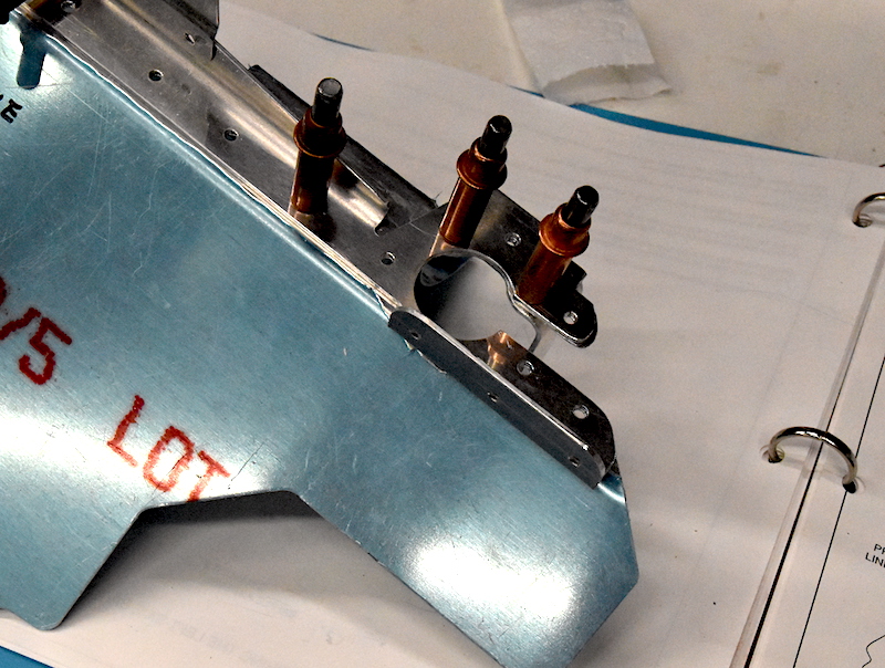

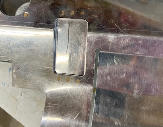

The front right baffle has a hole for the prop control oil tube. I made an access slot so that I didn’t need to remove the tube if I wanted to do something to that baffle. Here’s the hole in the baffle.

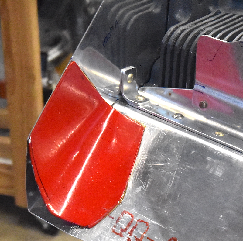

It needs something to fill its slot up and block the air gap, so I made a simple .016 cover attached to the support that screws to the engine.
Here’s how they go together. I’ve had that baffle on and off a few times since. Yes, the grommet isn't in yet - I know.

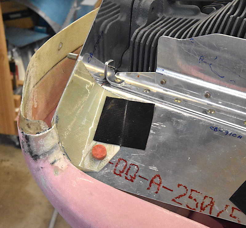

The two front baffles needed conical-shaped fillers to blend the outboard corners of the lower cowl’s air inlets to the baffles. When I thought about that I realized why the baffle plans had mentioned something about curving the side front baffles inward a bit. Unfortunately I realized that after I’d made the flanges that connect those side baffles to the front baffles, and it was too late to bend them in. What to do?
Now that I’d unfortunately built in a bit of a gap between the outboard lower cowl side corners and the side baffles, I decided to replace the conical filler pieces, which were aluminum, with fiberglass. Here are the female molds in progress. At the moment they are a little closer to being used.
At that point, with epoxy curing, I got involved in stripping vinyl and deburring the baffles.

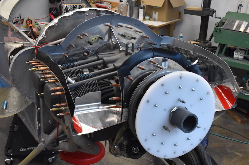

Those conical filler parts are ready for installation.
And

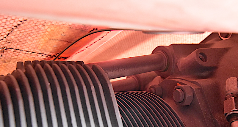

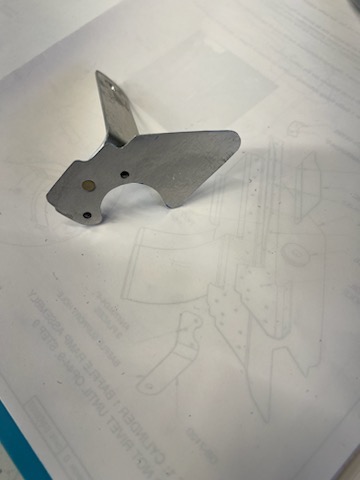

The No. 3 cylinder has a spot that needs a bit of a bypass due to poor cooling fin design. Some bypass methods are to simply stick a washer in for spacing, other people make fancy devices. Here’s mine. It took some figuring and thinking to get it in the right position. The position might not match other builder’s installations but please remember this is an RV-3B and it’s often different. Wouldn’t have thought so for this sort of installation but this position is correct for this airplane and engine.
And in the front,

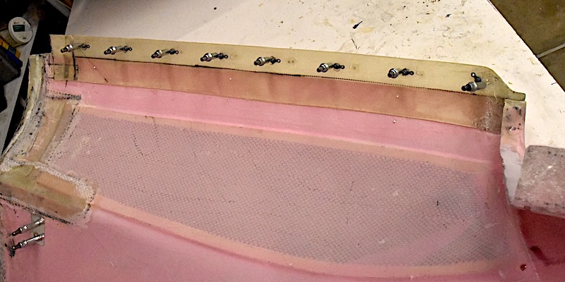

I got one of the ignition holders in, the one on the right side. Also, you can see some of the semi-trimmed baffle seal retaining strip templates being fitted.
kI7RGod.jpg.

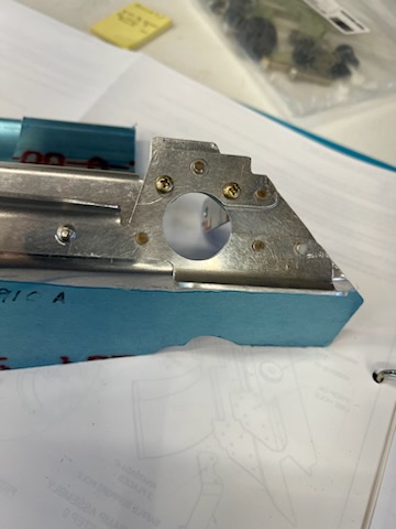

The screws have nutplates, and while it would have looked cleaner to have the holder behind the baffle, this is a lot easier to remove if that should ever be necessary.
Haven’t done the left side yet. The baffle seal retaining strips are nominally 3/4” wide and in some areas as shown here, somewhat narrower. They will need to be thicker than the standard .032 in these areas.
I bought some of McFarlane’s “Cowl Saver” baffle seal material for this. I chose that because I rubbed a sample of it, Van’s standard baffle seal and some red silicone baffle seal against some of the fiberglass cowl, the lower friction of the "Cowl Saver" was very obvious. Also, I'd used the red silicone on my C180 and it just isn’t lasting as well as I’d have hoped, plus it’s clearly wearing the cowl. I plan to replace it with some “Cowl Saver” one of these days.

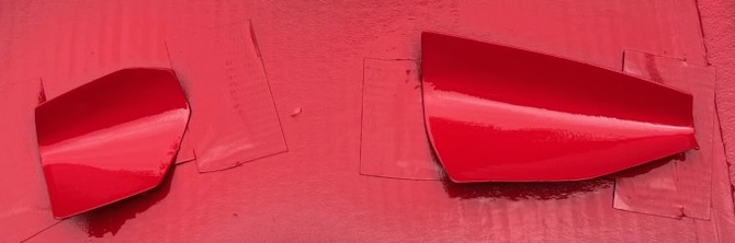

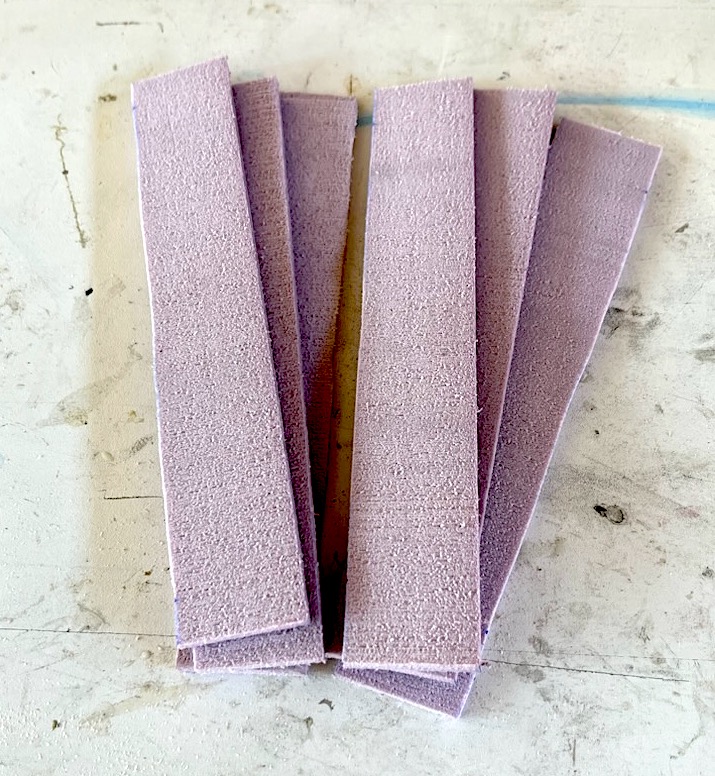

I decided to paint the conical spacers before installing them because it was easier. I used Stewart Systems. First I primed with EkoPoxy primer, sanded, filled a little, and reprimed. When I was satisfied, I top-coated with their EkoCrylic, in Firethorne Red. Right now they are drying. My intent is that the fuselage will be this color.
I had to tape the cones to some cardboard to keep them from blowing away.
For those of you who are aware that Stewart is out of EkoCrylic (June ’23), they still have some in 8 oz. packages, which is plenty for this.

A close look with them now dry, shows a few pits in the paint, not exactly pinholes but similar. The epoxy primer I'd used under the red is white. Turns out that there is insufficient contrast for me to detect this sort of flaw in bright sun.
For me, the take-away is to use gray primer on fiberglass, correct any defects, and then a coat of the white, followed by the red. When I finished the inside of the canopy frame/fairing, I could readily see defects in the gray.
