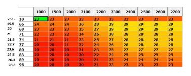

The controller is temporarily connected to a laptop via USB for setup and entering advance maps. It holds two maps, switchable in flight with a simple toggle. I keep one map set for fixed 23 BTDC, and experiment with the other. Here's the current advancing schedule. I've not changed it in quite a while.
Data entry is just fill-in-the-blanks on the laptop, manifold pressure increments on the left (inches of mercury and kPa), RPM increments across the top, timing in the grid. The controller extrapolates between points. The 10 kPa line is set at 23 across all RPMs so a MAP sensor failure cannot cause a timing advance at any throttle position. Max advance is 29 BTDC, based on flight test. Remember, this a 390 angle valve. The angle valve does not respond to advance like a parallel valve.
How do I know? I can switch from 23 fixed to an experimental schedule, observe the results, and go right back to 23 at any time.
Cruising at peak EGT and 2400~2450, there is no practical difference between a typical 28~29 per the above, and fixed 23 timing. The advanced schedule is used to run significantly LOP, but I rarely do so. Yes, I know the arguments, but running 8 knots slower to save less than 3 gallons on a three hour tour just doesn't float my Minnow.

This is very similar to the curve I developed. When I built my -14, first time builder, my interest was the educational part of EAB. At the time I had no background in ignition advance so I did what many in this community do, I asked questions and tested. I did about two hundred hours of flight testing and loved every minute of it, I’m still learning!
The two most important things I learned is that to truly take advantage of a variable timing ignition, in an airplane, one needs a minimum of two curves. My personal choices will be defined below. With one curve there is a compromise either ROP or LOP at the owners discretion. The second thing I learned is a parallel valve (PV) and an angle valve (AV) engine are noticeably different. A PV advance curve will generate unnecessary CHT temps on an AV engine.
What I learned after two hundred hours of joyful testing is that I could have copied DanH and gotten VERY similar results. Somehow, I have the curve that toobuilder uses. I don’t know if it was posted here or we communicated privately, I do know I have never met him.

1800-2700RPM 23 BTDC
Curve 1 is my takeoff and normal climb ROP flight condition. The difference between that curve and DanH is two-fold :
(1) My low power settings simply allow the engine to run a bit smoother on the ground; has no bearing on efficiency, but the capability is there so I took advantage.
(2) for any Manifold AIr Pressure (MAP) at and above 25.1 I decrease the advance by 3 degrees. In other words, my takeoff, initial climb, and balked landing/ go around are automatically set to the Lycoming value of 20. Again a personal choice that was available so I used it. I believe Toobuilder is even more conservative at 17 BTDC?
Curve 2 is what I use for Lean of Peak (LOP)
LOP can be a bit tricky, I found minimal advantage to shifting the curve unless I am leaner than 25LOP. Therefore, when I fly at PEAK I use Curve 1. At 50LOP I advance to 28 BTDC, at 100LOP I advance to 30 BTDC on the exceedingly rare occasions I fly at 150 to 175LOP I advance to 32 BTDC. At that point the airplane is burning insanely little fuel and also going slower than any reasonable RV owner would choose. Beyond 175LOP I get roughness.
Last point: The manufacturer of my system has an automatic program that in the event I am flying on Curve 2 and exceed 25MAP the ignition reverts to Curve 1 value at 25.1MAP. In my system that would mean the Lycoming value of 20 BTDC.
If I were using a P-mag on an AV engine, I would prefer jumper in and clocking 3 to 5 degrees. Another possibility would be to purchase the controller from Bill R.
All the data above was shared with DanH years ago and he programmed his system to verify my results. He even had data from Monty Barrett that was similar. For the purposes of learning about ignition systems all the conversations about electrical redundancy and fuel systems are irrelevant. The EI system I have been discussing simply is self powered. All the ignition data I have tested would not matter if the fuel delivery were a carb, mechanical injection, or EFI with the exception of how lean they can operate.
For those that have an interest in how I came to the conclusions above the data is on this forum. I have posted everything. The learning process was non-linear, I made mistakes. My goal in this thread was merely to add to the overall knowledge,
