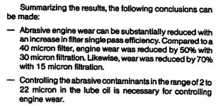

Ask Mr. Google for research documents. Try SAE 881825, "Correlating Lube Oil Filtration Efficiencies with Engine Wear". Been around a long time (1988), and the field has advanced since then. The hot topic these days is diesel fuel filtration. Lube oil is pretty much a settled matter...except around here, apparently.
