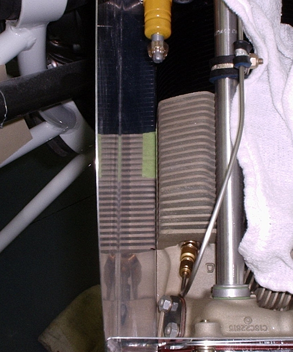

Measure the fin area you want to cover, draw the shape on the plastic, cut with scissors, peel one side, stick into place, peel the other plastic sheet. No additional silicone required, except for a bead here and there to make sure air can't escape between the "gasket" and the tin.
Sticks fine. None has ever moved, even where not trapped between fins and baffle tin. Here you can see it stuck to the front of the cylinder head and the cylinder barrel. The back side of the barrel (between 1 and 3) is wrapped the same way, without support except for a strip at the bottom under the edge of the inter-cylinder baffle.
The 598 is oil resistant. I may have cleaned the fin ends with MEK prior to bond.

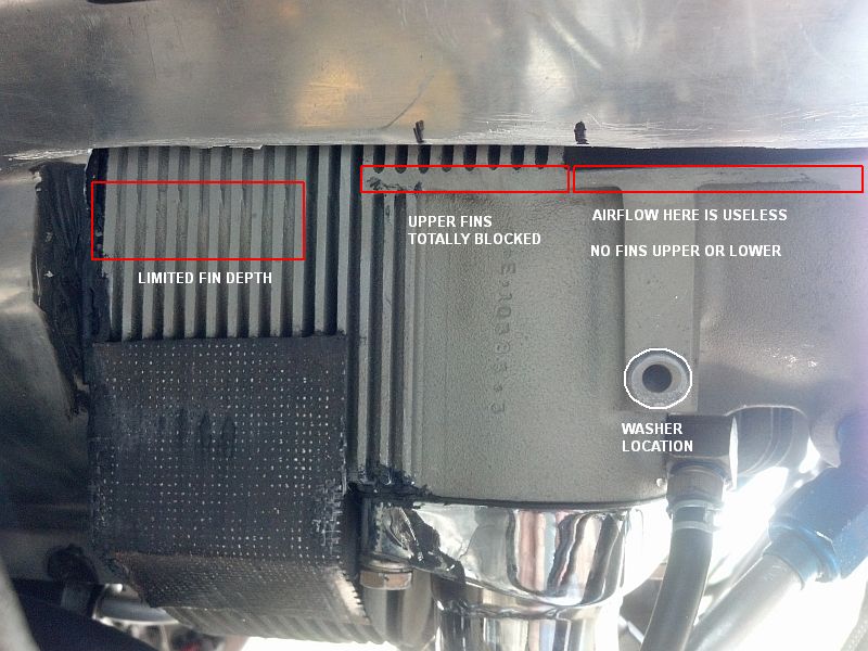

This seems to be the best thread on the subject (ducts versus washers) so I thought I'd post here. I added a "washer" to space the baffles out on #3 this weekend. My "washer" was actually two pieces of 0.040" aluminum that I cut to about 1" wide in one direction and the width of the area that'd normally have to be silicone'd up in the other. I then drilled a hole where the screw goes through. I could have gotten away with no silicone, but ended up sealing it up with a tiny bit since I had it out anyway. That and removing and blocking off my heater air outlet seems to have sorted out my hot #3 issue. Not sure which did more, but I though my solution to the washer versus duct problem worked well (and was easy).
Great Thread indeed! Your improvement was definitely the increased flow area on the head. It would be good to know just how much the temp dropped with your change - it is a good data point.
My #2 and #3 heads are the same. Pictures were posted earlier in the thread. The graph below is the result of measuring the flow areas for the first 8 (IIRC) fin channels from the base of the head. The area on the graph for the centerline is after working with a carbide die grinder to smooth the casting parting flash.
Note the maximum flow area between these same fins under he head. All the cooling is blocked with a tight fitting baffle and no grinder work. Look at the increase in flow area due to a .063" washer and .20" gap. Now, imagine where .040 would be. Better to be sure. If it works then it is good to know how little we really need. Right now I am adding .25" channel on #3 and .2" channel on #2. It is absolutely shocking that there is no "factory" attention to this and I wonder what the real world engine durability effects of loss of cooling due to those fins.
So I saw about a 25 degree drop, but I made several changes. I had 4 taps for blast tubes (mags, fuel pump, alternator) that were all 7/8", which seemed big, so I restricted them down to about 1/2". I also taped a little of the oil cooler off and took the heater muff completely off and blocked off that tap entirely. Who knows what helped more. I'm going to investigate my fuel flow a little as it might be just a touch low for takeoff. I know I have one small leak in the baffle seals where the rubber is kinked so there's a few other little things to fix.

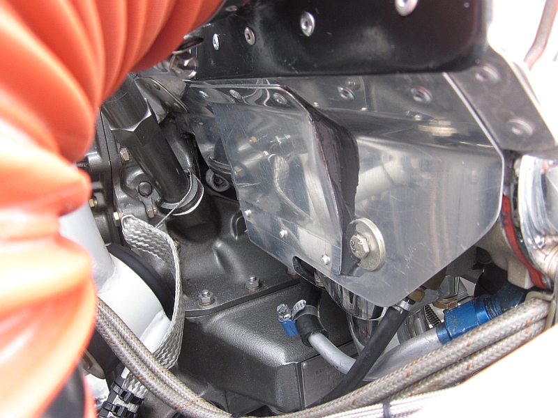

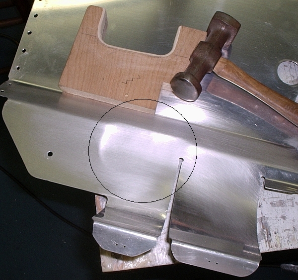

#3 baffle mod

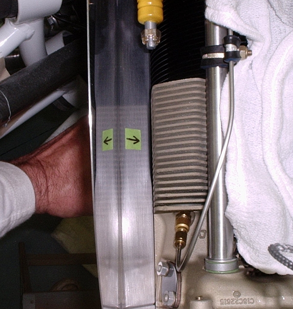

Lycoming cylinders have a classic baffle problem. I don't know if anyone else has taken this particular approach to solving it (lots of ways to skin a cat), but maybe the pictures will help the new guys understand the issue.
Here's the root of the problem. The intake side of the head has no fin depth in the area indicated by the pencil. but standard baffles for the left front and right rear cylinders place a plate directly against this area. There is plenty of air at "A", but there is no way for air to circulate down to area "B"
Details:
Here's the standard baffle (right rear) against the head. Flow to the lower fins and baffle wrap is blocked by the zero-depth fin area identified by the green tape. The standard "cure" is to place a washer or some other spacer between the head and the baffle, but that opens a gap along the entire length of the baffle plate.....in particular the area outlined in a black rectangle above. Any air sneaking past the area in the rectangle is pure leakage.
It is quite easy to hammerform a small duct of sorts in the baffle plate. The "duct" is nothing more than a fancy dent knocked in the sheet.
The result is a passage to bypass the no-depth fin area (arrow). Now air can flow down the back of the head and pass in between the lower fins where you have a baffle wrap. The reminder of the baffle plate is not spaced away from the head and cylinder, reducing undesired leakage. Any air not passing between fins is pure drag; it didn't do any cooling work.
Not all builders have metal forming hammers, or may not want to try beating on an expensive baffle part as their first metal forming experience. I'll do the left front baffle using an alternate method and get it up here soon.
Have fun.
----->>>>POSTSCRIPT: See posts 24 and 25
So did this work well? If the dent in the baffle is made too large will that lower the pressure on upper side of engine and make all air flow worse?
Pretty well, but I tend to experiment. I enlarged the bypass for #3 and got some further reduction. This photo was taken while making that mod; I've cut away the hammered duct:
A larger bypass was riveted on:
No. The throttle is the lower fin wrap, just like the other cylinders.

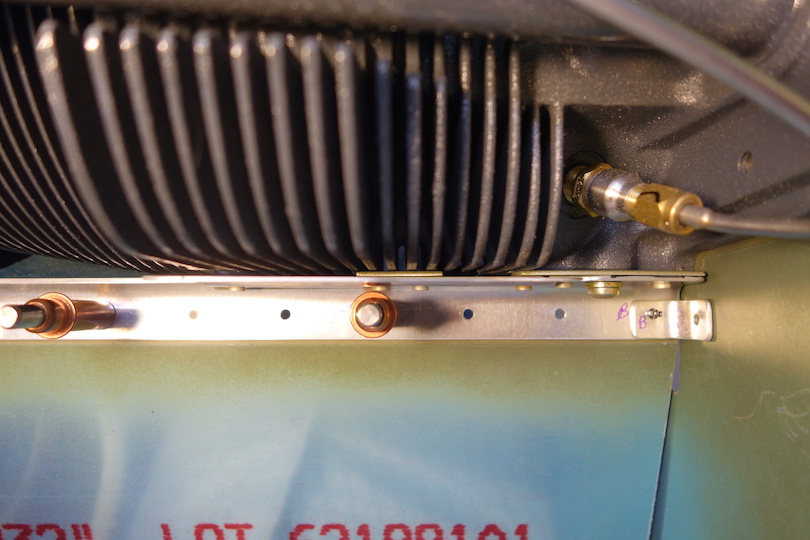

When I had my baffles off for some other work recently I came across this thread. I made the suggested modifications to my #2 and 3 baffles (using the riveted on bypass method), and also modified (lowered) the dam in front of #1, and came away with 15-20 degree cooler CHTs on those cylinders. Which might have been expected given the comments on the thread but still I was surprised that such a simple mod could make such a big difference. Thanks Dan and the VAF community!

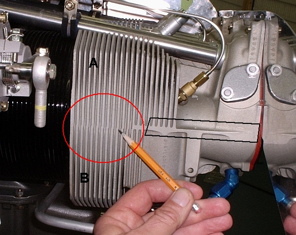

Mine is an IO-360-M1B. Exactly like this one. Photo.
Notice the area in red. That's basically where the cut out will land. I can't get the cut out hole exactly over the problem area without busting edge distances.
I started the relief area. Notice the pointer. That corresponds to the spot on the cylinder where fins are flat. I haven't cut the hole yet but I don't see how I can get much closer without busting edge distances. Shim is .063" and chamfered to fit flush into the bend. Cover plate bend is designed to fit flush and close any leaks.
I don't see any way to get closer to the flat area. Any ideas?
Dave
