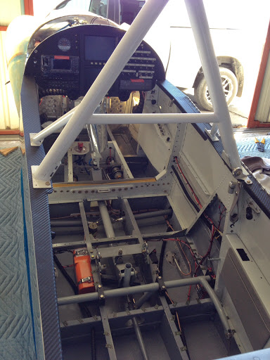

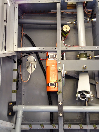

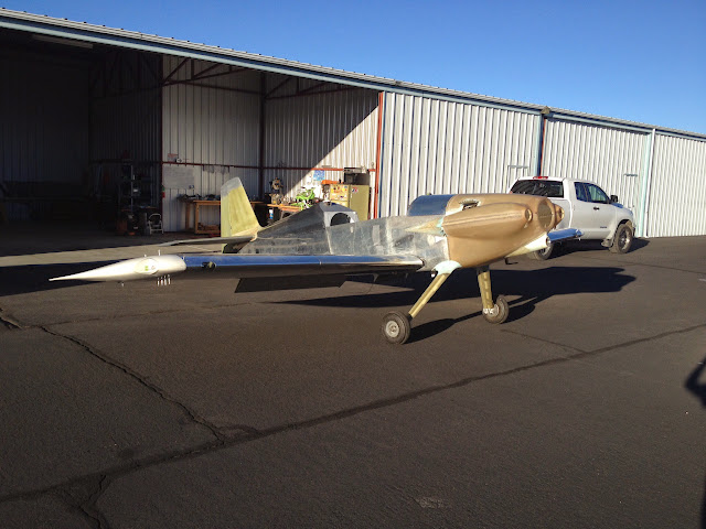

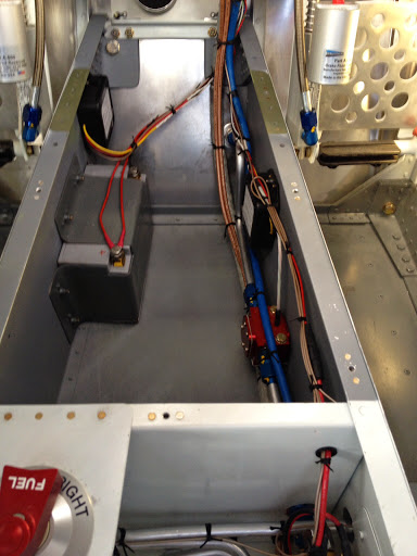

Few pics of the plane. The "to-do" list is getting small :D
And "no" the com wires do not interfere with the controls.

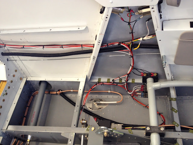

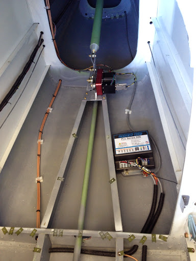

Still cleaning up the wiring:
Nice job on the wiring
Thanks for the post on the wiring. I am fast approaching this part of the build and as always really enjoy seeing what others have done already.
No pictures, not even a description of work however, a little white envelope left my house today. It is heading to the FAA registration office :D omg this thing may actually fly!
What are the 2 boxes near the battery and the box forward of the pitch servo? Fantastic job. Thank you for posting. I'm still mulling over making mine a fastback.

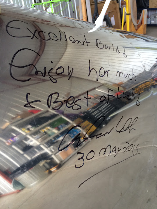

Then he proceeded to graffiti my plane with a sharpie.

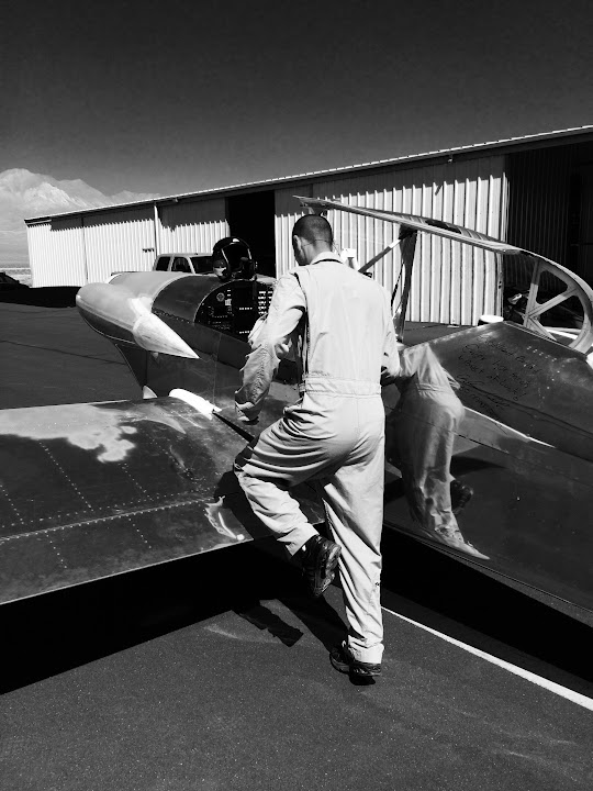

time to go
