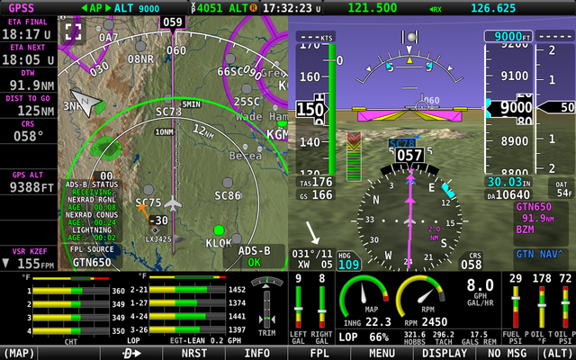

Originally Posted by Carl Froehlich View Post
Standard “I want to get there but not blow too much gas” cruise.
IO-360-M1B with AFP FM-150C, standard 74” Hartzell BA prop.
Carl
Carl, perfect! Provides a very close cruise comparison with an early 210 HP 390; same prop, both 66% power and ~0.4 BSFC (0.404 vs 0.398).
The math to predict speed based on the 390's extra HP is...
180 x .66 = 118.8
210 x .66 = 138.6
176 knots x ( 138.6 / 118.8 )^1/3 = 185 knots
...and here I'm showing 187 with Ms Patti on board and a bit more gas. The addition is in the scatter, or reflects less drag due to the fastback and a closed cooling outlet, depending on viewpoint.

Default Manifold Pressure
Carl,
What air inlet system are you running to get 22.3" at 9000'? Ram air of some sort, or the cowl inlet intake with a snorkle? I'm curious.
I know Dan has a pretty well documented filtered ram air system (nicely designed and tested), and you seem to be matching (or beating) his MP.
My poor O-360/carburetored RV-6 can't get anywhere neat that pressure that high.
Laird

Originally Posted by Laird View Post
Carl,
I know Dan has a pretty well documented filtered ram air system (nicely designed and tested), and you seem to be matching his MP.
Laird
This is the stock snorkel but using the AFP FM-150C. At some point I’ll modify the snorkel following the lead of what was done on the RV-14 with the shift over to the IO-390-EXP119. They got a nice bump in MP from this mod. I’m using the FM-150C and not the FM-200 like the EXP-119 uses so I suspect I’ll not get as much gain.
For vertical intake I enjoyed good MP on my old RV-10. I had a straight in shot from the engine air intake on the James Cowl, but modified the filtered air box to accept the taller K&N E-1000 filter. The mod was simply to flip the FAB top over to have the edge go over the sides of the fiberglass. This provided the extra height for the taller filter.
The new RV-10 project will have cold air sump horizontal injection and I’ll be using a new filter box that Jimmy at James Cowl is working on.
Carl
  #38
Old 10-05-2022, 08:50 PM
DanH's Avatar
DanH DanH is offline
Location: 08A
Posts: 11,223
Carl, might want to check that MP indication.
Run the numbers. At 9000 ft, 176 KTAS, and 54 OAT, pressure is 21.39" Hg and available dynamic pressure (q) is 1.07 Hg.
Can't get 100% conversion of dynamic pressure in an open-ended system. The ballpark is more like 75%, thus q applied to increasing MP would be roughly 0.8" Hg, not the full 1.07".
Next consider manifold pressure loss due to flow through filter, fiberglass snorkel, the FM150, and the intake tract between the throttle and the cylinder head. How much is the loss? My airbox has a larger filter, no duct, and no entry bend. The smaller throat of the FM150 results in 6" H2O more loss than an FM200. The M1B and the 390 have the same horizontal intake sump. Having measured my total intake loss at three altitudes, I'd estimate your 9000 ft loss at about 15" H20, a bit more than 1" Hg.
So, 21.4 + 0.8, less 1 = 21.2", more or less. 22.3 is unlikely.
Dan Horton
RV-8 SS
Barrett IO-390

Awhile back Dan saw that my MAP was also reading high. I did the ground calibration (several times on different days) and adjusted it in the Dynon menu:
Ended up adjusting it down by 0.5" Hg:
Below is a screenshot from my RV-8 with the Lycoming YIO-360-M1B, Avstar FI, LSE Plasma III & Slick mag, and Hartzell 72" BA prop. Note that the IAS reads about 4 MPH high, so this is about 200 MPH TAS/173.8 KTAS. Similar conditions as Carl's above, and similar performance.
