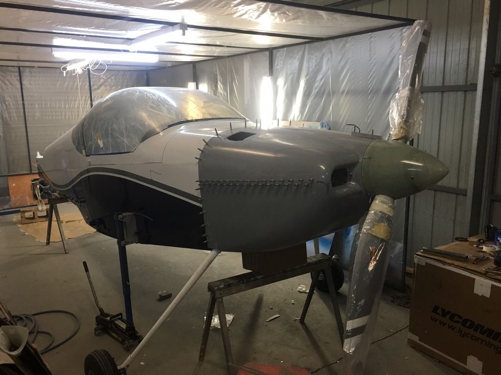

Finishing fitting the cowl and wheel pants.
